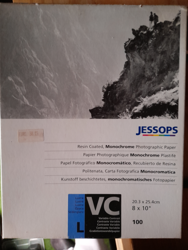

I haven't bought the paper developer yet cause I didn't know what to buy. A friend gave me a very old stock of paper he bought like 15 years ago. I'll leave a pic of the box here. I just don't know what developer to buy for this paper stock
And how do I know how much chemistry should I dilute? Cause I have adofix for example, and for paper it says 1+19 (i guess) - should I dilute the 1000ml i have with 1+19, or dilute it depending on how much water i'll need for the size of the tray?

Dilute it with amount of water you need for the tray. One liter is convenient if you are using small trays for 8x10 paper. 1+ 19 would be 50 ml plus 950 ml. Ilford Multigrade developer and Ilford stop bath should be available in Portugal, I would think and is very convenient but the adofix should be fine if its not too old. Your gifted paper might be fine but you'd be better off to start with fresh paper to reduce the number of variables.

That box of papers......if you don't know how it's been stored, those papers could cause you more problems than they're worth if they've gotten fogged. I would suggest starting out w/ a brand new box. Youtube has lots of good film and paper developing videos you can learn a lot from, and this link below will help as well.
https://www.darkroomdave.com/tutorial/making-your-first-black-and-white-print/
