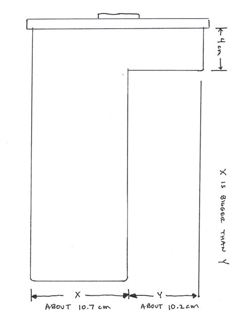

No -- just keeping track of what one is doing. I have attached the design I use. Works perfectly. I did the same for 11x14, but found that it is not as easy, especially with the many brands of 11x14 holders I have.
I usually expose the same 4x10 image on both halves rather than trying to remember which half was exposed if I want to use the other half later.

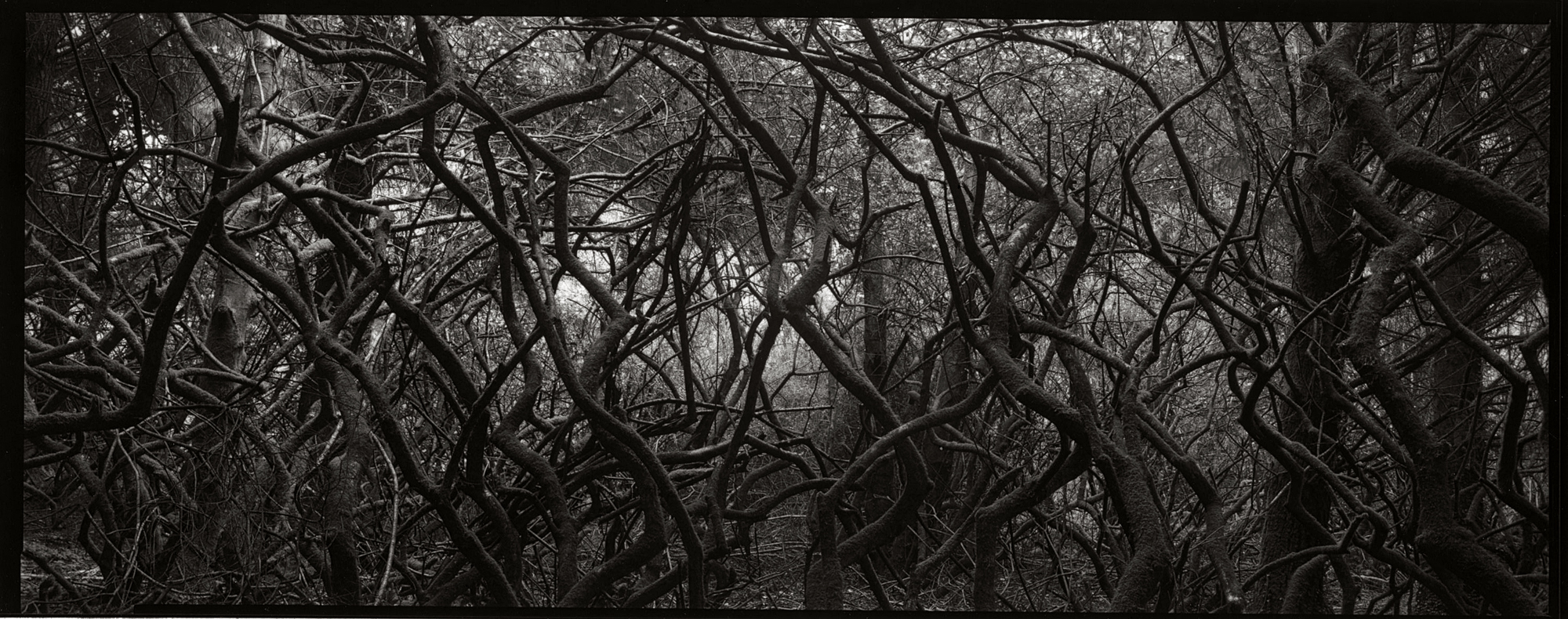

A 4x10 carbon print using a modified darkslide. Because of the length of the exposure, I only took one image -- and decided to develop it ASAP rather than risk it.
Trinidad State Beach, CA

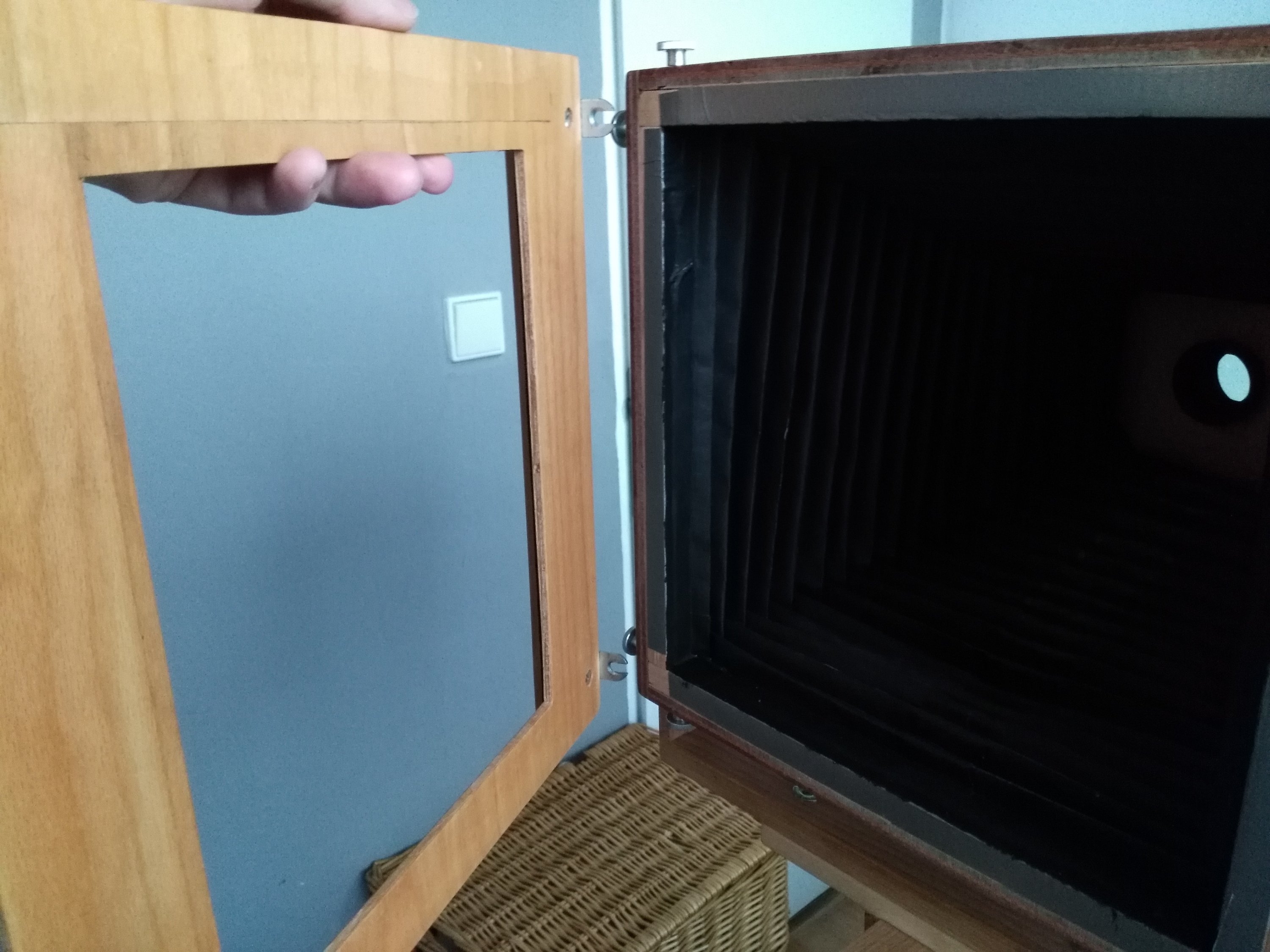

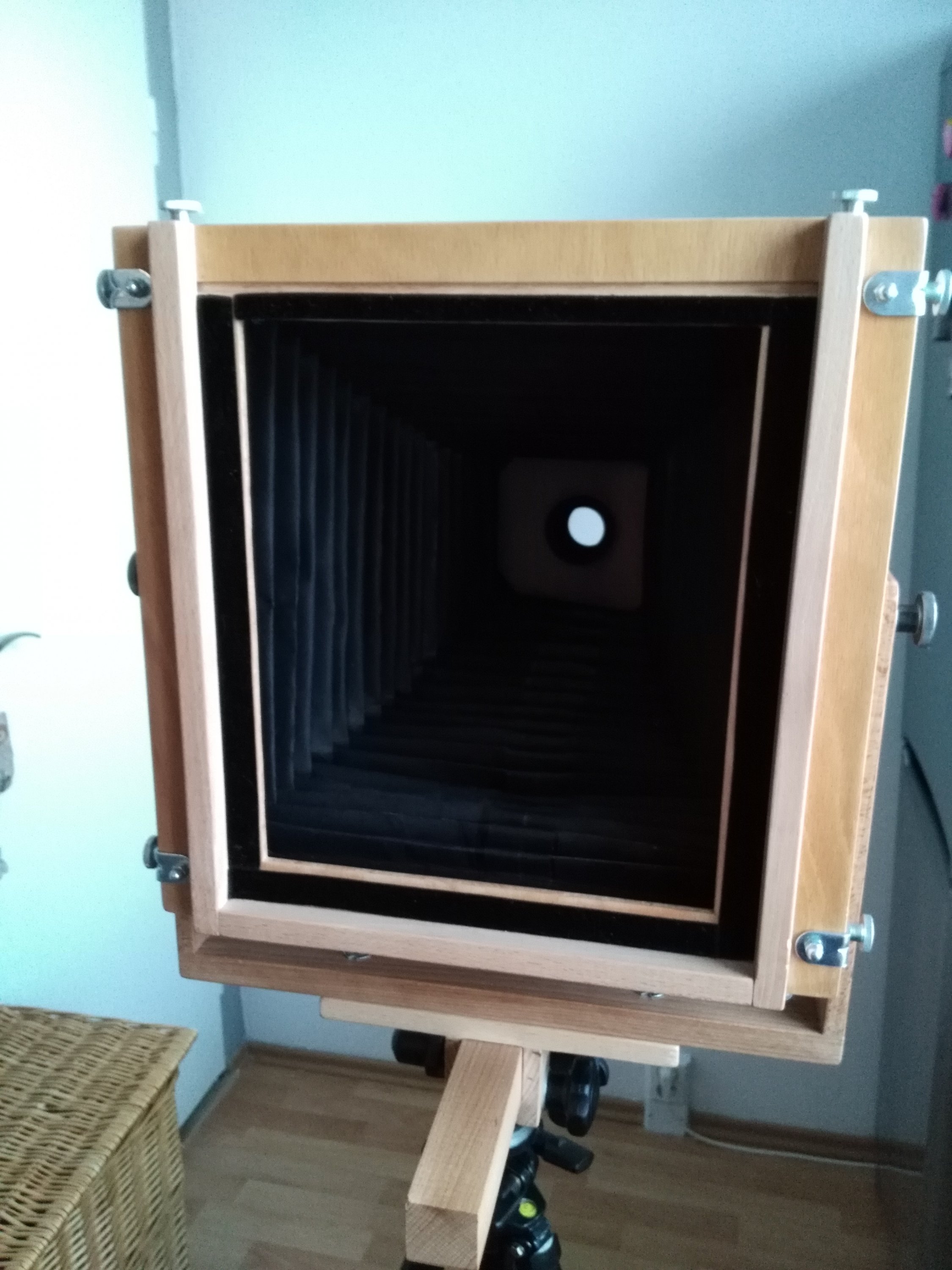

Vaughn: DIY solution "in camera" is interesting. Here are photos of the camera. Maybe some mask from hard black paper or thin plastic and squeeze it between rear standard and "rotary" back?

When I shot a lot of E6 catalog product, I had a trick to save $$ on some jewelry and other stuff that worked; I cut a black piece of black cardboard to about 6", and bent each side in at about 1", for a 4" piece with two 1-inch "legs" - I pushed that into the rear standard on the bellows side, it just held in place by friction. This would mask 1/2 of the film area; I'd setup and frame the shot, pull the dark slide and expose; then I'd stick the dark slide back in and rotate the back 180°, pull the slide and expose again with the next bracket. I'd get two shots on on one sheet of 4x5, each shot being about 4" x 2.5". Something like that may work for you; it's a solution that also masks the ground glass so no guessing on framing.

That sounds great. I prefer solutions like this rather than cutting darkslide :smile:
... Something like that may work for you; it's a solution that also masks the ground glass so no guessing on framing.

I have a sheet of plywood that just fits between the back and the bellows on my Intrepid 8x10. That gives me 4x10, or with a bit of thought, 8x5, 2-up on a sheet. It does require that you keep a diagram with the holder to track what you did, or chaos ensues! I normally leave the panel at the bottom of the opening, and switch the back to left opening instead of right opening for the second exposure (or top and bottom for 8x5).
The downside of this approach is having to take the back off to make format changes. The upside is a 6mm plywood sheet is more robust than a cut-down masking slide. And I can do the 8x5.
