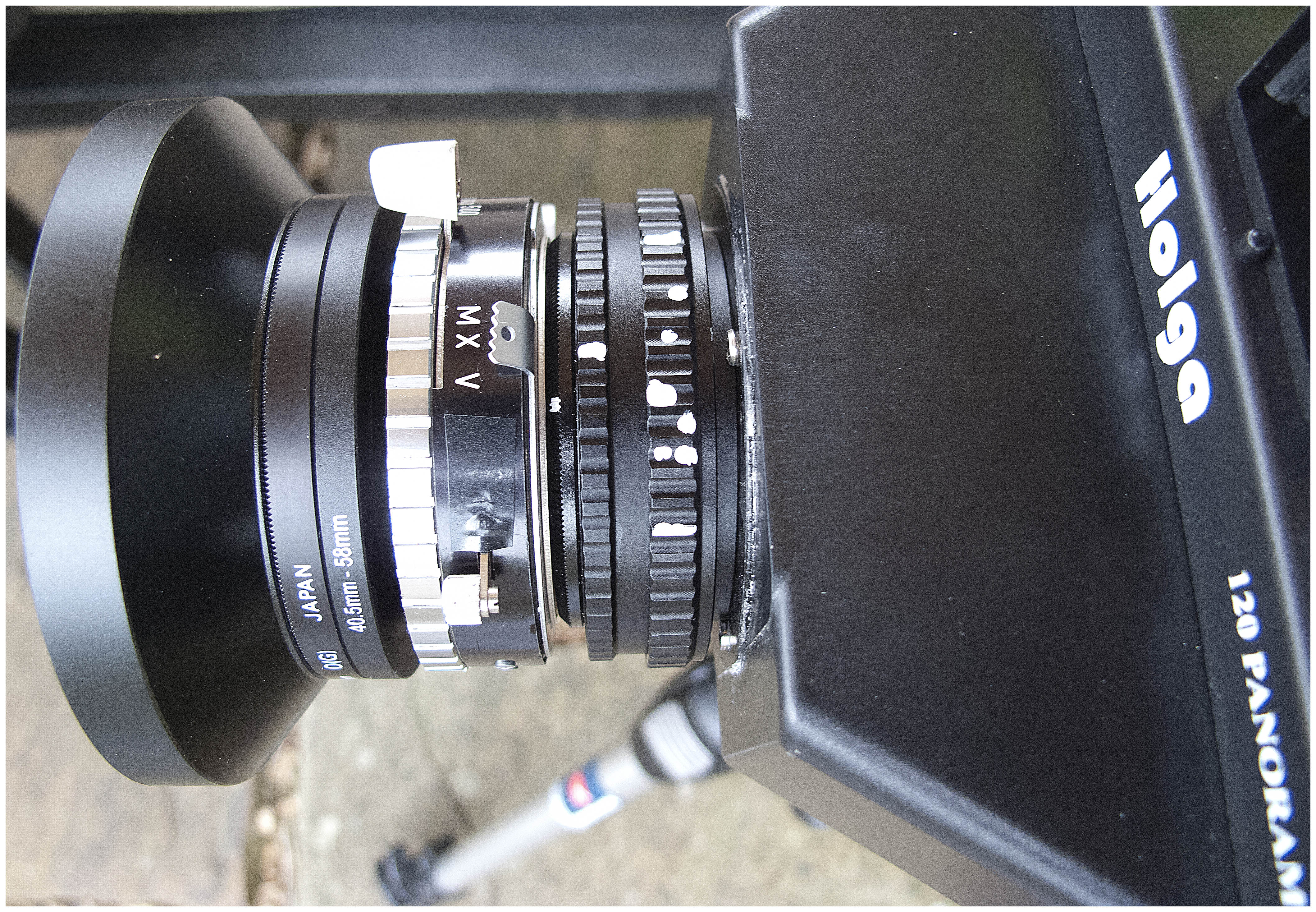

Can you use a few hand tools? Can you get on eBay?
If you can then you can build yourself a "HolgAgon".
Here's how I built mine...
http://freepdfhosting.com/b316cbe2ff.pdf
It is easy to do. Mine cost £167 for everything including the lens.
You can see some pictures made with a HolgAgon here: https://www.flickr.com/search/?w=23468852@N02&q=HolgAgon
richard
