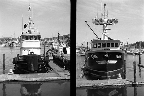

I recently found a bulk loader at an estate sale that still has a partial roll of Panatomic-X. I have no idea when this film expired so I did a test strip where I metered several identical shots from 32 down to 12 ISO. I decided to meter mine at 25 ISO based on the test. I don’t know how it was stored over the years but slow film ages much better than fast film. Panatomic-X was discontinued in 1987 so it’s over 30 years old.
The shot below was metered at ISO 25 and developed in Rodinal 1:50 for 13 minutes. The camera was a Mercury II so I’m not 100% sure the shutter speeds are spot on but they seem pretty good.
