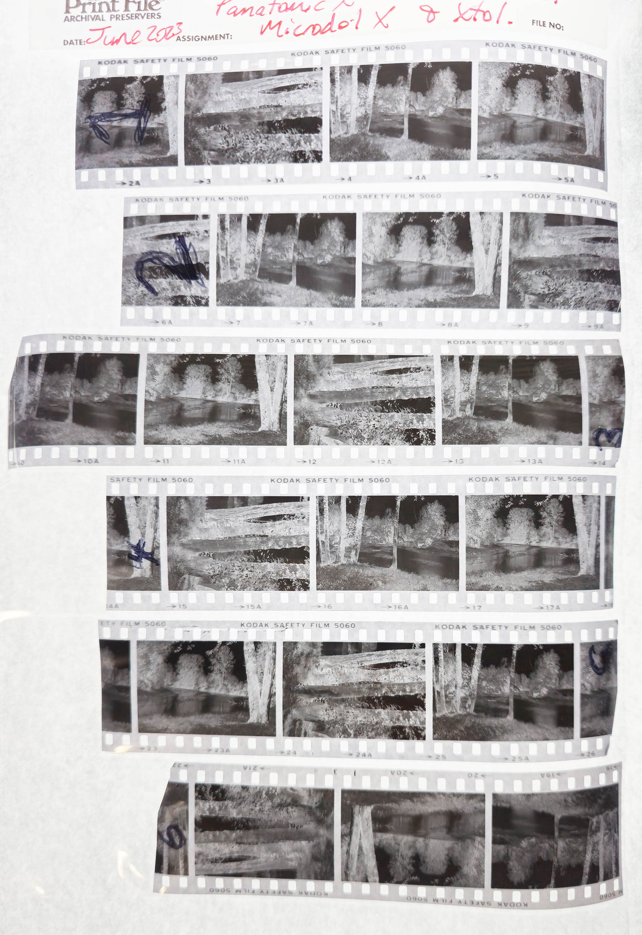

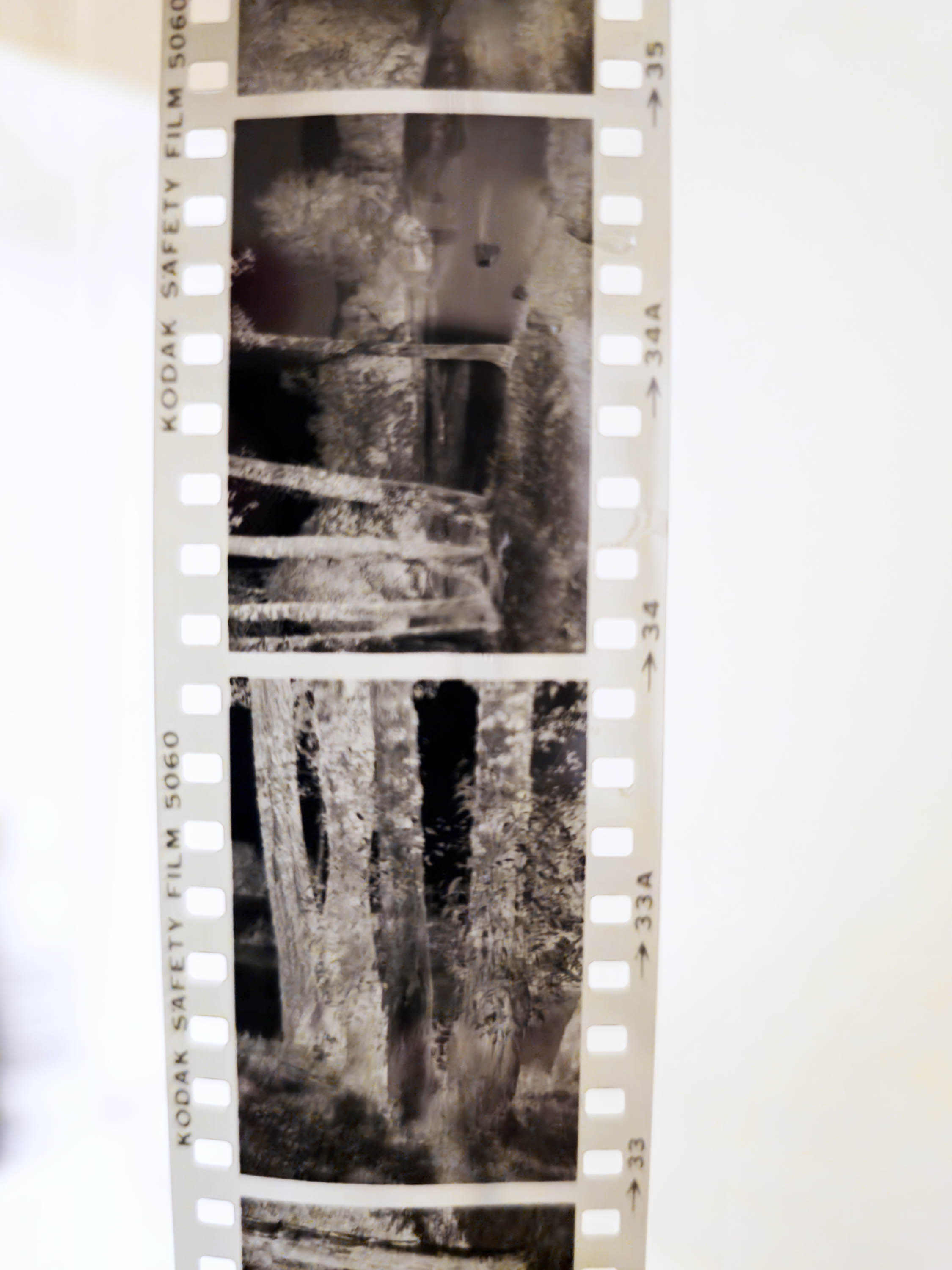

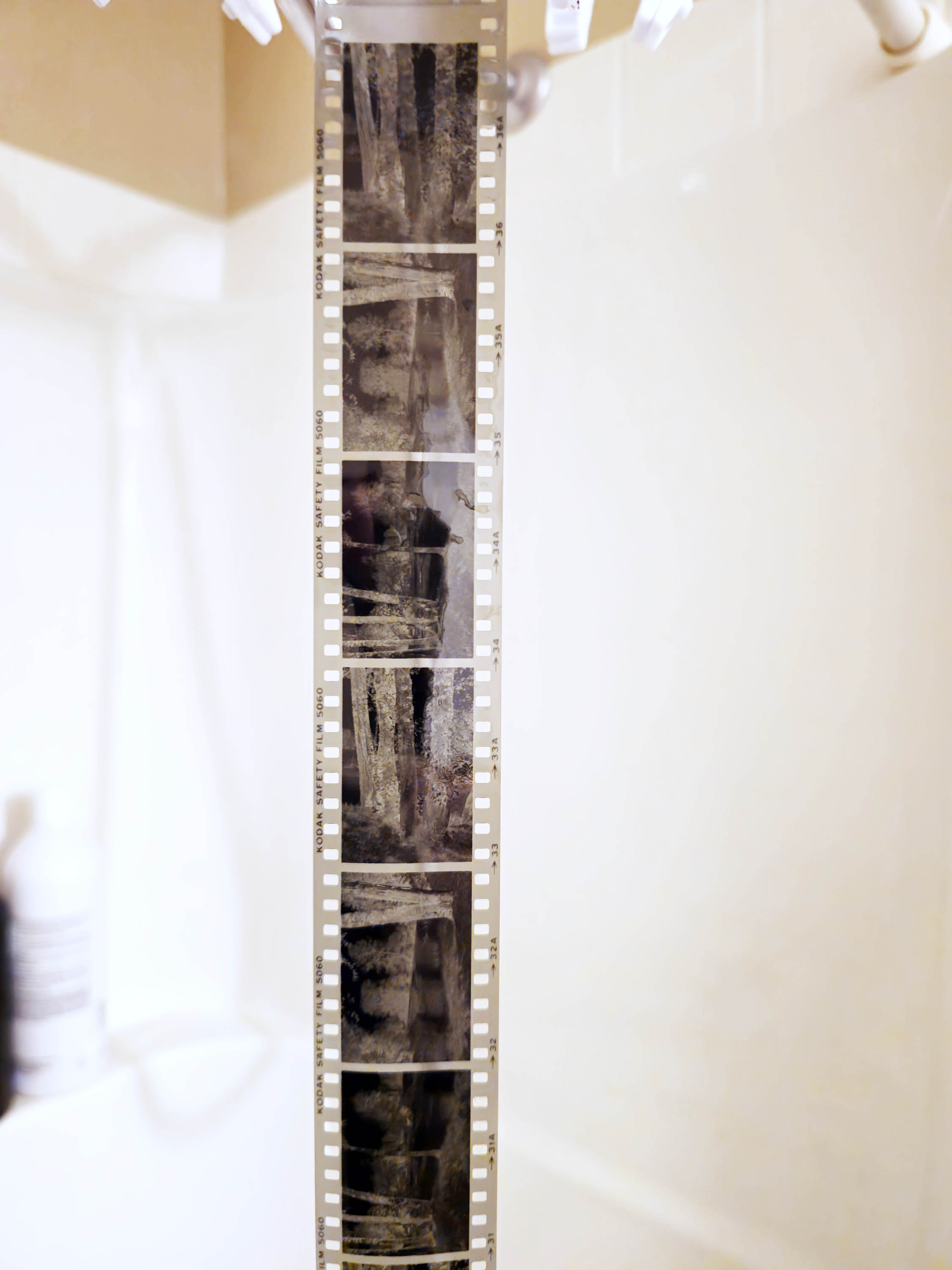

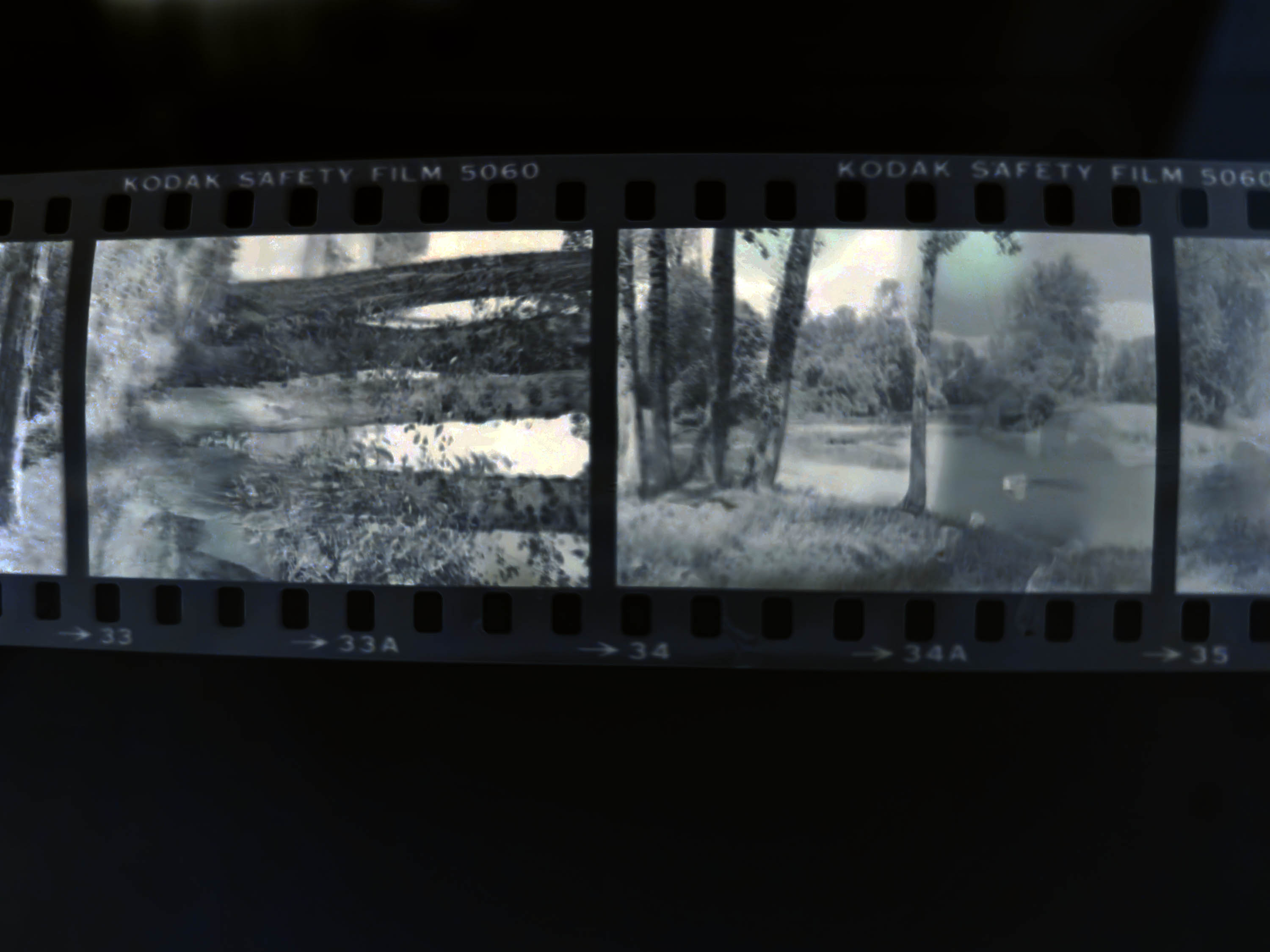

Well all 7 strips are done. And Holy Cow- even the swamp water mix of both developers in one solution worked. Well at least it gave an image. It looks a little more contrasty, but that could be from overdevelopment as well. I'll scan these up tomorrow and see the results. My video will follow after that. The first pics below are from strip 7, the swamp water one. I do notice the emulsion side looks a little more dull in appearance, almost as if its not as smooth or a bit rough. I'll see how it is when the strip is dry. Checking the other strips, the Xtol only or the Microdol X only, seems slightly more smooth, but not by much. Only the mixed developer ones are ever so slightly more dull or less shiny on the emulsion side. The last pic is of strips 1-6 which were specific developers. Looking at it now, they all look contrasty. Because of the heat inside here, they were probably slightly over developed on all of them. It was hovering between 27 to 28 degrees C inside here. The mixed developer ones look a bit more contrasty to me. Its probably a bit harder to figure out correct times when it comes to mixing developers.
Here is the list of strip combos:
Strip 1: Microdol X straight
Strip 2: Xtol Straight
Strip 3: Microdol X 1:3
Strip 4: Xtol 1:1
Strip 5: Microdol X 1:1 first for half time, dumped, then Xtol 1:1 second half
Strip 6: Xtol 1:1 first for half time, dumped, then Microdol X 1:3 second half
Strip 7 Xtol 1:1 and Microdol X 1:3 (half and half swamp water mix) mixed together into one solution (Developing time based on half time of each solution and then added together for needed time)

The best I could do, since I don't have a densitometer or anything really technical, is to just scan the images and look at the results at 100 percent zoom. I won't adjust any settings on the scan, so the images shouldn't change much. But where they do, like higher contrast, I'll hopefully see a difference. I have no way of making a chemical print here, though I know others that can. But they live far away.
I'm hoping to see if Microdol X still gives finer grain then even Xtol, which is also a very fine grain developer. Or to see if I notice any other differences. Again Microdol X was Panatomic Xs recommended developer, but Xtol seems to do everything the best already, so I'm curious how they'll compare.
