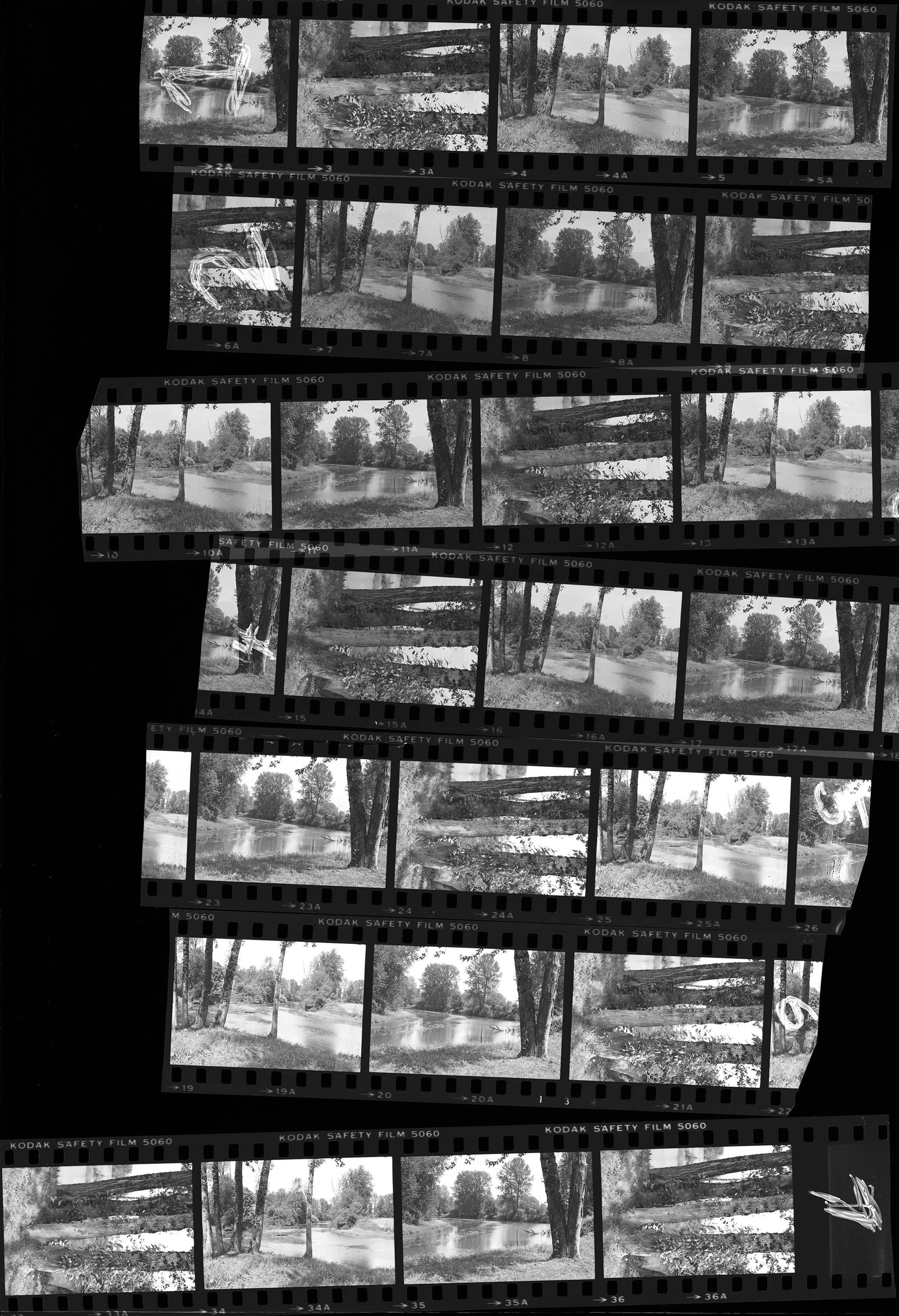

I managed to make a 8x10 scan of the negs as a contact sheet. Its not the best managed file, but from what I could see, the negs with the mixed developers are showing more contrast and a brighter image. This also shows visually in the negs with more dense sky, etc.

koraks
Nov 29, 2018
26,807
Europe
Yeah, that's a nice comparison. So this shows that the activity of your mixture of developers is higher than that of the individual developers by themselves. From here, you could choose to re-do a test while adjusting the development time or dilution of the mixtures to bring the results closer in line with the individual developers. At that point, a direct comparison becomes possible. Alternatively, you could leave it at this and for instance decide you like the added 'punch' of the mixture and stick with that.

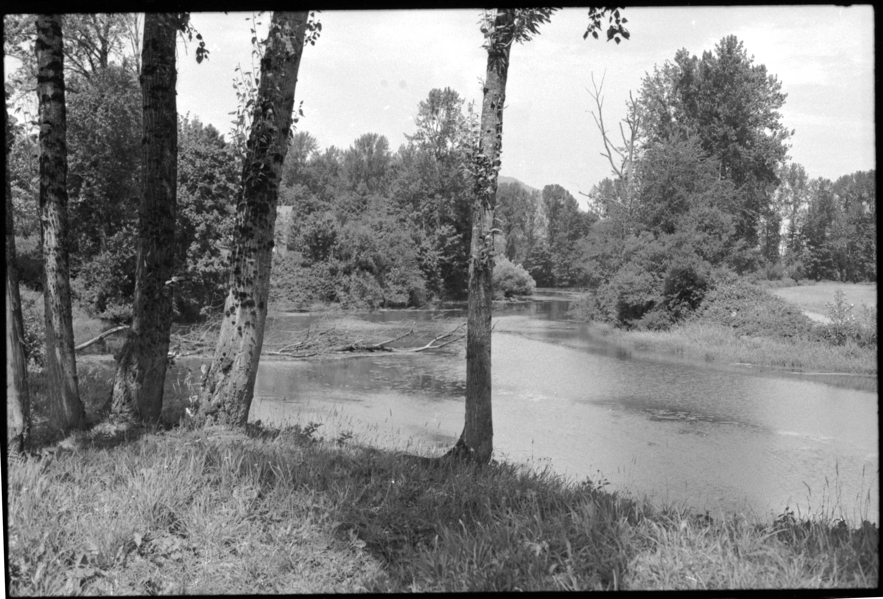

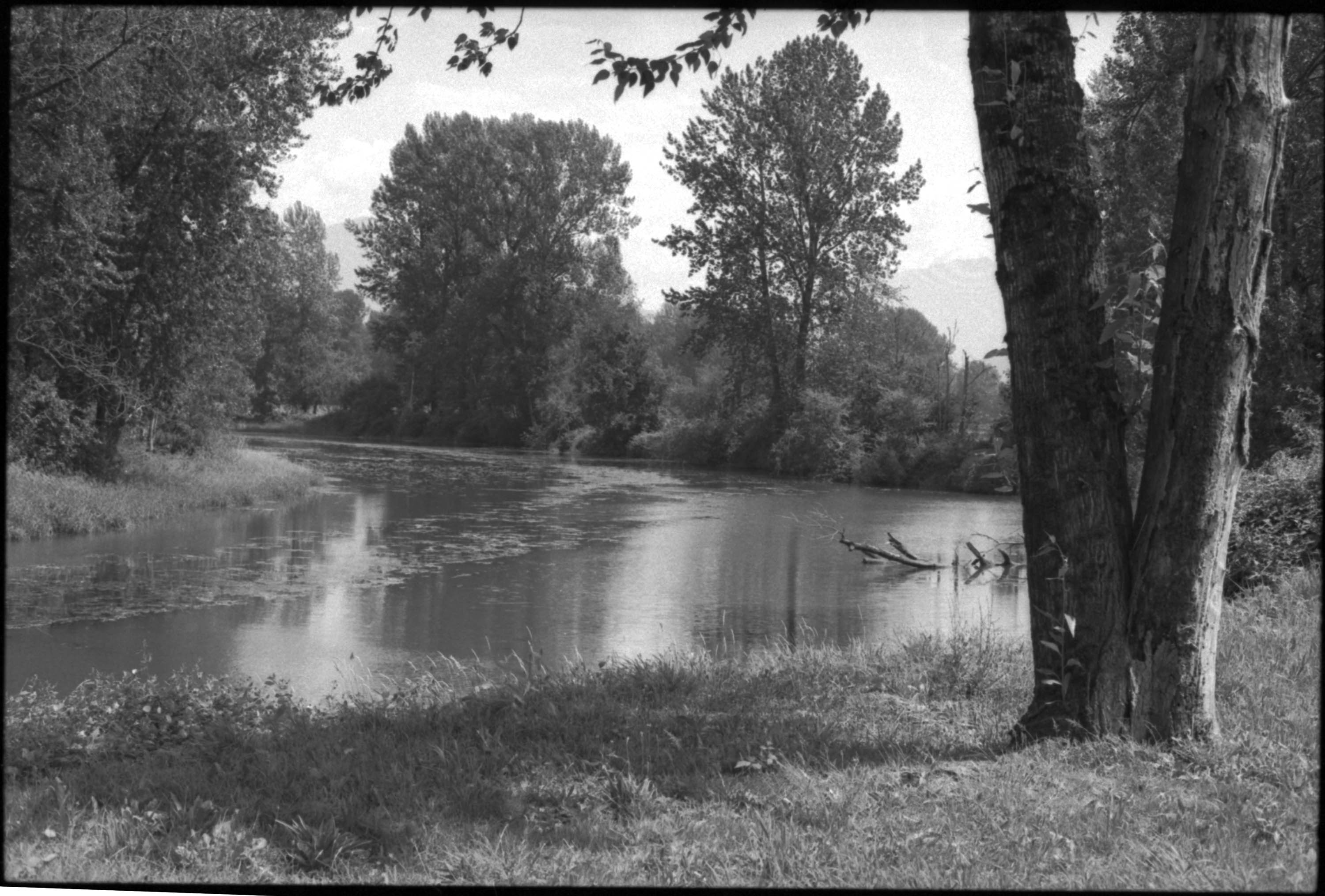

Below are two rough scans on the flatbed. I had to auto levels and change contrast a bit, but I was curious if I could get the images to look better. I'll do these all on my other scanner now. First one is Mic X on its own, and second is the swamp water one.
