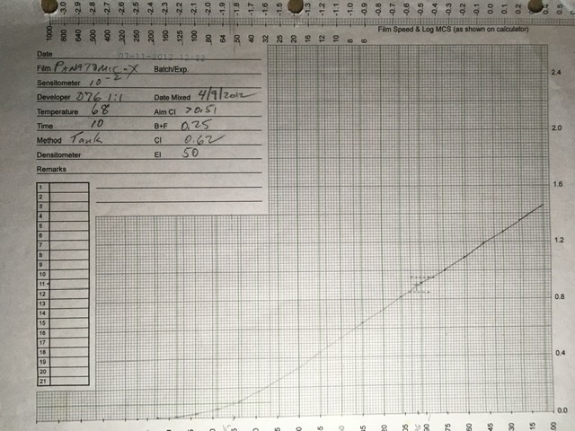

This is why I say 9 to 10 minutes in D-76 1:1
The results at 10 minutes are ASA parameters. Every time I test this film I get full film speed, maybe a slight increase in speed.

Panatomic-X is the exception to this rule. It has negligible fog (I test and use it) and always tested at higher than it’s rated speeds (you can refer to some old Fred Picker articles).
Even its graininess (close to TMAX-100) is comparable today with what I got 40 years ago.
