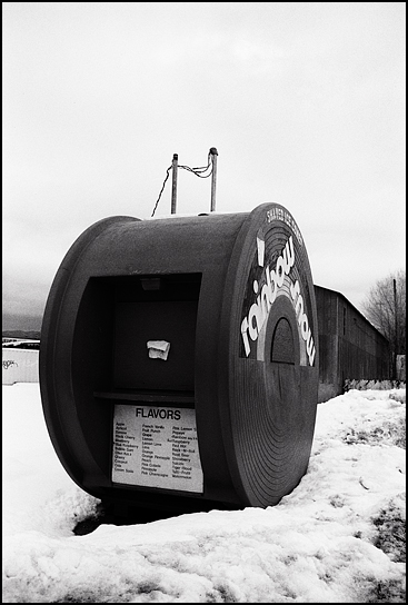

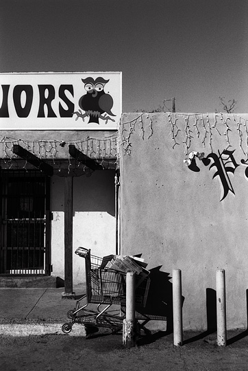

These were both shot on 35mm Pan-F, developed in Rodinal. The second one, because of the very high-contrast light, was shot at EI-25 and developed for 7.5 minutes at 68 degrees (20C). In Zone System terms, this is N-1 developing, to reduce contrast.
The first one was shot at EI-50 and developed for the normal time.
