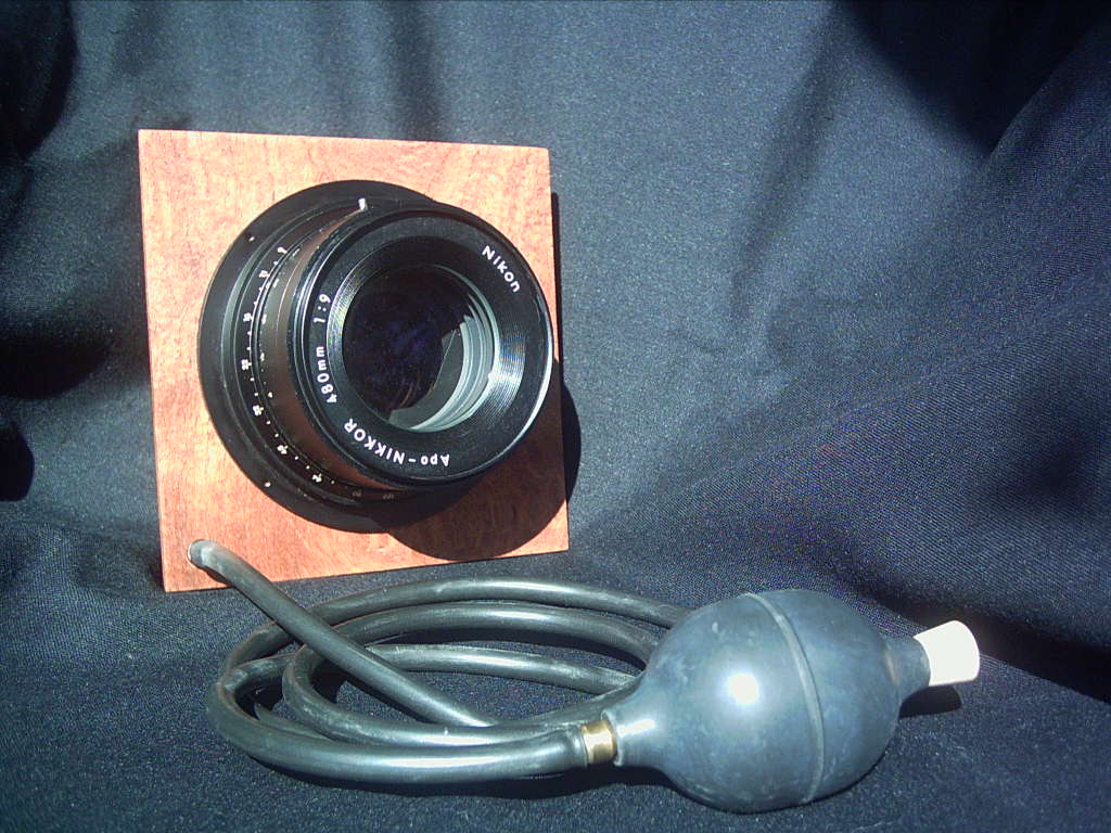

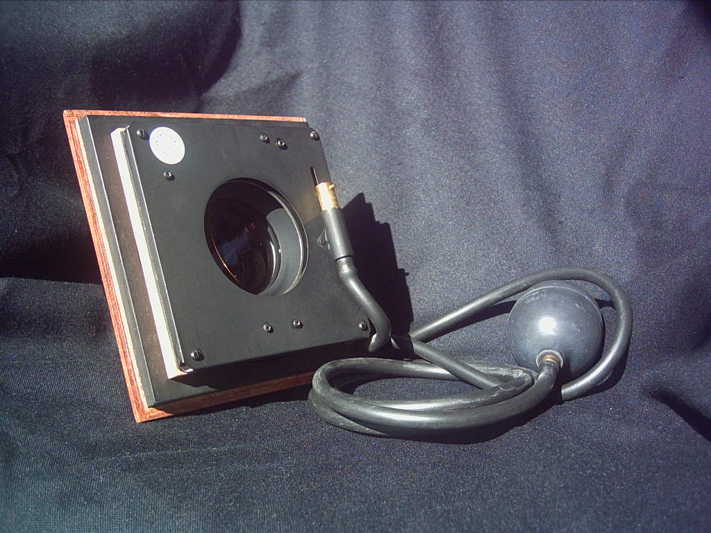

Another Packard
Jim, here are a couple of pictures of a similar setup for my 8x10 B&J. Also addes as a bonus, the lens shade I made to cut some of the light from the Nikkor 480mm lens. Best, tim

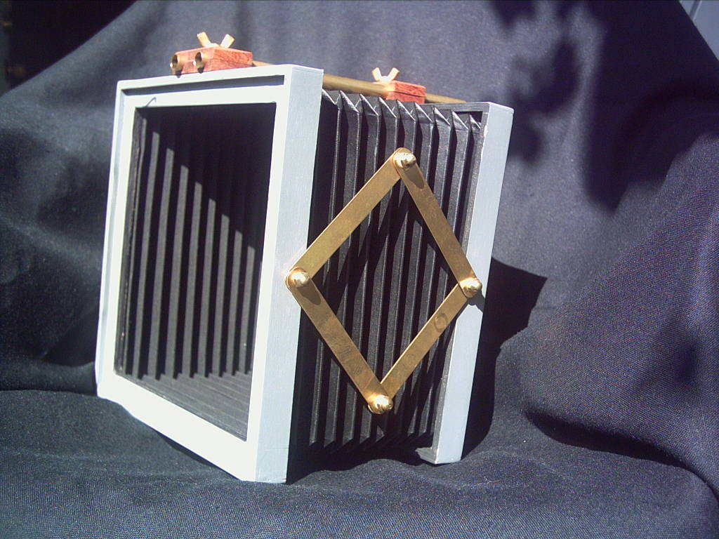

I posted pics of my Packard box design last year in this thread: (there was a url link here which no longer exists)
I've since altered it to fit into a Kodak 8x10 2D. I also made several more front boards to my design so each lens has it's own board. One Packard shutter and 6 old barrel lenses...That should keep me busy for a while.

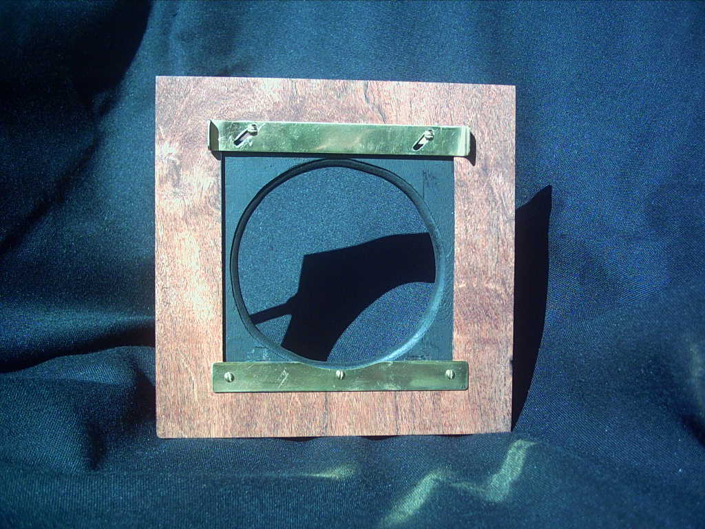

4x5 to 810 board
Forgot to add this one. Uses the normal Toyo lens board from a 4x5 and fits it into the 8x10. tim

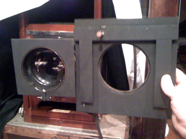

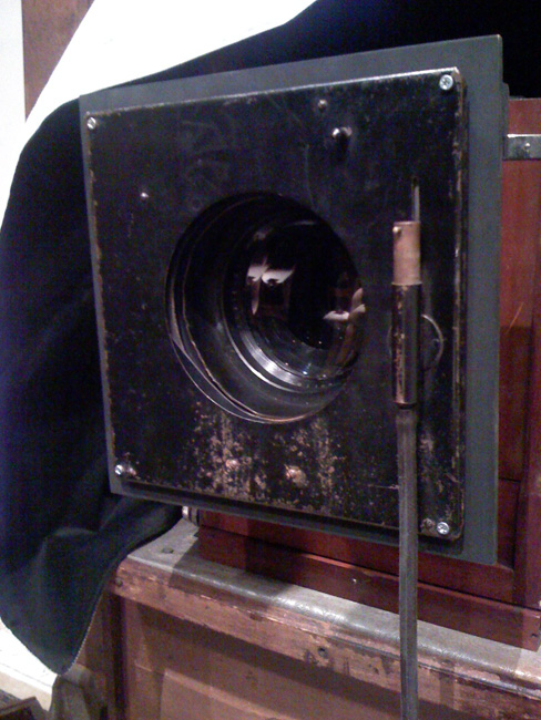

My front mount assembly
I've got a rig that allows me to interchange the front-mount Packard between multiple lenses, I just need to cut an appropriate size front flange to slide into the slot on the back of the Packard shutter mount. This shows it mounted on the 11x14 Bausch & Lomb f4.5 Tessar on the Gundlach Wizard 11x14.

Scott, this looks like a very easy way to use the Packard. I like the fact that you can use it on different lenses. It eliminates the need to build a box. The ideas that everyone has for using their Packards are great. Thanks for the pictures. This give me some more ideas.

The front-mount method works well for cameras where you need a larger size shutter than the front standard will fit inside the bellows. I've got three or four lenses now that need a 4" or larger diameter opening in the shutter. That means an 8" sq. or more Packard shutter. Only one studio camera of mine will take that big a shutter. Mounting this way lets me use those monster lenses on cameras with smaller lensboards.
