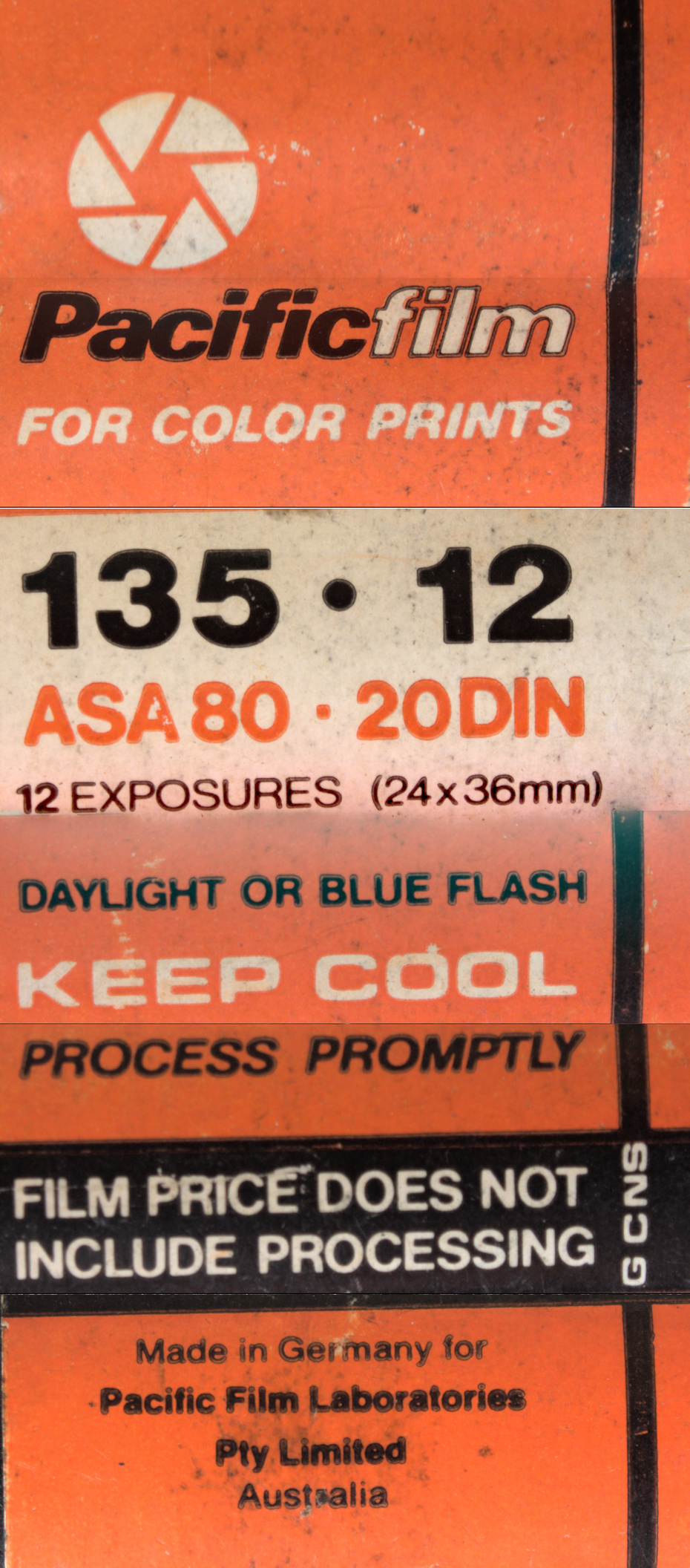

I was given a "mystery" roll of Pacific Film film and processed in C-41 chemistry. This was a mistake. The emulsion was destroyed and peeled off as ugly brownish sludge. The chemistry is fine, I developed another roll after this and the negative came out fine.
Pacific Film was an Australian company based in Sydney. Among other things they sold German and Japanese films under their name. The label says "Made in Germany" and the spool looks identical to older Agfa ones.
Can anyone shed some light on this film stock? If this is not C-41 what process could this be? And what are the options of processing this film now?

From looking at the images you posted of the label, "made in Germany" would suggest Agfa, and ASA 80 would suggest Agfa CNS film.
Agfa CNS was completely different (and now obsolete process) from the Kodak based C41 or C22. The hotter C41 process at 38C will melt the Agfa CNS emulsion as you found out.
There are some people who process this type of film in C41 BUT at 20C and extended times.
Here are some suggestions about it.
http://www.florisdox.com/expired-agfacolor-cns-c41/
https://www.flickr.com/groups/998890@N20/discuss/72157656808149052/
http://classicameras.blogspot.com/2010/08/agfacolor-cns.htmlhttp://classicameras.blogspot.com/2010/08/agfacolor-cns.html
In case of doubt ask here before. That CNS designation already would have given you a hint at googling.
However, "Processing not included" on the other hand just indicates a generic process. By including processing in the price, by the respective voucher, a film manufactuer could be sure that film lands again in a lab controlled by him. And also bringing him back the employed silver... Of course by this it was guaranteed that the film ended in the apt processs

Not to mention that the film is very old, wrong process and who knows what time has done to the emulsion.

B - Color saturation is really amazing, I didn't measure density I don't have the tools to do so, but I speak based on my inner sense.
C- This solution helps a lot in developing expired films in a very quiet manner. As the expired and worn-out film, it basically needs tender treatment, and this is what this solution gives it. It extracts everything inside this emulsion from silver halides in a calm and wonderful way. You can do it yourself, get a fully weaponized roll and shoot it on one scene, and develop half of this roll with standard C41 formula and the other half with CNs formula, you will be surprised with the results,, trust me
Conclusion: I think, according to my point of view, which has no value. That the creativity of German scientists was strongly evident in the invention of the formula (CNs), they invented that formula with the mentality of scientists who love photography and not with the mentality of merchants and businessmen who seek financial profit.
Yes, that formula was later modified to comply with temperatures of 38 degrees Celsius to be compatible with the development machines of Kodak and Noritsu, and these are purely commercial goals. Agfa was in need of financial profit in a period of time, and I do not blame them.
mohmad khatab
Sep 8, 2012
1,228
Egypt
Mohmad, thanks for your comments and suggestions. I am new to colour photography. What book are your referring too? I could not find any photography books by Dagnan.
As for your Kodak Color Plus images, they look absolutely amazing. I really like the warm and vibrant colours on the second one. As far as I understand from your comments you use modern (not expired) film and process it in the chemistry that you prepare yourself using the formulas you mentioned, am I right? If so, did you try comparing your results with standard C-41 processing? There's extra effort (and maybe cost, at least initially) in making your own chemistry and I would like to understand if I want to go this path. Once again we are not talking processing expired/non C-41/"mystery" film, I am interested in processing fresh C-41 film stock.
Hello my Australian brother.
Don't worry my dear, I can help you with this if you really want to. You are most welcome.
You say you are a new hobbyist. And I'm actually a little confused, do you have the capabilities to prepare photographic chemistry from scratch.
Do you have the necessary chemicals to do that?
If the desire is available and the ability to provide chemical raw materials is available, I am happy to offer you advice and guidance in order to do so.
If you don't want to buy chemicals, etc., I can give you half a kit. If any of your friends or relatives will come to visit the pyramids, he can pass me by and I will give him a quantity of solutions that I will prepare for you, and that is free of charge.
Greetings to you and the dear people of Australia
I cannot fail to extend my warm congratulations to you on the new nuclear submarines.
