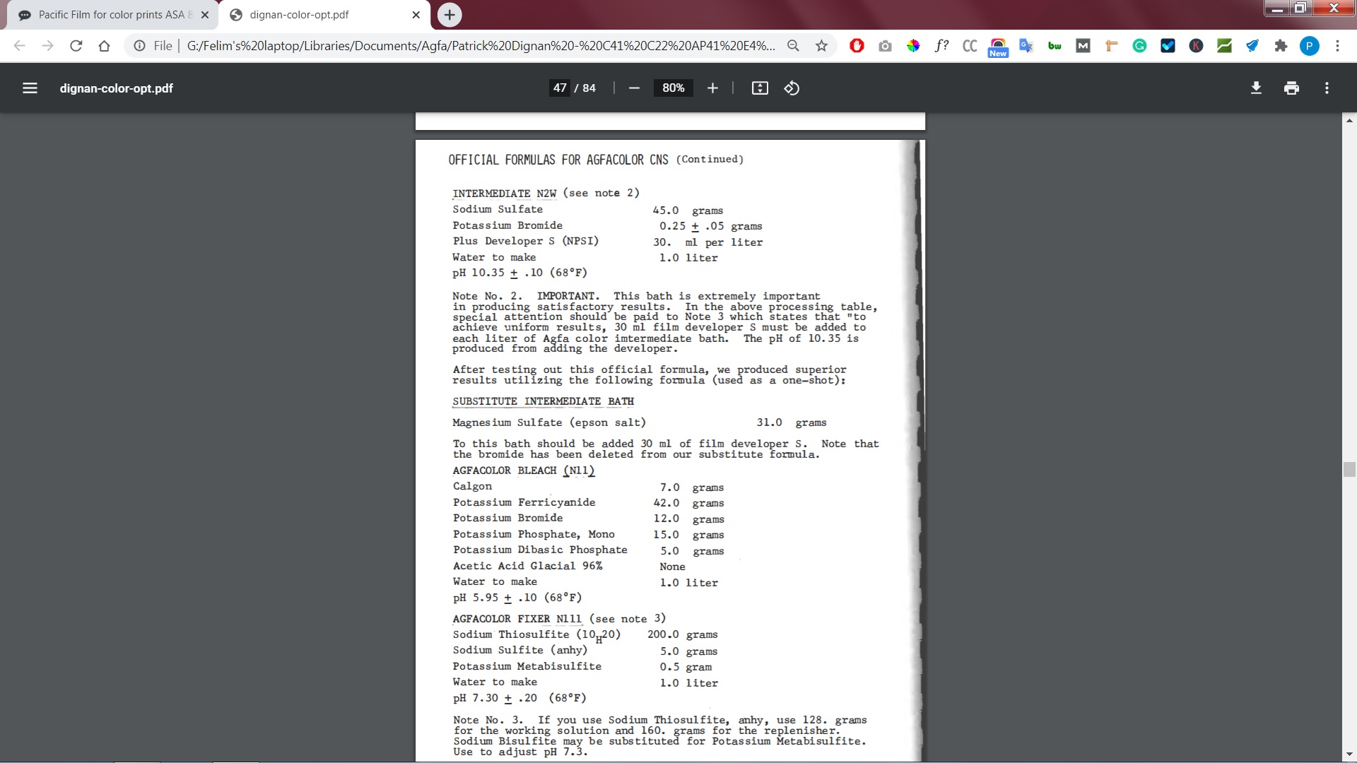

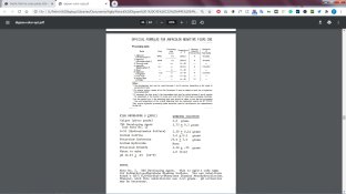

I also came across this in Simplified Color Processing Formulas by Patrick D Dignan.
Sorry about the poor quality screen shots.

Great to see those 5 processes in one table. Those "minor differences" likely are irrelevant for your case but with fresh film they would, due the different masking technologies empoyed.
That Dignan book I looked through just last week, completely forgot about that CNS page...
