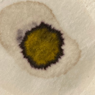

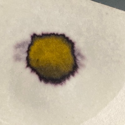

I tested my metol from two different sources following the method pointed out above
There is a test for purity of metol.
One from Disactis, white powder, another bought online from Ukraine, (light) gray powder. See below in that order:
Both have a clearly defined edge, and a yellowish center zone. The Ukrainian metol displays a off-white halo when spreading on the blotter paper, maybe related with some impurity alongside the metol (as opposed to a degradation of the metol itself). I Am Not A Chemist.
View attachment 416618View attachment 416619
The Ukrainian stuff I know is functionally OK, performs as expected when in D-23.

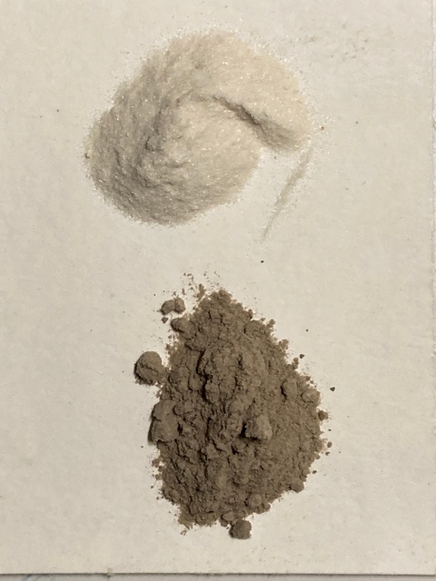

Fore reference, see below a picture of the two samples of metol.
