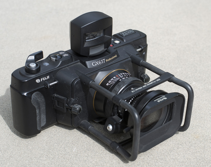

I was actually looking for a G617 when I purchased my GX617. I think the 105mm on that is sharp and does a great job. Truthfully the only reason I ended up with the GX617 is that Roberts Camera got a shipment in of 4 or 5 of them and was selling them at an insanely low price, lower than what the G617 was going for.
Also, a contributor above mentioned something that I missed. There is no LCD on the GX617. I'm not certain where that came from, but its simply not true. The GX617 body is super simple. Its basically a housing that advances the film, with the lens doing all of the work. There's no LCD or anything like that.
