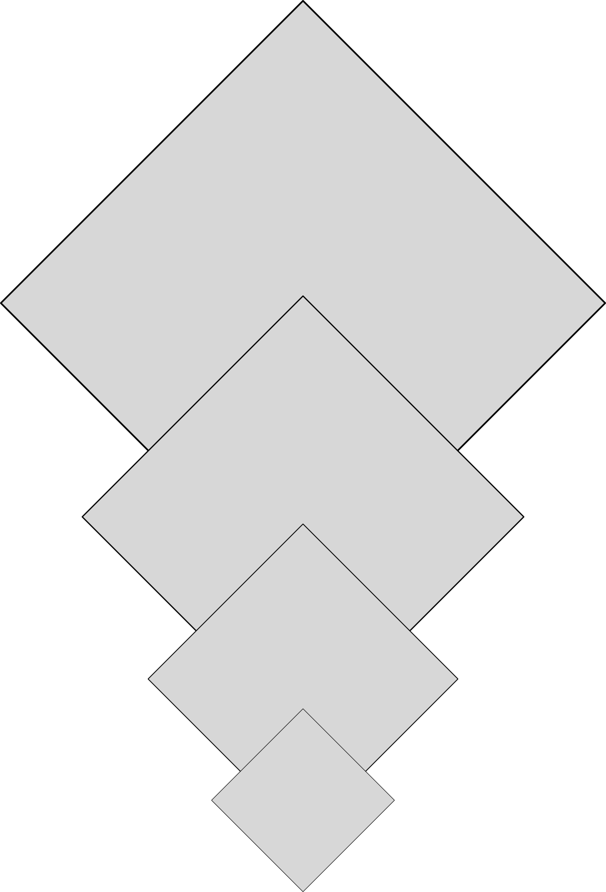

The question I have, though, is this: What would be the best way to handle adhering and mounting? I'm using an RC paper with a glossy surface (still want to call it F surface), and the arrangement is roughly like this:
I plan on cutting a custom mat for a slight edge overlap. Photo corners and wheat paste can be used on three of the four corners of the lower three photos, four on the upper one. Future endeavors may not have this flexibility, however, and the general solution must solve the problem of keeping the photos supported, decently flat, and presentable. In this case I'm concerned about the upper corners peeling away and down.

The way I was taught, and the way I have made collages in the past was to position the pieces like you've shown, and then cut away the lower each print where the upper print overlaps so each piece fit right into each other on one final "layer". It is much cleaner than having prints sitting on top of each other, and there is no possibility for the edges to lift. I am a huge fan of rubber cement in collage applications.
If it were me, I would position and cut all the pieces, and then apply a thin coat of rubber cement to the back of each and then let them dry. Then take a second sheet of paper that will act as the carrier and coat it with rubber cement a little larger than the area of the pieces you are mounting and let that dry also. Adhere the largest piece to the carrier first—it will make a permanent bond as soon as the two dry rubber cement surfaces come in contact with each other so play with a few scraps first so you can get the feel for it. Then assemble and adhere the rest of the pieces to the carrier sheet. When it is finally assembled you just cut away the remaining support sheet and then you can mount that to the matboard however you like.

I was afraid that might be the most likely solution. Blast. Time to get an X-Acto knife… :errm:

Hm! I wasn't aware of that aspect. I knew that contact cement would do such a thing. I've used rubber cement before, and I was always able to peel it off of the items it was joining. Will that still occur? If I mess up the registration, can I peel the photos off and try again with new backing/cement?

You can pull up a piece if the rubber cement is only applied to one surface and put down while wet. If there is dried rubber cement on each surface (back of print and carrier) then it is as good as stuck.
As for final positioning and adhesion: if the pieces are square, you can put a clean blank sheet of paper between the print you are adhering and the carrier sheet while you align the piece and then slowly pulling the clean sheet out while you press it down to make it stick. Practice a few first and you will get the hang of it pretty quick.

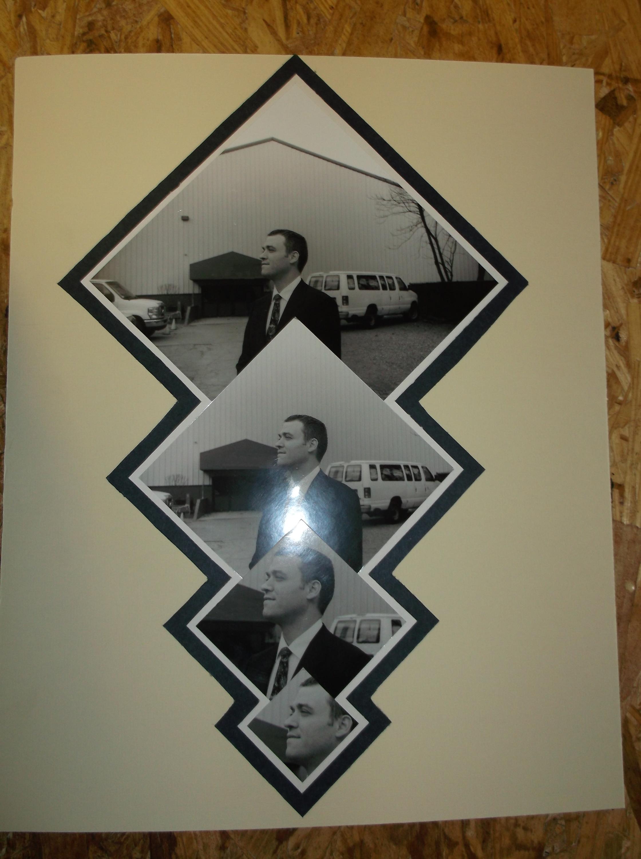

Thanks all for the information! As it turned out, I happened upon 3M Photo Mount, a single-surface aerosol contact adhesive. Though I admit it wasn't the solution I truly desired, I got the collage put together the way I wanted. 'Sides, the subject is really pleased with the result as he assures me his wife will be.
Disclosure: The photo of this mounting was from a digital camera, and some manipulation has been done to the digital image to remove identifying brandmarks.
The total mounting size is 16"x20".
