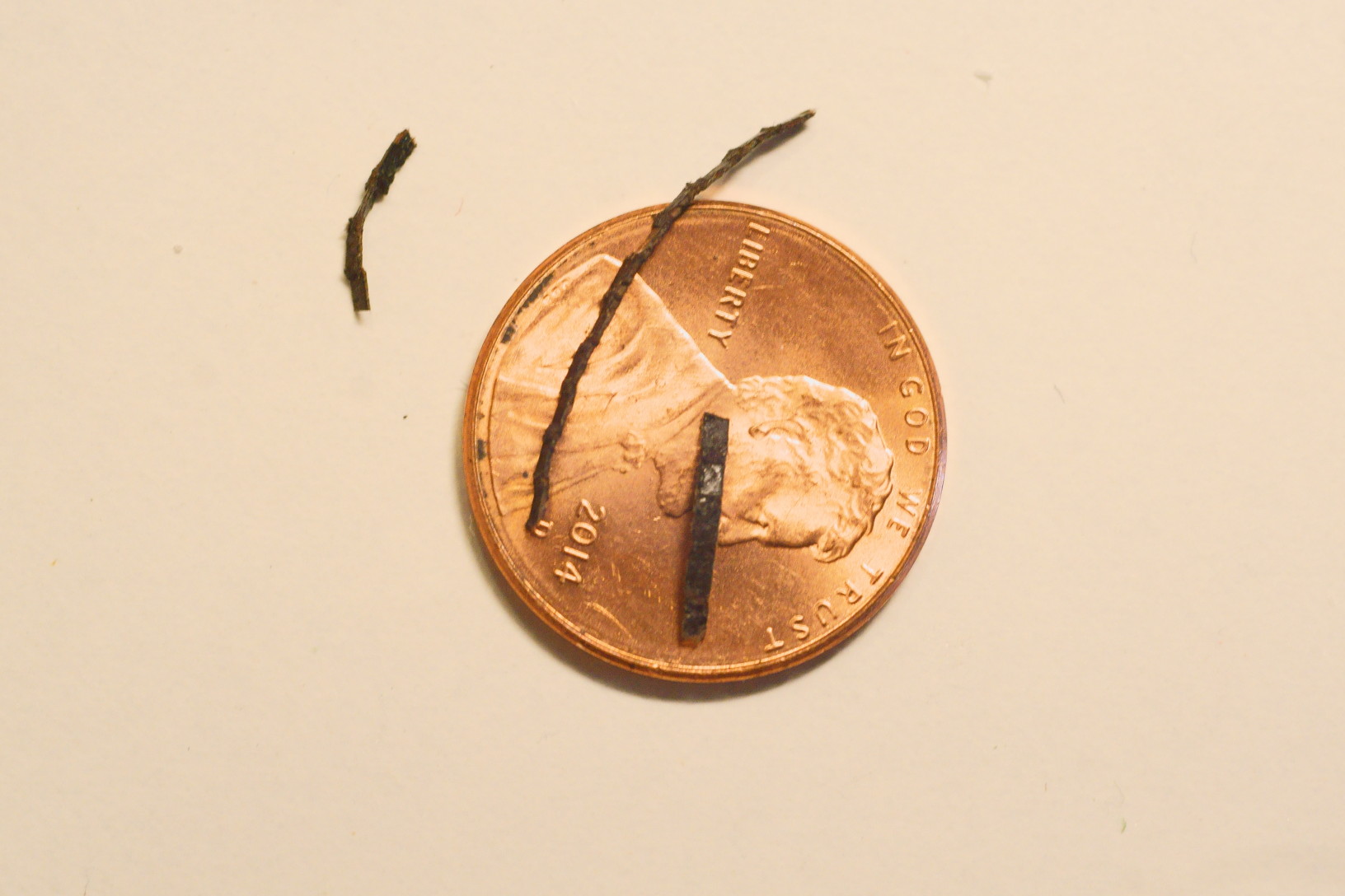

Is there any chance you could post a photo of the strips?
Milandres
Apr 4, 2015
15
US Pacific n
I will be very happy to post a photo.
First I will need to figure out how. I have never been much of a forum poster, rather a chronic lurker :smile:
Milandres
Apr 4, 2015
15
US Pacific n
attachment.php
You can see some of the leather strip fragments
E. von Hoegh
Sep 14, 2011
6,189
Adirondacks
attachment.php
Same image, just lightened a bit.
Thank you. Measuring the date on a cent (and dates can vary in height as you may know), it looks like your estimate of 1mm was better than mine of about a half mm. But, on my curtains they did seem narrower.
As for substitutes, maybe two parallel strands of 6-8 pound test monofilament on each side of the curtain? I need to take a micrometer to a tackle shop and measure some.
