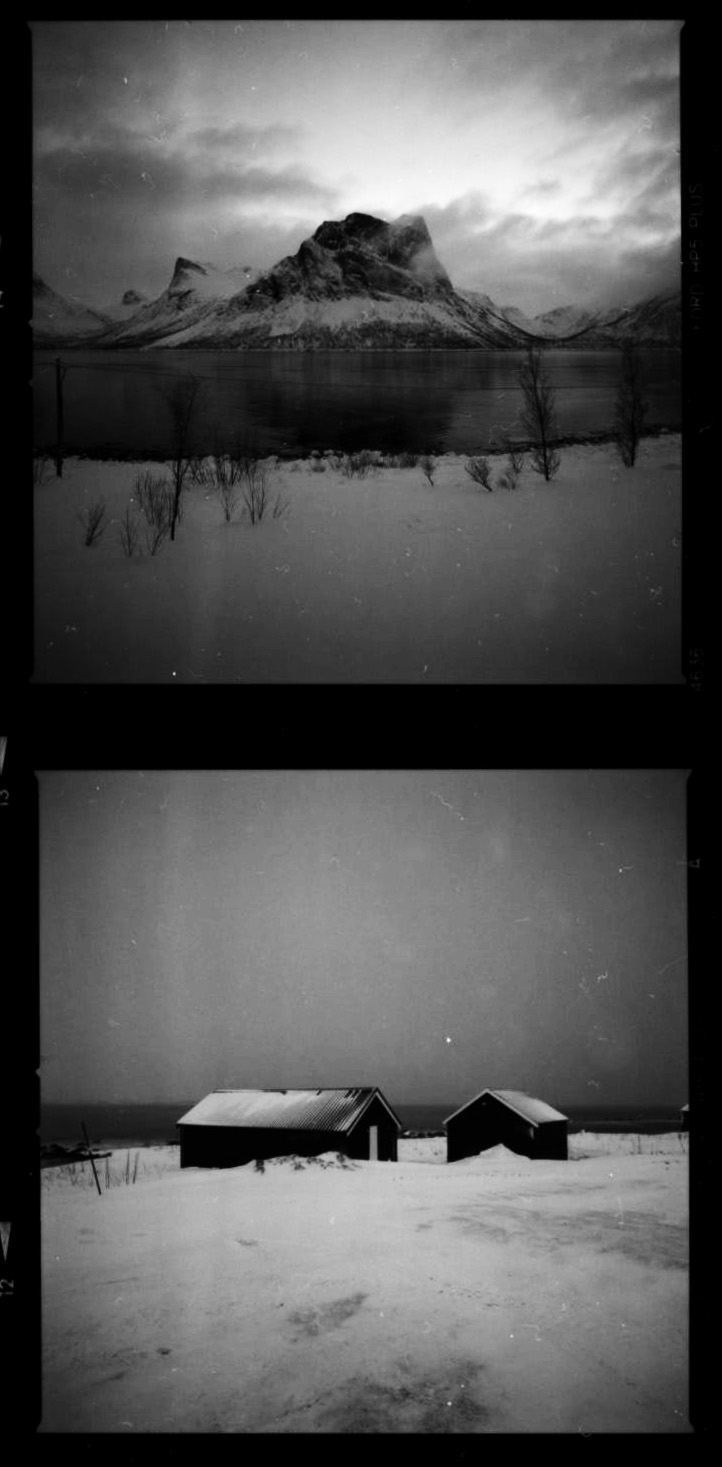

Hello everyone,
I have some issues with my developments lately and don’t know if it comes from the camera or my development process. I have almost systematically 2 overexposed parallel lines (see photos), one on each side of the frame (left and right with hasselblad), but sometimes only one. Do you have any idea what these can be ? There is nothing visible between the frames but it clearly follows a direction from one frame to the next. It keeps coming rolls after roll all in HC110 B with development times between 7 and 9 min. The intensity of the artefact seems to vary and it mainly shows on even middle gray/light surface (ie sky, snow, etc.).
The hasselblad repair service thinks it's process related I do too since I get it from different lenses/back/body/film but only from my hasselblad cameras so far. Not the fujis. I have developed films for a very long time and my agitation method has been problem free for the last decade. I use mainly stainless steel tank with hewes reels but tried the paterson system and got the problem too except this one time when I use two reels in a 3 reels tank for greater agitation. But since the problem is not 100% systematic I can't be sure and this is not normal that I should need to do this...
I invert the kodak way for the first 30s then 5 sharp inversions in 5s every 30s.
It's not x-rays or drying marks. I tried a pre water bath for 2min with no effect. Picture of the film itself would be pointless as this is too subtle to show on picture.
I would really appreciate some technical insight if possible as I am loosing my mind over this. And getting tired of wasting good film shooting the sky...
Many thanks in advance !
Actually, that is the only way to tell - we need to see the negatives themselves, backlit and as large as practical.
In particular, we need to be able to see if there is evidence of the effect between the frames.

It does not appear to me to be outside the image frame, that is I do not see it between the frames. Does anyone else see it as I do?
MattKing
Apr 24, 2005
52,143
Delta, BC Canada
Thee images are too small to tell.

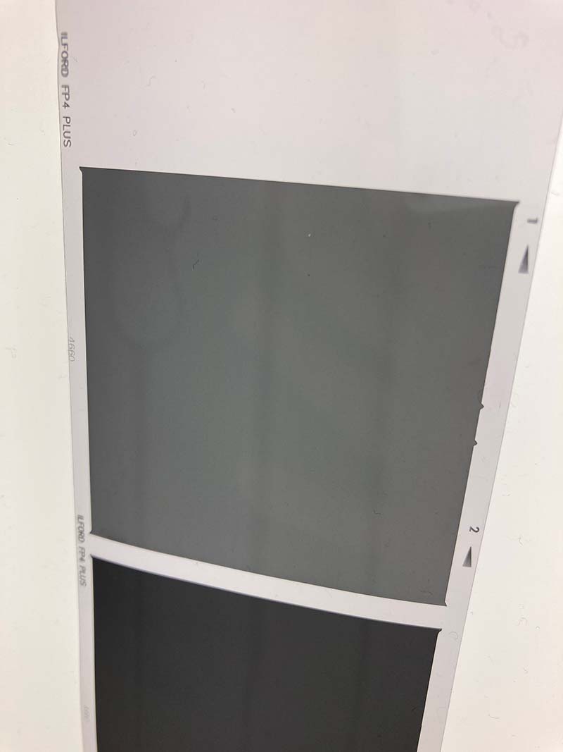

So this new development is soooo bad that I actually manage to take a picture of the problem on the film. 3 lines this times and one of them becomes round like a drop of some liquid...

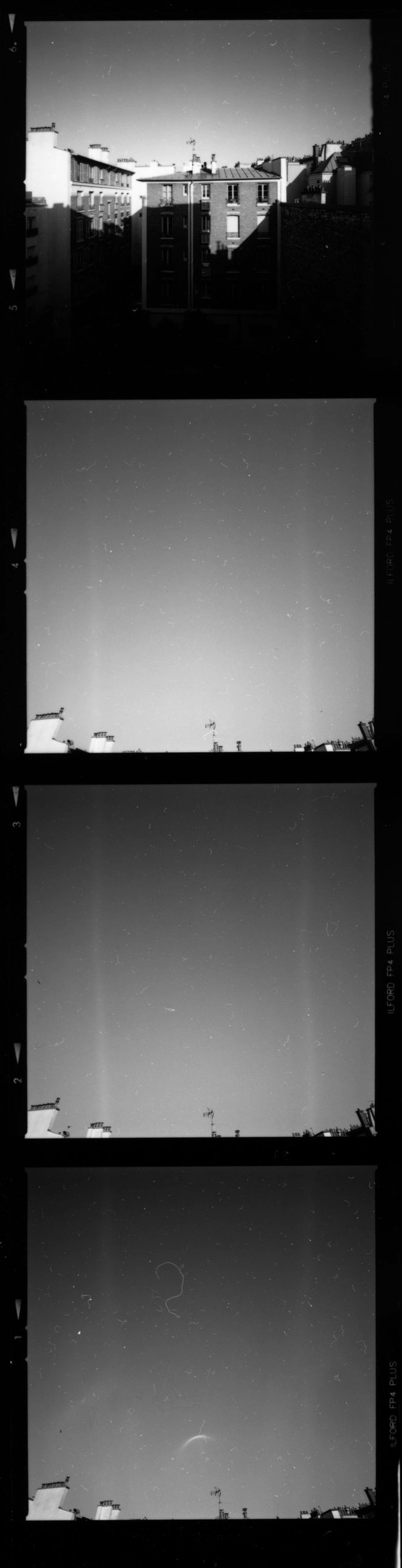

Here are the picture in larger format I think... 3 files

It is within the frame lines, back to the camera.
