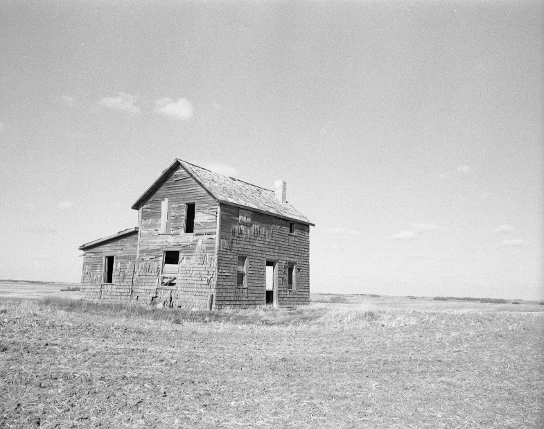

I just developed some TXP 120 in Rodinal 1:50 for 15 minutes at 20 C, inversions for 10 secs at the start of every minute. I got the development time off of Massive Development and the negatives are horribly dense, with little detail in highlights (the shadows should be easy to print:smile:). The scan is just an inverted negative, no adjustments on automatic exposure. I suspect that I have overdeveloped the film and that the chart is wrong; the insert with the Rodinal says 13 minutes but that is for Tri-X, not TXP.
1) Do you agree with my assessment that it is over-developed? If so, what is the "correct" development time for TXP in Rodinal (otherwise I will go back to my ID-11)? I know I can fine-tune developing by extensive testing but since I had to wait 4-6 weeks to get the last 10 rolls, I would prefer less testing, not more.
2) Given that the film is now dry, is there a method of reduction? Can I use Farmer's Reducer(?) or another solution to reduce the development, probably evenly across all zones or am I needing to write off these reels as less-than-ideal? I was under the (mistaken?) impression that reducing should be done as soon as possible after development and is near impossible once the film completely dried (48 hours).
The other idea I toyed with is my Minolta Spotmeter is off but all of the negatives are off by the same approximate amount, leading me to discount the idea. I am taking the meter to work (the local camera shop) tomorrow and testing against the 3 meters I have in store but it is a possibility. I have 2 shots that I bracketed and all three exposures have similar problems, where as if it was metering problem you would assume one exposure would be much better than the other 2.

Check the frame numbers and film info placed on the film edge at manufacturing. Check them against a roll you know was exposed and developed properly.

The contrast is a little high so a little over developed
for the chosen paper grade. Likely the high density is
due to over exposure. Dan

Is every neg on the roll dense? If you only spotmetered for one or two shots (if I read you right) then its overdeveloped.
Farmers reducer is for paper and might weaken the negatives. But since they're shot anyway this might be a good time to experiment.

I actually think the negative looks pretty good given that the scene seems to be very, very bright and "hot". I would have used a sunny f16 exposure in that scene as a possible control. That said, a bit less development would have favored more detail in the highlights to be sure. I've found the massive development chart times a good deal too long for my work (Delta 100 in D76 1:1 exposed at ISO 100 works well for me when developed for 8.5 to 9 minutes whereas the MDC suggests 11 to 12 minutes.) The good thing is that you now may know the likely outcome of the long end of the film's development lattitude.

I have used the Massive Dev Chart times before and they were OK for TXP. However, as other have said, it is impossible to advise, since we don't know what you metered for (and the accuracy of the meter etc). I think the negative looks perfectly printable, and the contrast is fine. I would take a film, shoot white wall, and do a test, and that should put your mind at rest. Remember that TXP is a difficult film in bright conditions due to the short toe it has (at both ends)...I know that does not explain the over exposure necessarily...but if you metered for the shadows (Zone III) it might. The fact that your bracketed shots show no difference tells me the metering or the camera setting is the contributor...since even over development would show the bracketing effect. Rgds, Kal

If "the shadows are easy to print", as in looking like a correct ZV exposure, then the negatives were overexposed. The negative shown has no shadowed areas that would have an detail, so you would have to look at another frame.
If the shadows are normal(ish), the highlights are dense and the frame numbers are extra dense, then the negatives were overdeveloped. A problem with super-concentrates like Rodinal is that there is a good chance for making a dilution error - diluting 1:25 instead of 1:50.
If all the shots were metered with the same meter then a metering error is a definite possibility. Lots of room for error - leaving the ASA at 100 for instance. If you took notes (or have a good memory) and the exposure you used wasn't close to sunny-16/sunny-11, as jovo mentions, then metering is the culprit.
If they were all made at the same shutter speed then a shutter problem is a possibility. Or a sticky aperture.
If the black windows were chosen for shadows that would explain a massive overexposure. This scene would do best with averaging metering - I would even say no metering, just expose at 1/500 at f11+.
I have found the zone system and spot metering can often lead me far astray and out of the realm of common sense.

About the scan - a straight scan never represents anything in the darkroom for me, even if I adjust the scanning control to fill the range from the neg, even from a perfect negative, at least for me. This could be a perfect negative underprinted. You said it is horribly dense, but that is a judgement we all can make differently. I think it is Bruce Birnbaum who recommends the heaviest possible negatives, to capture as much information as possible, to give the most options in printing, long enlarging exposures accepted in the deal.

Edge borders look good and clean, dilution was 40ml to 2000ml of water (1:50) and the other roll of film in the tank looks a quite contrasty but not as dense. Metering was off the side of the building and sky, using the lessor of the two since there are no significant shadow areas with detail to be had. I didn't have a chance to check my meter today, but hopefully will tomorrow.
So, using the old rule "when in doubt, assume you are the error" I pulled out my notebook with data (doesn't everyone use a log on all shots not 35mm) and sure enough, f/8 at 1/125 of a second with a K2 yellow filter. Way overexposed. Assuming my meter is accurate (which is a big assumption that I can check tomorrow), it means I have difficulty with basic f-stop math and need to take more time prior to releasing the shutter.
That said, I do think there is a more contrast than I like in my negatives, so I am going to get one of Fred Picker's books and do some testing. I also think I might alter my agitation schedule but only once I can test efficiently.

From my own experience, doing inversions every 10 sec with Rodinal 1:50 dilution for 15 minutes would give me too dense negatives. My times are more like 13 minutes with Tri-X 400 at 250. 15 minutes would work with a more gentle agitation.
