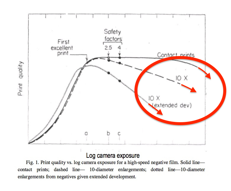

Thank you, Matt and Ian, for your wonderful answers. They are exactly what I was looking for.
Ian, what exactly is the mechanism that causes loss of sharpness and resolution in over-exposed and over-developed negatives? Is it just the increased grain, or is there some separate process at work?
Yes it's the increased grain and the higher overall density which results from the over exposure and over development, also you're masking any surface edge effects that help increase sharpness and resolution.
The technique advocated isn't new it's the way people used to work in the days or uncoated lenses, this was fine with plates which were only slightly enlarged and often processed in Pyro developers to much higher contrasts than we use now, printing papers matched those negatives. The advent of 35mm meant a change in technique to get high quality results Hans Windisch emodies this in 1938 in "Die Neu Foto Schule" (published in English as "The New Photo School)and also the Leica publications.
Essentially this change was made possible because of the advent of reliable exposure meters in the 1930's, Gossen advertise in Die Nue Foto Schule and meters were availbe from a few other manufacturers as well. So at last we could make accurate exposures with minimal over exposure and unlock the qualities possible from smaller formats. It's the way we still work today.
Ian

Ian, I looked at that thread and it seemed to devolve into squabbling without any clear answers. Surely someone who opposes this method of exposure should be able to concisely describe a problem it causes. I've thought about it for a few minutes and all I can think of is the grain issue.
Again: I'm skeptical. I would love for someone to tell me what's wrong with this. But the fact that 5 pages of posts transpired without someone noting a real downside make me think the author is substantially correct.
35mm fine grain film carefully exposed and processed is capable of “nearly 4x5 quality” results. In the’80s that’s what I was going for with Panatomic-X and a tripod. I got some very nice photographs that could stand up in a gallery next to prints from 4x5.
Until you look close and notice that those white spots that are supposed to be Dall sheep just look a little fuzzy and you can’t see their curly horns.
Overexpose and overdevelop would make that shot look so bad that I wouldn’t want it on the wall. As it is I took down that print when I got a couple shots from 4x5 that really look better.
So if you are trying to make 35mm look like 4x5, be studious.
Now if you are shooting 35mm Tri-X handheld. Your photographs will not suffer due to the real degradation in quality. It’s real but come on, you probably get just as bad a degradation in quality the moment you shoot handheld.
In other words, my opinion is there is a loss of quality but it’s a potential quality that 35mm film can give, but which you may not be accessing anyway.
