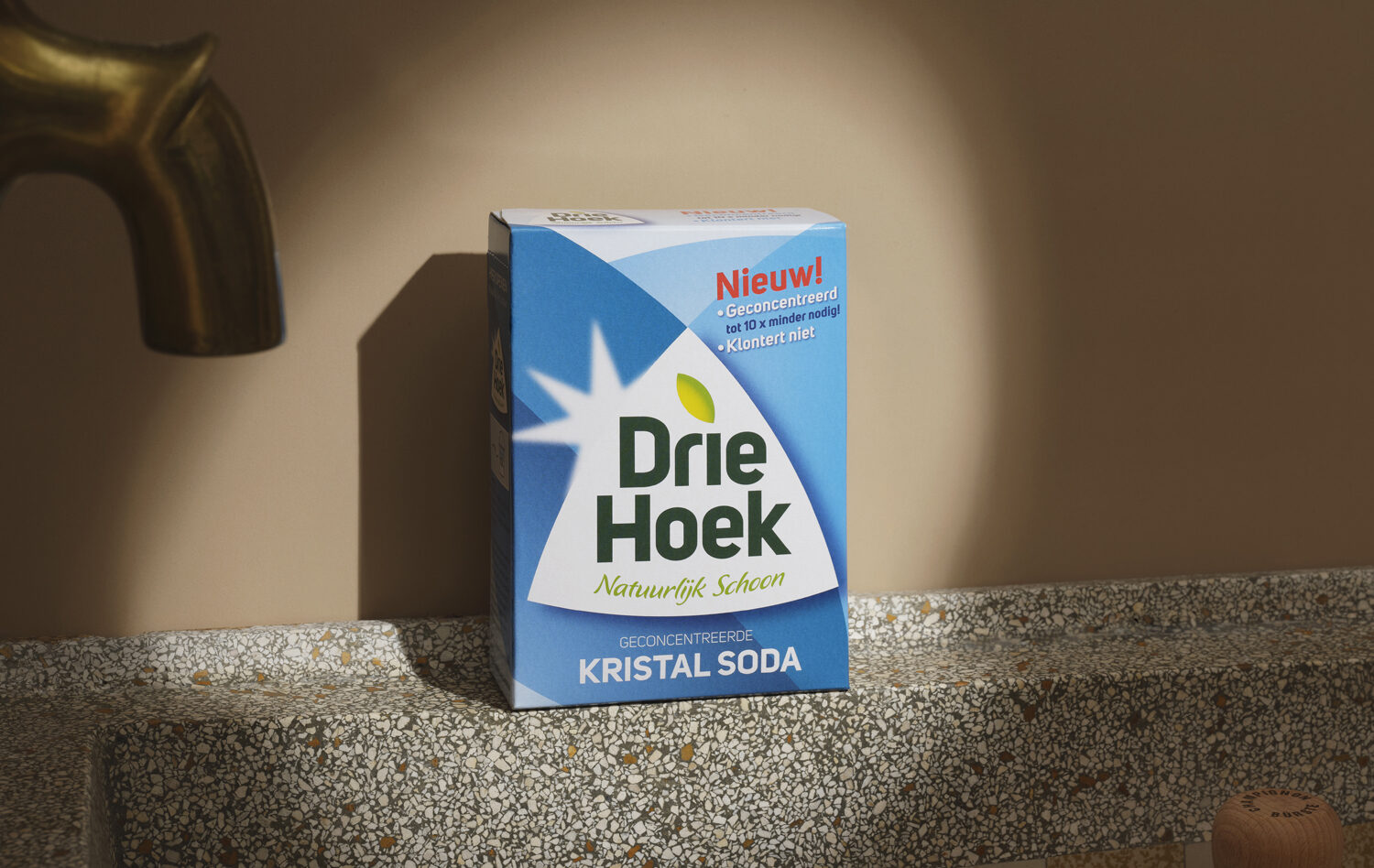

You can buy both decahydrate and anhydrous sodium carbonate in supermarkets. The "Driehoek Kristal Soda" is anyhdrous. It dissolves a little quicker than the decahydrate, and it also clumps less readily (provided you store it in a dry place!)
Of course, it doesn't matter which kind you use as long as you compensate for the difference in molar mass.

Very nice, this gets interesting, I used this one
I have had problems before and contacted the manufacturer and asked if their soda was anhydrous, they were very amused and told me that was not the case.
Anyway I will order the Driehoek soda. Thank you very much!
I'm familiar with that one as well; I used it back in the day when it still came in a green bag. That's decahydrate. I found it a little less convenient to work with because it clumps so badly and it takes longer to dissolve as well. The 'Driehoek' stuff is quite nice. The main problem with anhydrous sodium carbonate is that it's hygroscopic and over time (if exposed to normal air) will convert to monohydrate. This means that in practice, you never know for sure what the ratio between monohydrate and anhydrous in the box is. However, since the conversion rate is 1.17 or so, it's not a major issue in most cases and especially not in your application.
