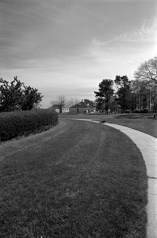

I finished my last 100 foot roll of Kodak film so now I have a chance to try out the ORWO N75 Plus 400 film.
This is from the first roll. Developed for 8 min 24 deg. C in Tmax developer, rotary. Printed on Ilford FB MG.

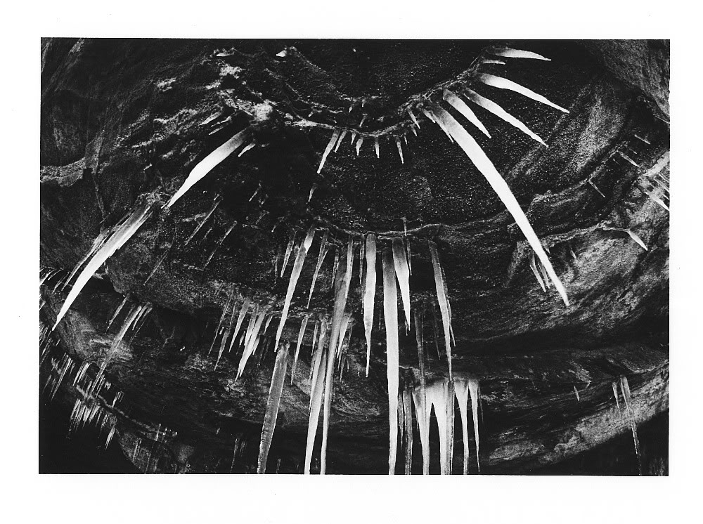

Thanks for the comments. That is the roof of a cave. It is right at the opening, so it is illuminated with the available light.

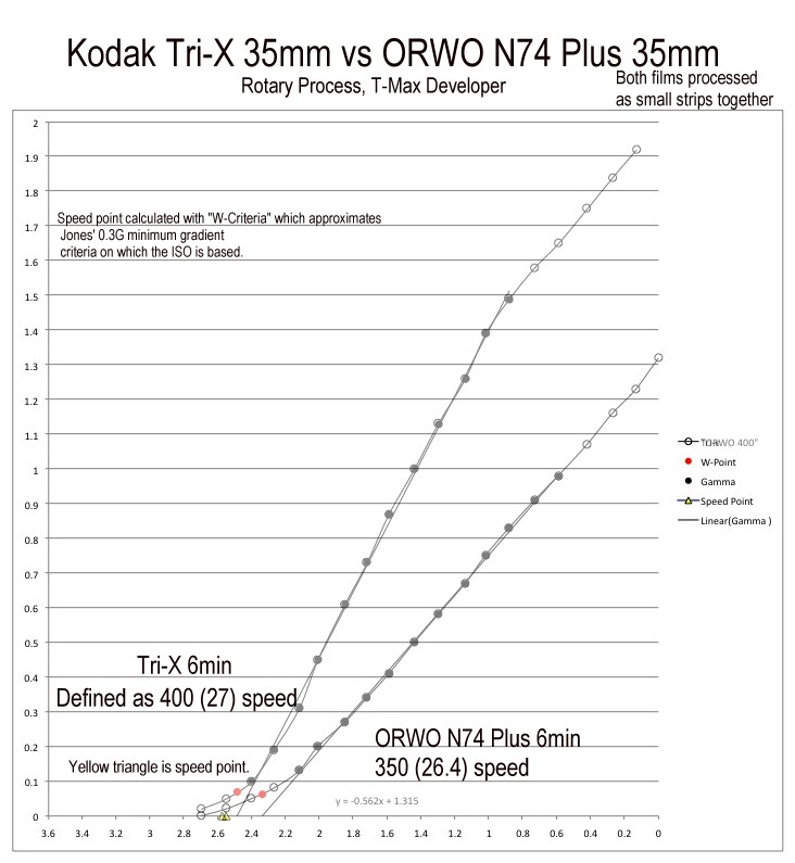

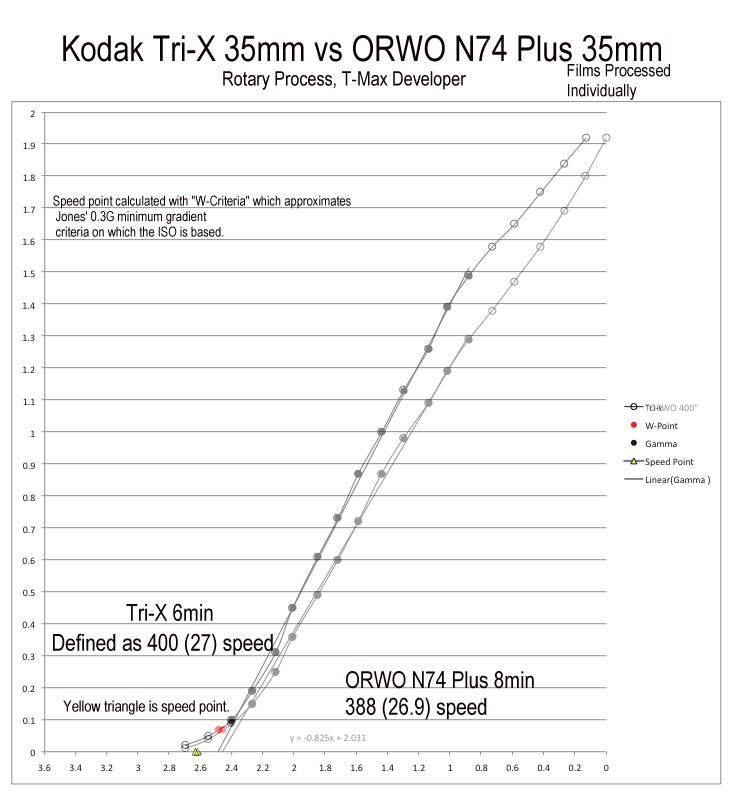

Here are the Tri-x vs ORWO H&D curves:

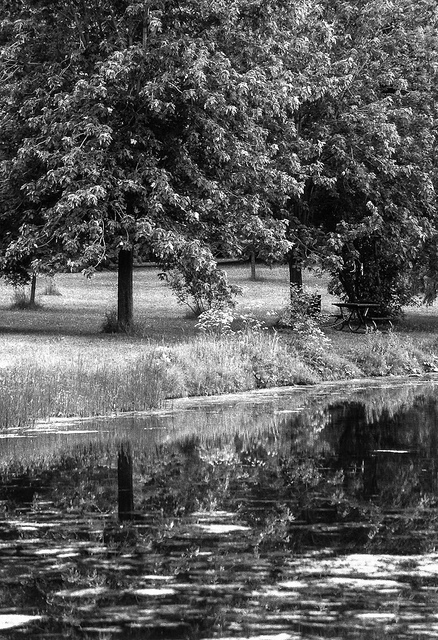

This is my 'example' photograph that is missing from the thread.
