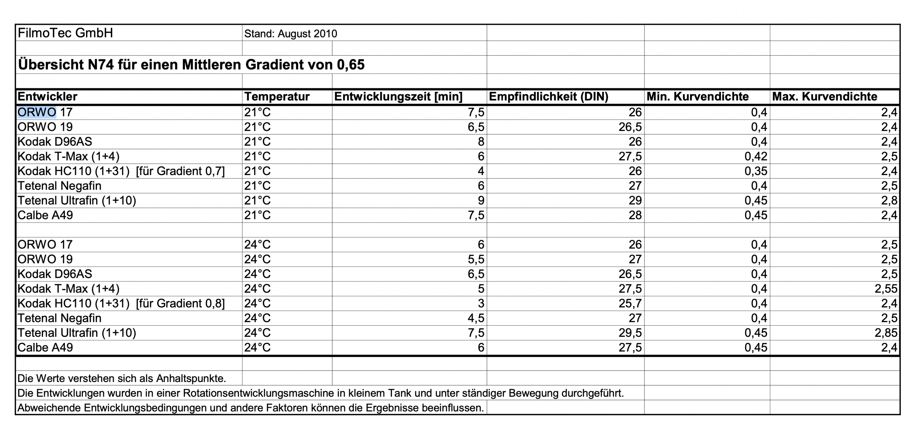

Does anyone have experience with Orwo N75 in HC-110 ? I'm looking for a developing time starting point, since i only have two rolls.

I used Dilution B 1:31 for 7 mins.

This might help:

This might help:
It does :smile: so that's 4.5min at 20°c dilution B if I follow Ilford's temperature compensation chart.
I'll work with that, thank you both for your help ! :smile:
All those times are for continuous agitation.
So if you use intermittant agitation the times will be about 25% longer .
