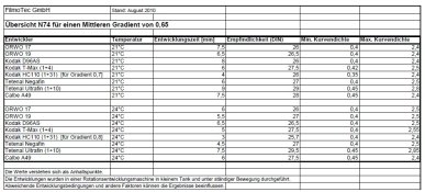

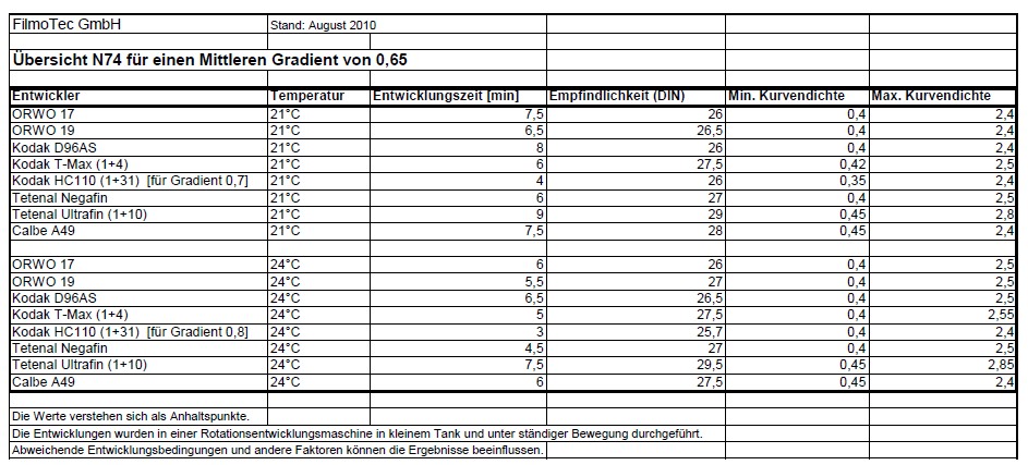

Original Orwo development chart,
All times for continous rotation development.
Calbe A49 is still available as ADOX Atomal.
You can use the times for Ilford HP5+. Both films behave nearly identical in XTOL, PMK, A49
