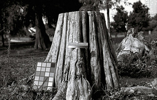

My tests with ORWO DP 3 you can see here:
https://www.flickr.com/photos/21121448@N06/14021405985/in/dateposted-public/
https://www.flickr.com/photos/21121448@N06/13998317366/in/dateposted-public/
https://www.flickr.com/photos/21121448@N06/14049696263/in/dateposted-public/
