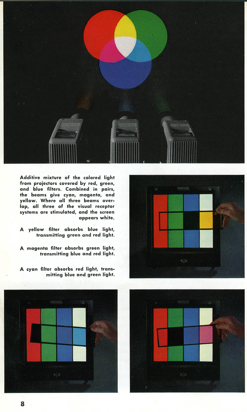

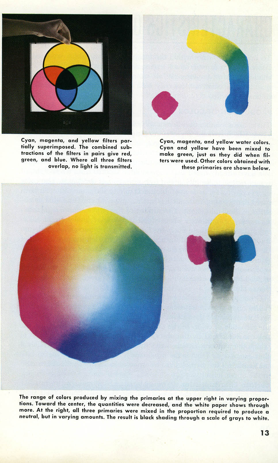

Explanation in detail
Here is the complete explanation in figures of additive, subtractive and pigment colors. Make your own decision about yellow! :wink: And magenta for that matter!
PE

The material above has nothing to do with film. It is as the eye would see it. Nothing is misleading. If you imply that the prism generated spectrum is wrong, then please explain. If you believe that the additive or subtractive color demos are wrong or misleading, please explain for all of us. This material comes from the Kodak Manual "Color as Seen and Photographed".
Explain please, how it is misleading!
PE
You have not explained, in any way, how the 3 demo photos above are misleading, or how my statement urging others to make their decision is misleading! You just bring in information about photons and energy levels. I was trying to simplify things for the readers and you are trying to kick it up a notch!
PE
I have.
But will again, in a way you perhaps better understand?
:wink:
We are talking about emulsions and their spectral sensitivity.
Are emulsions not spectrally sensitized by dyes? If so, colour addition and subtraction are relevant.
Well, I'll just fall back on the examples.
In fact, I never said anything about passing or stopping anything in that post.
I never said that any filter could change the "color" energy level of a photon. Filters can block or pass photons depending on energy level.
You just seem to want to argue! :munch:
PE
