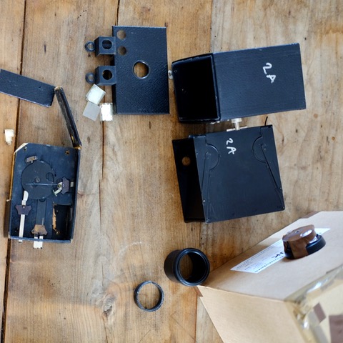

So I broke up the Box Brownie but couldn't release the lens from inside the boards, guess after over 90 years it solidified a bit... (pic below). Still, it got a good clean and will put it back together.

I can't zoom in on that picture, but many of those cameras had the lens retained by a simple spring ring -- literally just a circle of wire with a gap to allow compressing it, sized to be tight inside the hole. If that's the case, a heavy pin or O-ring pick will usually let your pry the ring away from the wall of the hole and then you can get a hook or screwdriver tip under it and lift it out.
Once you're done cleaning the lens and hole, you can drop the lens back in (right way around, please), compress the ring a bit to start it in the hole, then push it down against the glass with a screwdriver tip.

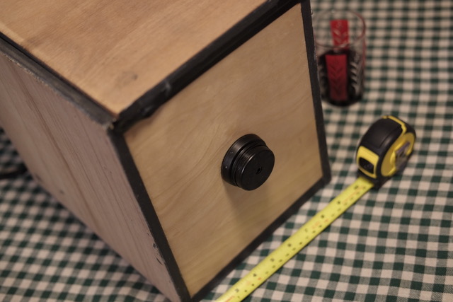

So the box is built and I did a very rough test. The stop is approximately 40mm in front of the lens. I am going to make the stop distance shorter for the next test in the hope there will be less vignetting/ the projected circlular image will be slightly larger (?). The whole 10x8 'negative' isn't covered (the whole point was that I wanted to get a higher res photo to blow up- larger than the Box Brownie version).
The tracing paper on glass view/ focus test was tricky but it helped a bit.
Anyway I will post an image within the week. Surprised though that I got a reasonable image at all- and the focus ain't bad !
