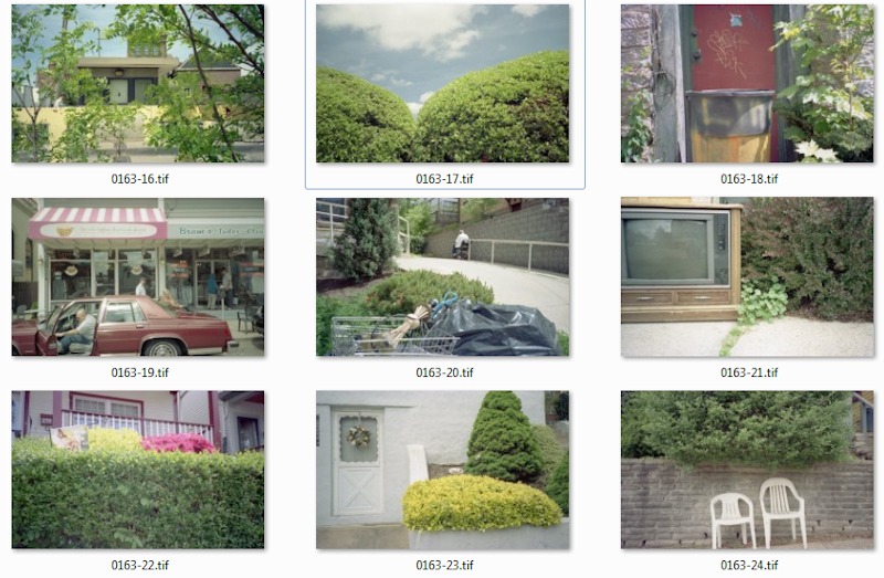

Without any correction, it scans with a greenish-yellow cast as someone here suggested. To compare, Superia and Portra scan with the color very close to what it should be, if not dead on. I knew better than to draw conclusions about the film itself based on this, so I picked a few frames and headed to the darkroom.
My enlargements are shown below. I scanned each print with no color correction, so as to eliminate processing variables; I think the prints "pop" a little bit more when seen in person. I've also included a screenshot of the scans so you can see what I mean about how the negatives scan.
