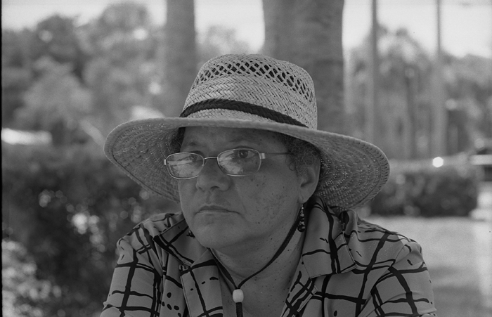

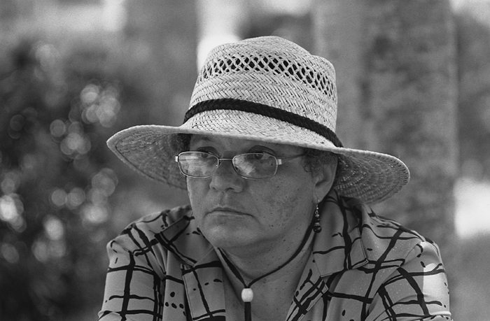

This is Tri-X in D76 and flat lighting. The first is w/ an orange filter, the second is w/ a red filter. Linda is black, but she's not dark at all. The shirt was red w/ black markings. By the time I had fumbled around and switched lenses and filters, the lighting had changed on the second photo, but you get the point.
I wasn't happy w/ the orange filter on any of my shots, but it may be just what you're after. I'd say an orange filter and Acros in flat lighting would give you a very nice morgue look, assuming your model has light complected skin to begin with. I wonder what film was used on the flickr link photos above?

I think part of what's going on here is gross overexposure of the film, which means that the highlight areas lose all contrast and texture because you're mostly imaging on the film's shoulder.
This, to me, is "bad tones from bad technique". Note that the skin looks dead/flat even though it's nowhere near paper-white.
