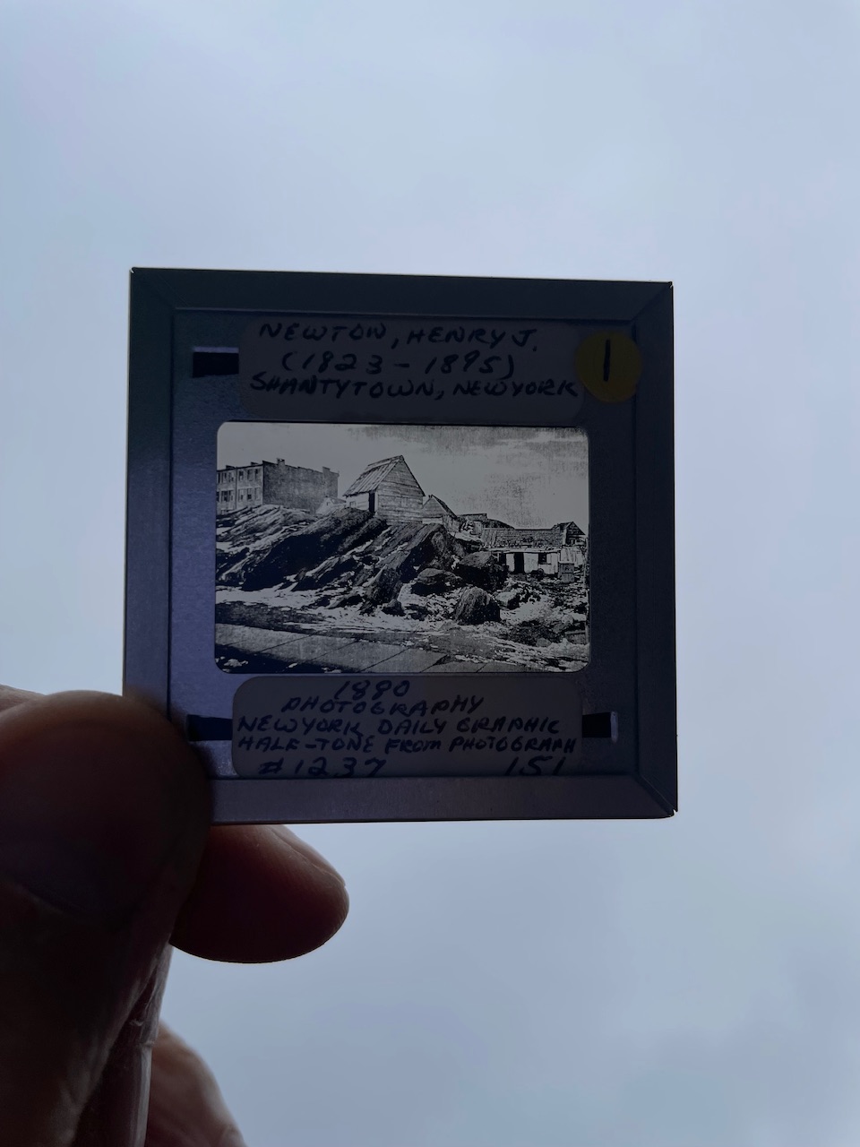

I have (once) projected a 35mm positive onto ortho 4x5 and then printed from that negative.

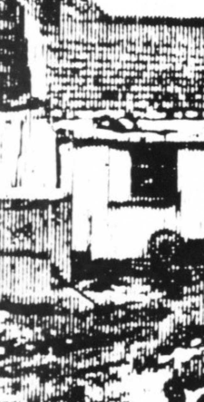

The idea of making two generations of reversal to end up with, say an 8x10 negative seems daunting.View attachment 411082View attachment 411083
That's a neat example, but...it's a halftone image. The reproduction method proposed earlier through an interpositive or a reversal method will produce a continuous tone image. And while it's some work, it's not much different from making a regular silver gelatin print. Make a couple of test strips while adjusting exposure & development until you're happy with the result.
