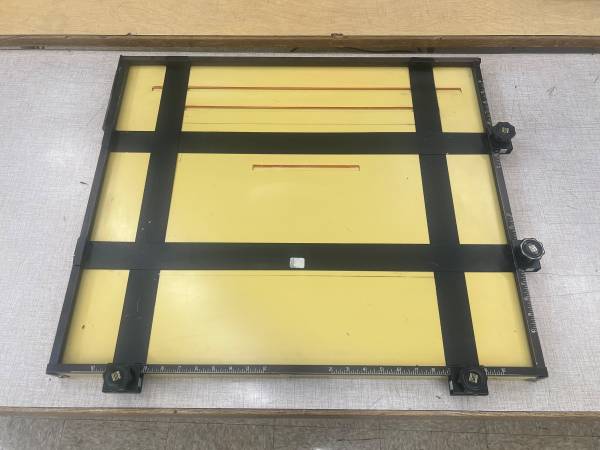

There's one on my local Craigslist here in Northern California, but that won't be too useful to you in the Netherlands. But it might give you some idea of (asking) prices...
