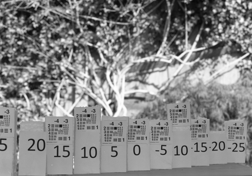

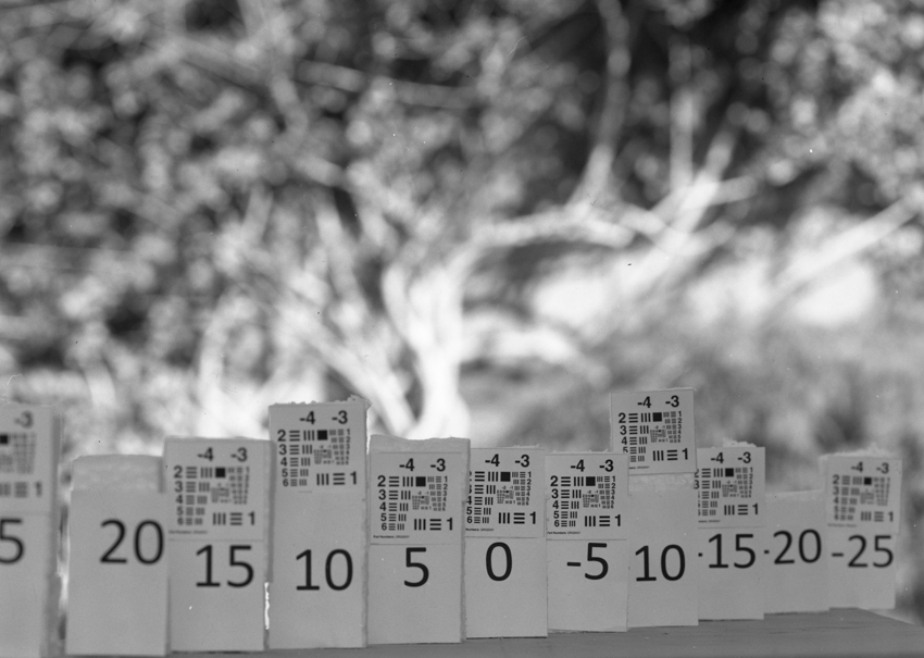

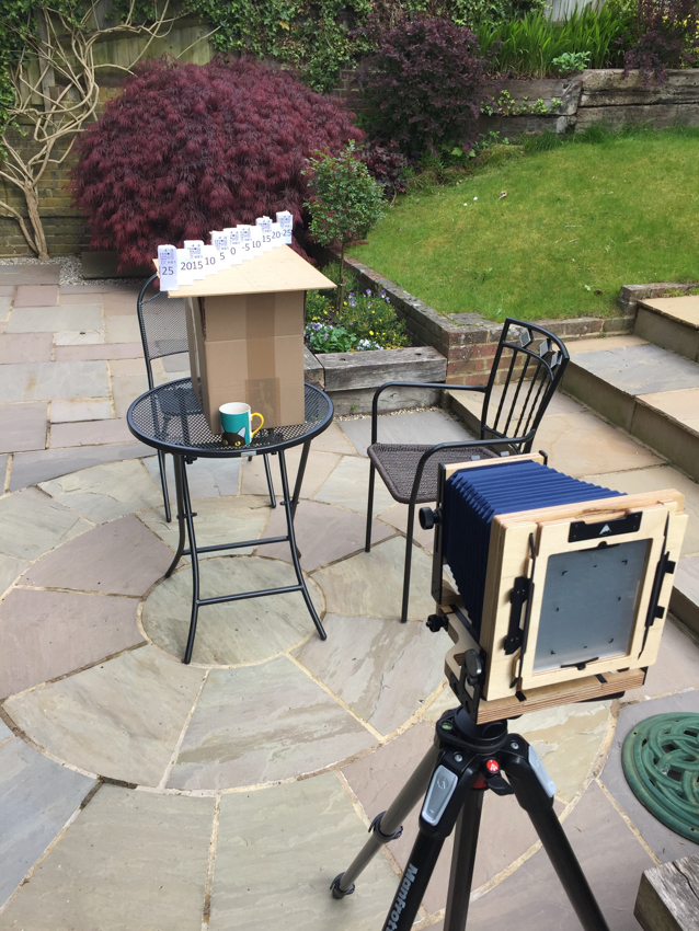

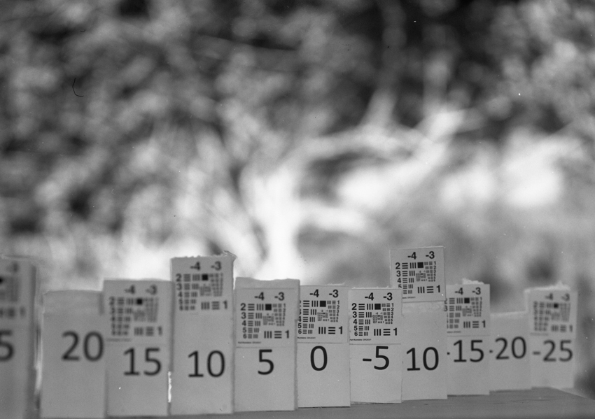

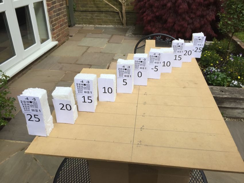

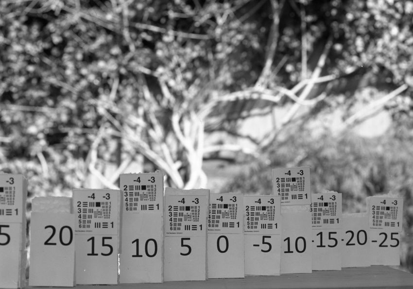

Thanks to everyone for their advice. Lots for me to learn. To that end I did a test shoot yesterday. I rigged up a simple test target with mini USAF type charts stuck to a board at 5cm intervals from the focus point. The aim was to shoot at 1.5m at different f stops to see how the focus was actually affected and how the bokeh looked.
I took 4 shots with the 240mm lens at f9, f16, f32 and f45. Here are cropped scans of the results. I would probably choose f16 (or perhaps f22 which I didn't test) for a compromise between DoF and sufficient bokeh. Top left f9, top right f16, bottom left f32 and bottom right f45.

Dan, I imagined focusing on a subject's eyes at the zero position on the test charts. I wanted to find what the out of focus areas actually looked like, especially the background. Rob

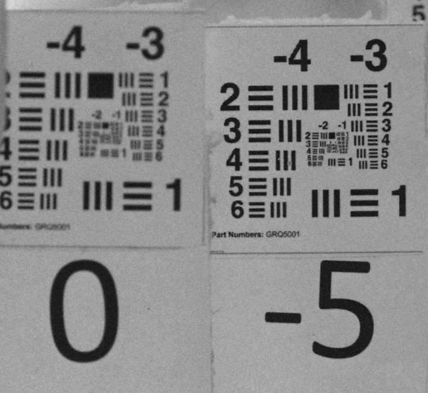

You may want to have someone check your ground glass depth - your -5 is sharper than your 0.
Jarin, you are right. It may be a focusing error on my part. Are you saying that the GG might be in a different plane to the film when the holder is inserted? Not sure how to measure this.
Jarin, here is a crop from the f9 photo where the difference is most noticeable.

I don't know the Intrepid at all, but a common source of small focus errors is the ground glass being inserted facing the wrong way. It's normally with the ground side facing towards the lens, and if there is a Fresnel sheet, and the glass holder was designed to hold a Fresnel sheet, the sheet goes on the lens side of the ground glass with the inscribed side facing the ground glass. If the glass holder was not designed to hold a Fresnel sheet, then the Fresnel goes between the user and the ground glass with the inscribed side against the ground glass.

Jarin's accurate observation has caused some "consternation in the ranks"! I have just had a proper look at the GG screen and plywood holder on the Intrepid and compared it to the alloy one on my MPP Micro-Technical Mk8. Both have a depth of 5mm from the face that mounts onto the back of the camera to the lens facing surface of the GG. There is a tiny variation, probably less than +/-0.2mm between the four sides of the mount. In truth, I can't measure this with consistent accuracy using the simple depth gauge on my mechanical vernier caliper gauge. The Intrepid GG holder is CNC machined from plywood so I wouldn't expect it to be able to hold a tolerance of less than +/-0.2mm. Obviously the guys from Intrepid will know better. I did find that the GG was a little bit loose in holder so I have tightened the retaining clamps. So unless this slight looseness of the GG was the cause I don't think the camera was at fault and I probably didn't focus accurately enough. I might repeat this photo test to check. At the end of the day the Intrepid is an inexpensive lightweight camera. It is early days but if I can get good consistently pictures with it I will make it my normal 4x5 for back-packing. The MPP is obviously more robust and stable but is very heavy in comparison.
