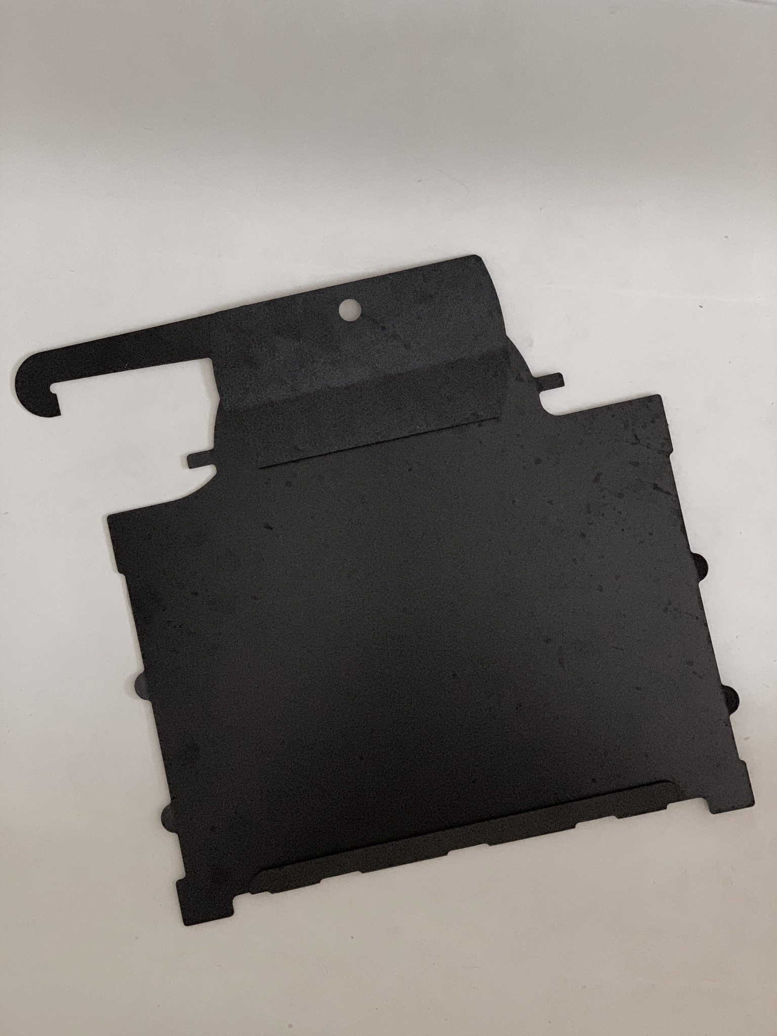

Those nova clips seem to be a lot easier to clean than the print holders the Optima unit uses. My last session I tested keeping my Versalab print washer filled with water, but completely empty so it was just the tub. After each print I would dunk the print holder into the washer a few times and then hang it up. This worked well 80% of the time, but I would still get the occasional stain from leftover fixer. Maybe I need to try it with the print washer running so there is more water circulation?
Also, if anyone is unaware of the style of the print holders I have attached an image for reference. My main area of contamination has been underneath the flap at the top and occasionally along the bottom edge.

That's a terrible design. Seems designed to maximize carry over.
That looks to be a similar design to the paper holders used in the Nova processors intended for use with fiber-based paper. The much smaller clips are used in their processors geared towards RC paper, like the Monochrome. The large paper holders supposedly provide better support for fiber paper since it is relatively delicate when wet.
I use a Nova Monochrome for printing on fiber paper up to 11"x14" and have never had a problem using the smaller clips. You can also use two clips to better support the paper, but I've never needed to do so. The smaller clips are also very easy to rinse off using running water. I can imagine that the large paper holders require more effort to clean between prints and allow for much more carry over.

The Nova clips really sound great, I wish they worked with the Optima system but I'm pretty sure the slanted design would prohibit that. If I continue to have contamination issues I might try and create my own bootleg version...
That was my video. I have used a Nova processor before, and I didn’t see any advantage with the slanted design of the Optima. I don’t like either design for RA4 because of how sensitive the developer is to blix contamination. It’s too easy to accidentally drain some blix into the developer slot and ruin your print run.
It worked pretty well for large b&w prints, but I worried constantly about uneven development since there isn’t a lot of room to move the holder around in the slot.
