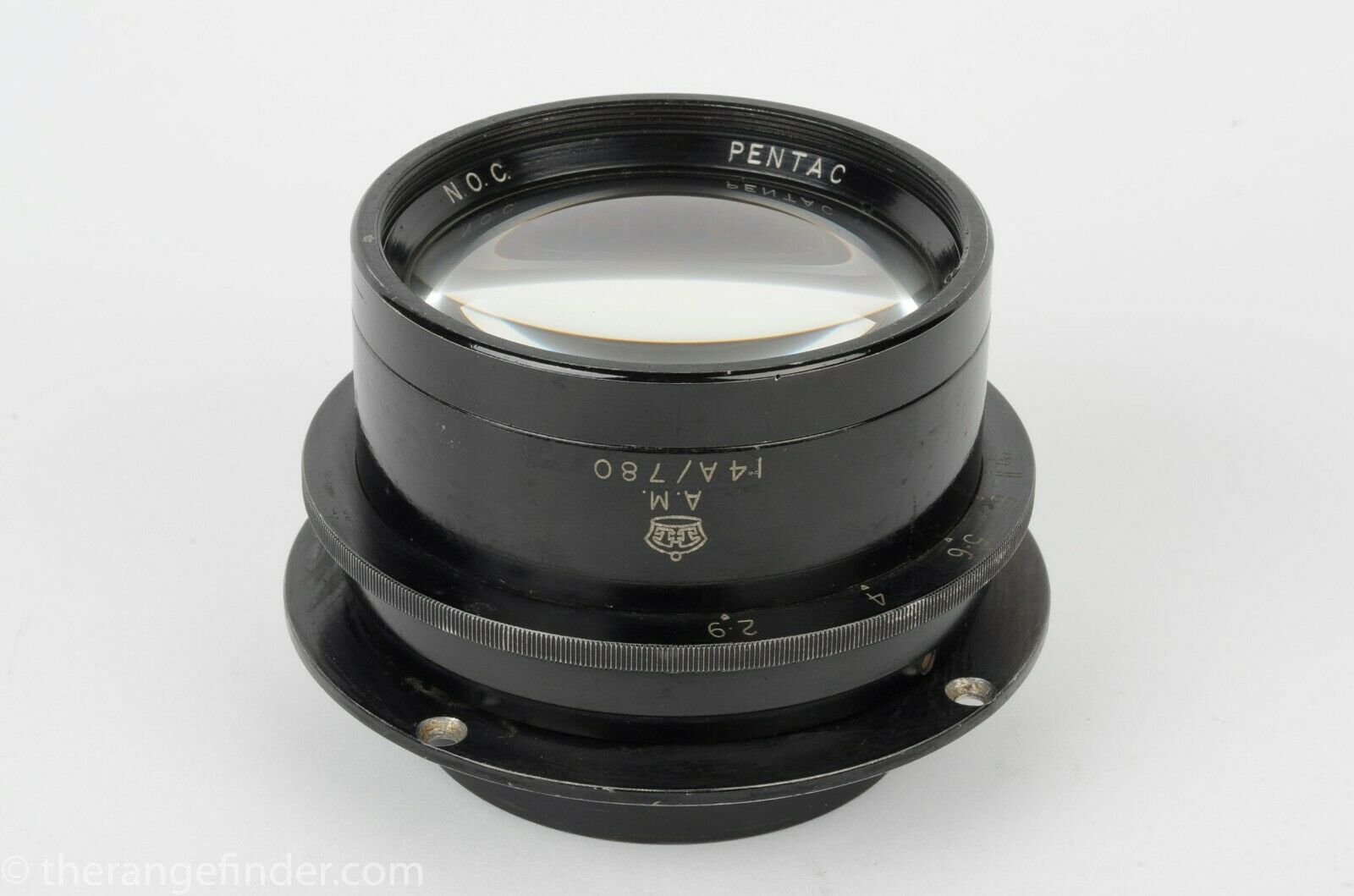

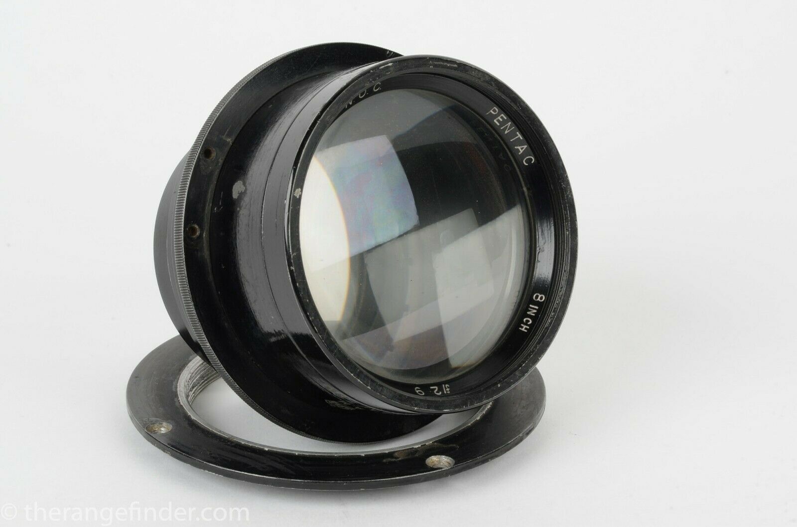

Hello,
I was trying to find the optical design for the Dallmeyer Pentac 8 0 Inch f/2.9 Lens
Mine was made by N.O.C. (National Optical Company) is stamped with an Air Ministry Crown and number
I have had it mounted on a Jo Lommen lens board for Speed Graphic. Will be trying it out soon.
Thanks,
Scott
It is a heliar type. From front to rear, cemented doublet (biconvex, concave-planor), singlet (biconcave), cemented doublet (plano-concave, biconvex).
