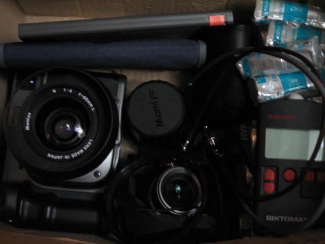

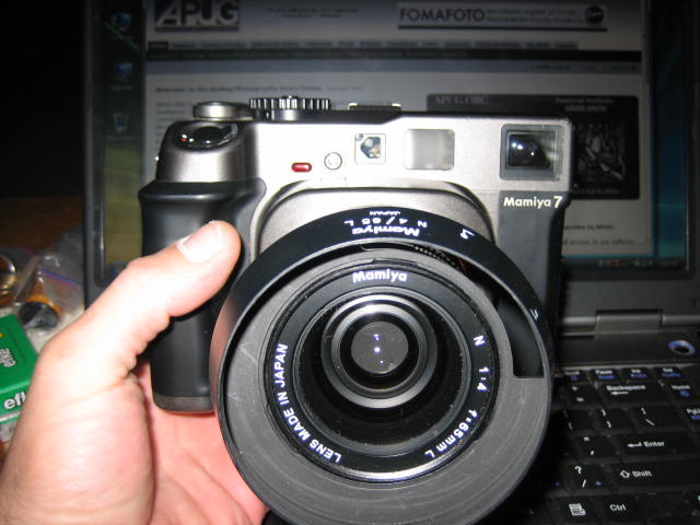

Thanks everyone for all the advice. After the job being rescheduled it finally has been done. The customer was so nice that she bought be breakfast, lunch and dinner. I was there ever at dinner time. The job took a few more hours than i expected but i now have my Mamiya 7. She also included some filters a Gossen Sixtomat meter, a small little light box to view the negs, 2 cable releases, 8x scope, camera strap, carring bag and 27 rolls of Velvia (expired). The filters are odd to me because they are square and slip into a device that goes on the front of the camera.
The camera has been sitting for 5 years so i put in a new battery to try it out and everything seems to be ok. The shutter sounds accurate at 1 sec, 2 sec, 4 sec so i think its fine. I will run a few rolls through it today to see how it performs. I will give the camera a chance before i decide if i will trade it for a Hassy, but to be honest I'm not liking this rangefinder deal! Is there anything i should watch out for since it has been sitting for 5 years? Below are a couple of photos. Thank you again everyone for all your help!
