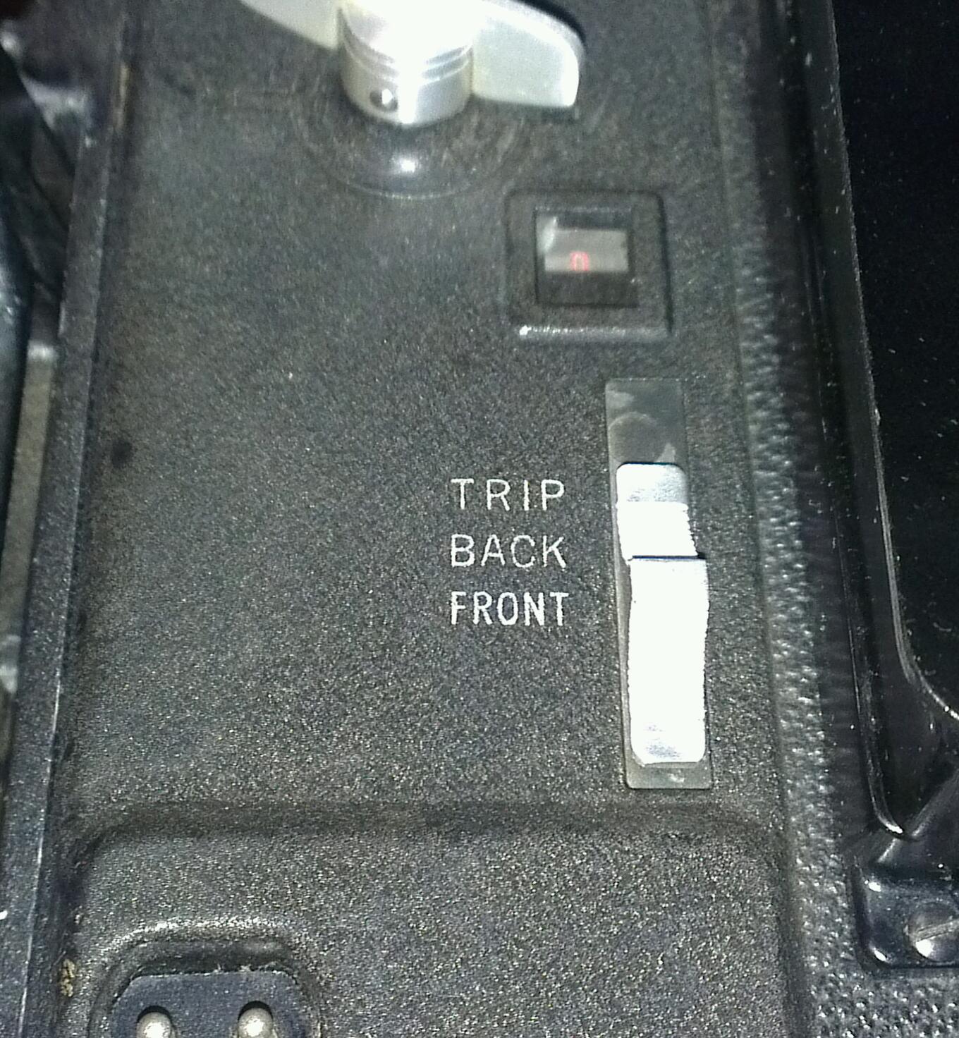

Its arrived :D its in nice condition and everything seems to work, but im a bit confused, I have only ever seen speed graphics with 2 focal plane shutters and you select the shutter you want on the side, there are 3 options on the switch, front, rear and trip, mine has the switch but it doesn't seem to move and it doesn't have any writing next to it either? Not really too worried if it doesn't have a front curtain as it means I can fit the wider lenses like the crown graphic camera, ive just never seen one without the marking, I don't really want to force anything!
Here is the side of the camera, you can see it goes up to 1/1000s shutter speed but you can also see a lack of info next to the slider (which doesn't slide it seems)

On mine top is trip, middle is back and bottom is front.
You have to push in on the slider before it will move - kind of a failsafe to stop you accidentally moving the selector.

How far do you have to push it? Mine doesn't budge at all it seems! Mine is at the bottom and fires the rear focal plane shutter.
Edit - yeah mines not moving at all, it seems that its been somehow locked in the bottom position for a reason.

You have to depress the slider before it will move up or down - see the labelling from my own one in the attached pic.
Having said that, maybe there's something wrong in your mech?

I will have to investigate further, maybe it was taken apart then reinstalled upside down or something, btw is the writing embossed or just painted on?

Looks like it's screen printed on. Letraset might do a good job...
For what it's worth, I am a bit worried about camera shake when using the rear shutter, so I tend to use the front shutter only.

I can still operate the front shutter on the lens with a cable release, its just odd that its firing the rear focal plane shutter in the down position, ive just tried to move the slider by pressing down on it, ive used all my weight on it and its not moving at all, does the focal plane shutter need to be cocked before swapping to the front one?
Edit - I have just emailed the seller, basically what he thinks might have happened is that the switch has moved in transit and is now out of sync, ie its slipped 1 place so that the slider is in the 'down' position but its actually on the 'middle' position - it also means I can't go down any more to set to the front lens.

Update on this issue, the camera was fully checking by the guy I bought it from, he has had a few of them over the years do this when being posted out where the spring loaded slider mechanism slips and needs resetting, he is sending me over details of how to reset it back to how it was. If I can't sort it out he said he is willing to do it if I sent it back and he pays the postage - its nice to know that there are decent genuine sellers still out there!

Right, this is all sorted now, the seller sent me over the details on how to reset the switch - its very simple to do, basically remove the and then loosen the cover to allow the slider to move freely to the correct position then retighen. It seems that I am missing a screw on the plate which is why it might have come slightly loose in transit and slipped, its all sorted now! Im glad its quite a simple camera to work on, its firing perfectly now.
