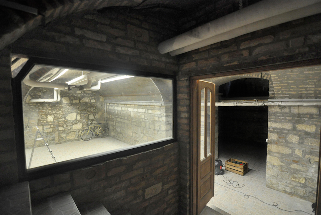

Hi all,
I'm currently working on opening a communal darkroom in Budapest, Hungary. Whilst I've set up small, personal darkrooms over the years, this will be larger than anything I've worked with, so I'm reaching out to the community for advice and suggestions.
I know there are many people here who have set up, or used many larger darkrooms, and I'm wondering if you have any general advice, or tips you may have wished you had received in the renovation/set up stages.
I've scoured the forum for answers to many queries, but still open to suggestions.
I'm about to run plumbing and ventilation, but haven't 100% locked in my layout, so thought now is the time to ask.
We have a very unique space, built around 1859. The premises has 2 main rooms with large vaulted ceilings. Room one will be a workshop area, and room 2 the darkroom. Is has the original exposed brick - I would love to keep the walls as they are but worry dust may be too much of an issue (even after treating/sealing).
I'm looking at 4-6 enlarger stations in the darkroom, with a small, private room for one as well.
I'll link the FB page. There are a few photos of the main room, but more will come.
PM me if you would like to offer advice, or comment in the thread.

1. This has been the hardest part of the design process as I'm trying to keep the existing double door way (for moving large items in/out), but also split the door way in 2 (to make separate entrances for a mezzanine-bathroom (that has natural light). It sounds very strange? it is. Currently looking at a folding-modular-U-door light-trap option.
2. It's all tiled. see photo

Since your darkroom appears to be below ground level: watch out for humidity, it can easily get out of control and mold can destroy much of your precious work. BTDT. The rooms look dry now, but wait for hot and humid weather outside, people going in and out or just leaving the doors open, and full water sinks inside. It's typically cooler inside, which turns 80% relative humidity outside into 100+% inside. There are devices for dehumidifying rooms, but these draw quite a bit of electrical current over time. Make sure that at least your enlarger lenses are stored in a somewhat dry place.
Second issue may be dust and little debris falling from the ceiling, which can easily ruin a print if it happens during enlargement. Consider covering the ceiling with plywood sheets, walls are much less critical in my experience.
Finally: make sure you have a double door system between your dark room and the outside, this way people can enter and/or leave the darkroom without letting light in.

My first thought on seeing the rooms is air handling , HVAC, heating, ventilation and air conditioning. Beautiful space. Here in the central part of the USA , we see anywhere from -30 to +40 C. The humidity in the summer can be awful. I have my darkroom in an air conditioned home, I still run a dehumidifier 7 months out of the year. The winter months bring 15C in my darkroom without additional heat. If you bring a lot of outside air in during humid months it will make it worse.
If you can use low odor chemistry that would help. Maybe let the toning baths be in a separate space.
Archival washers that drain directly into the drain pipe . i.e. try to minimize evaporation associated with large sinks, huge trays etc. Dry the prints in a separate room if practical. 5 or 6 people working in that space is going to get close.
