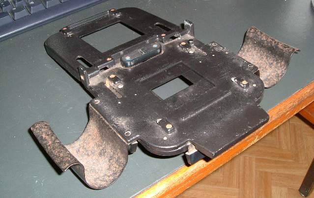

Hey Tony, what sort of neg carrier do you have with yours, glassless or glass carrier? I'm curious about glass carriers.
Mine has a metal glassless carrier with the sliding insert for 35mm. My wife does leadlighting and so she made me a pair of glass plates that fit perfectly, so when I use 6x6 negs I just sandwich the neg between the two glass plates and then place it all in the carrier and insert it in to the enlarger and it works fine. I just wonder how different the factory made glass carriers are, if they exist.

Does it look like this?

Focussing aid?
Now you guys have me wondering...
I'm curious about the block you can see on the rear of my carrier (refer previous post with the attachment.) Is this the split focus aid some have described?
If so, how do you use it?

So it is. Pull the holder half way out, twiddle focus until the two lines match up. Focus should then be perfect.

Pull the carrier forward and a split line of light appears on the easel, adjust the focussing knob until it becomes one sharp straight line and then push the carrier fully home. Wam bam the image is a sharp at it's going to get.

Well I'll be damned... Never knew if had that focusser feature. Could have saved the money I spent on the grain focusser.
Oh well, that's life I guess.
Glenn

Neither did I and now I really feel stupid :confused: Didn't even think about it, I bought a grainfocusser that is a pita and it turns out I don't even need it.
The worst part is this isn't my first enlarger that have this feature DOH :sad:
