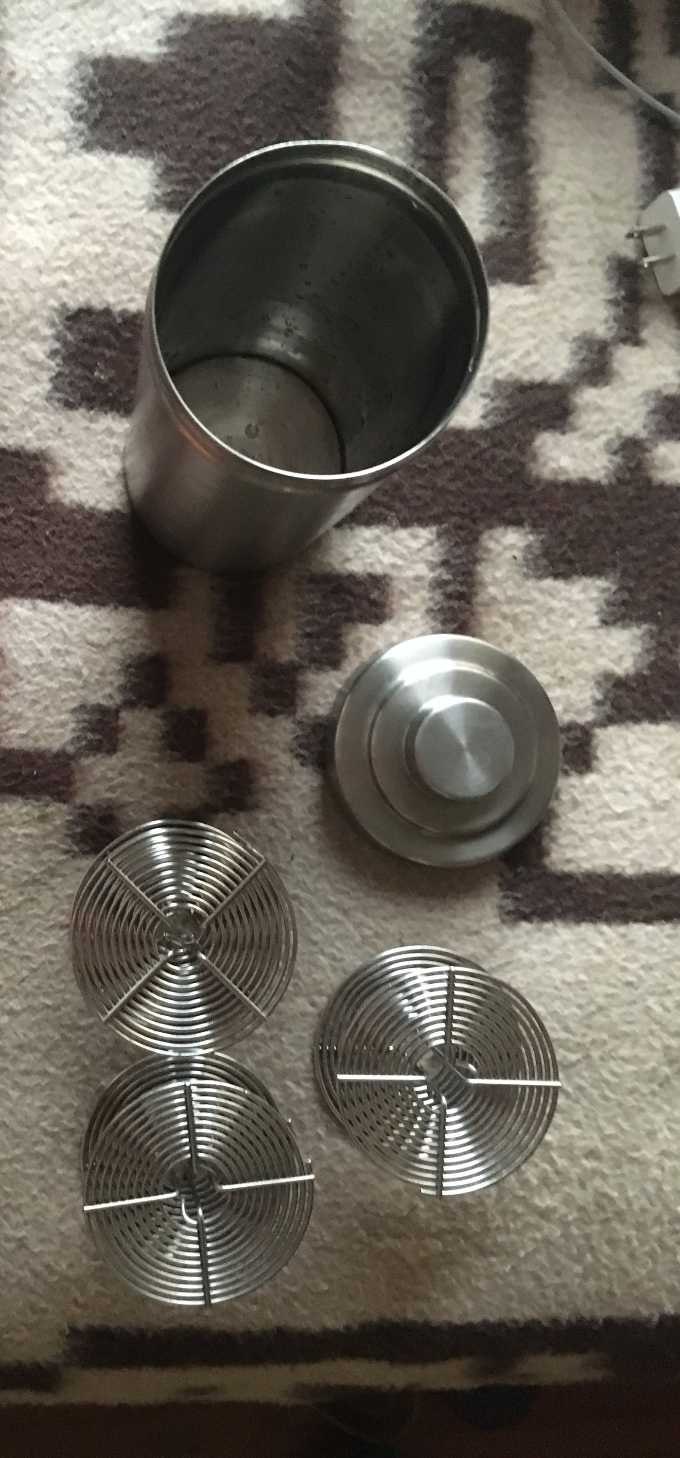

I am not really sure what brand the tank is because I got it from eBay but it’s Japanese, has 3 reels.

If you put all three reels in the tank and add a liter of water...does the water cover all three reels?

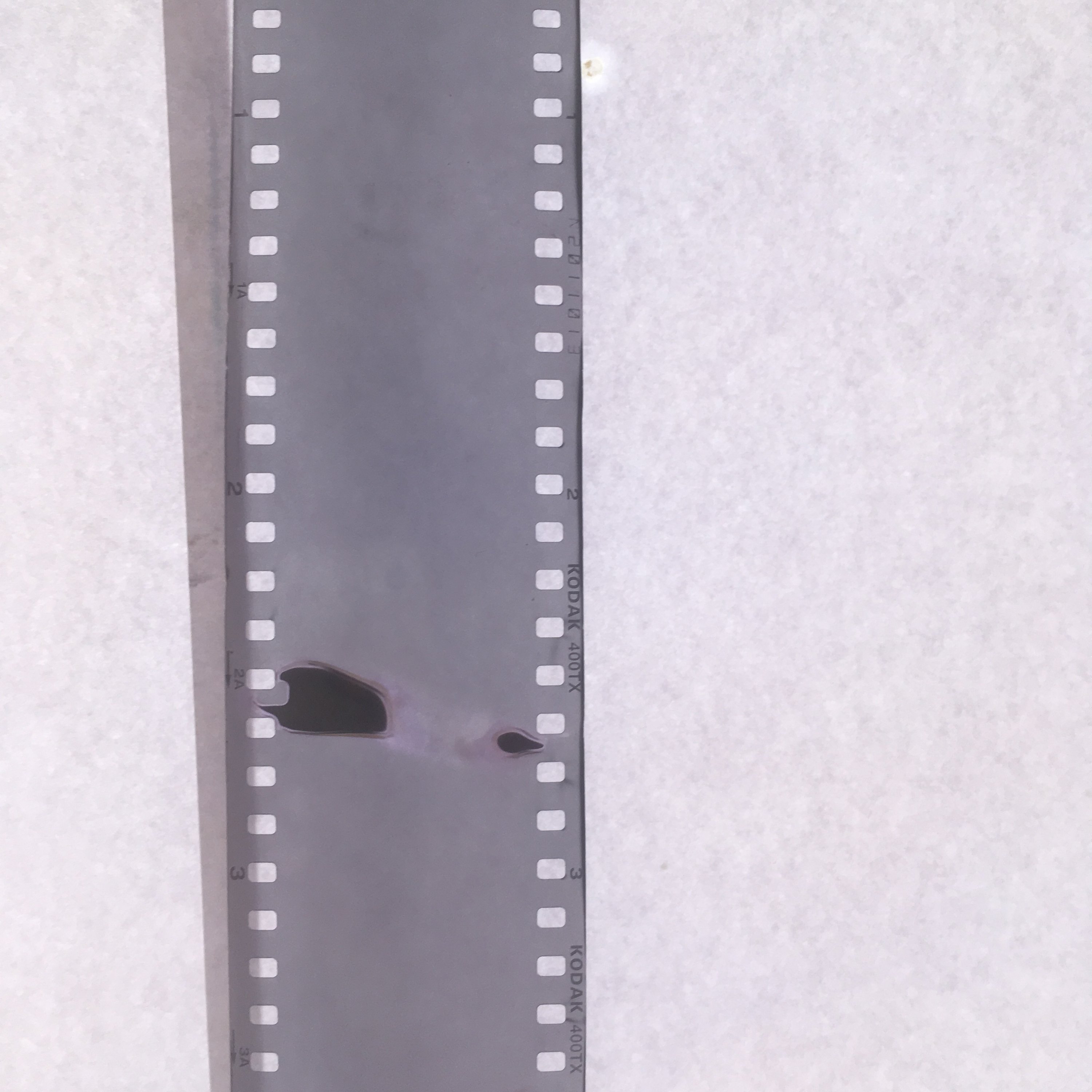

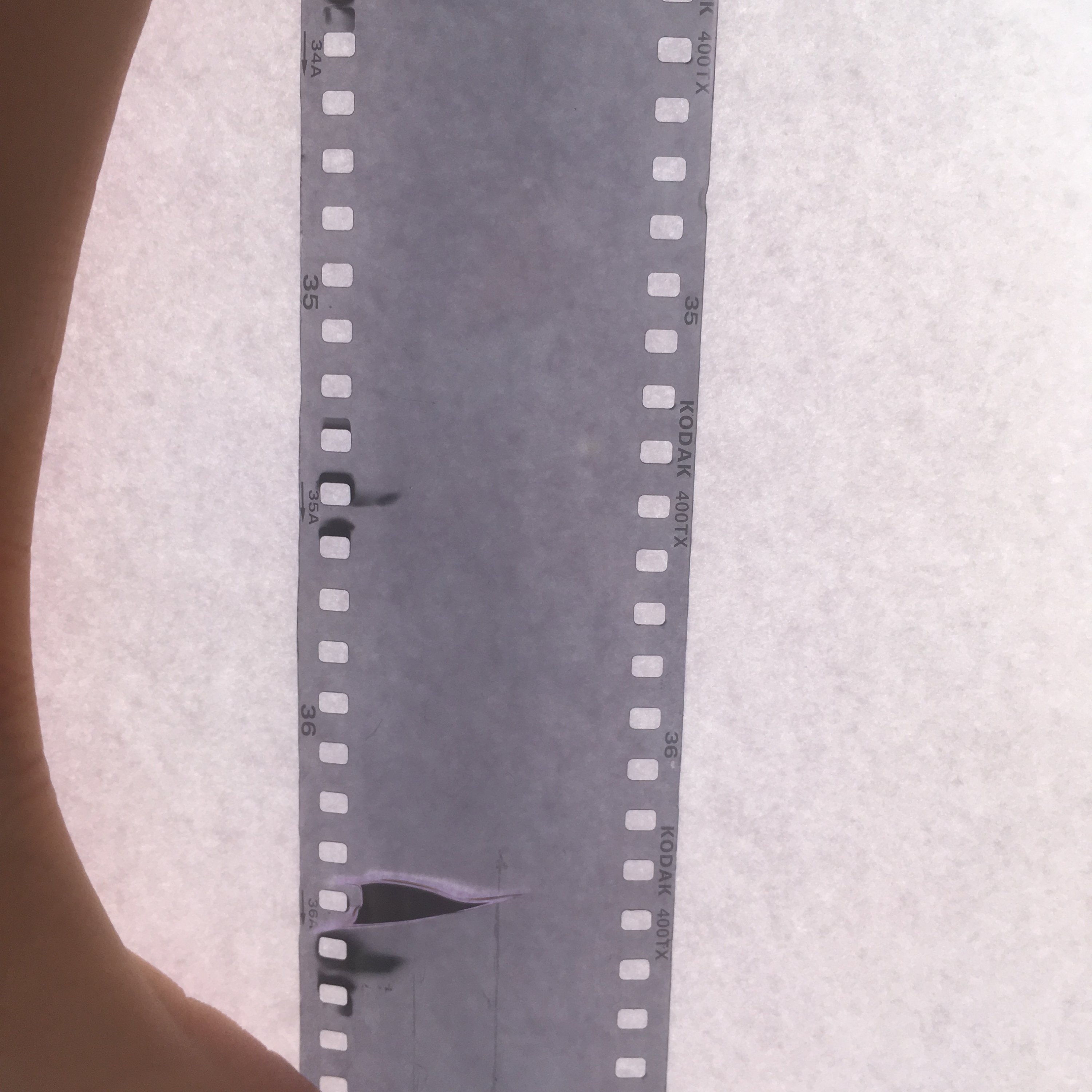

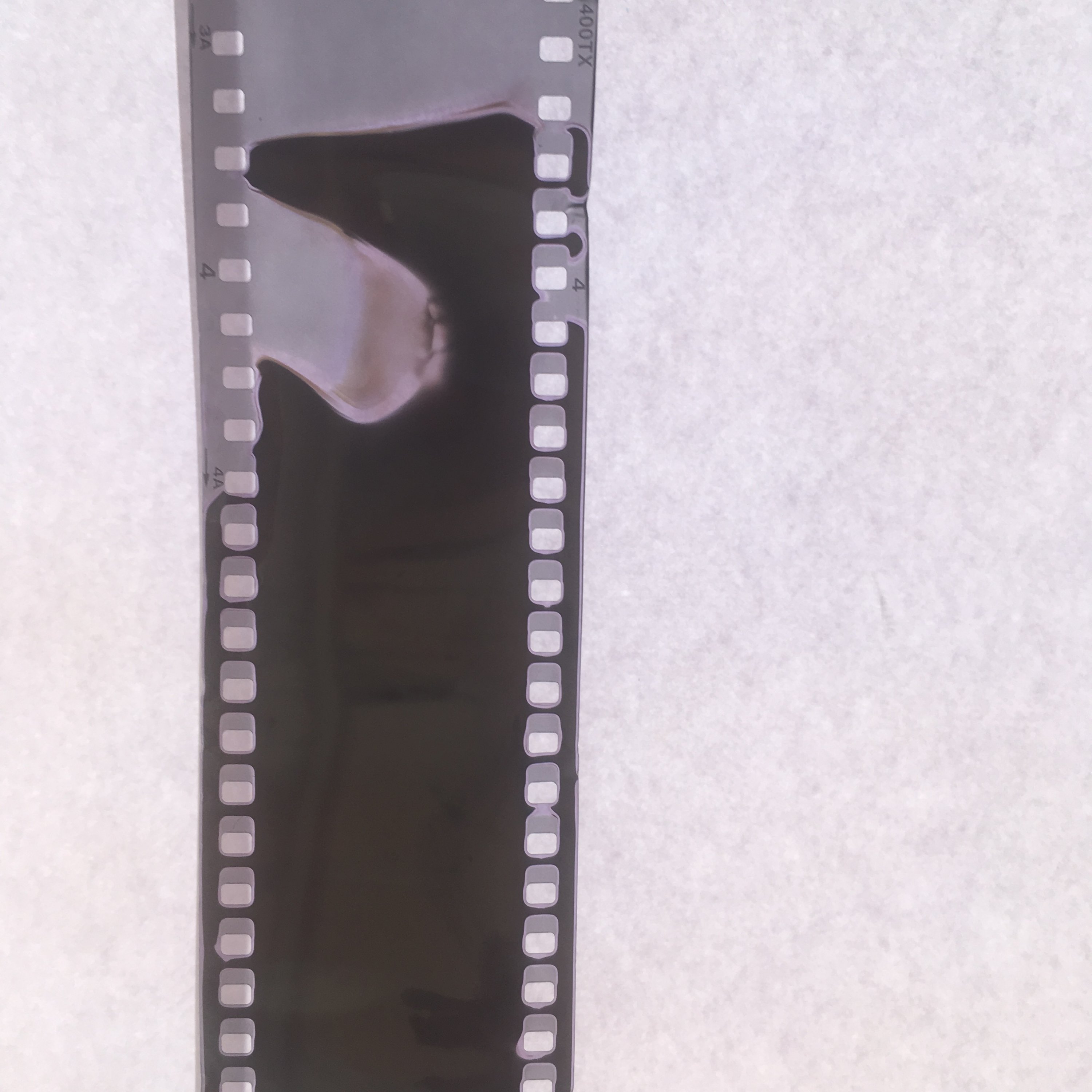

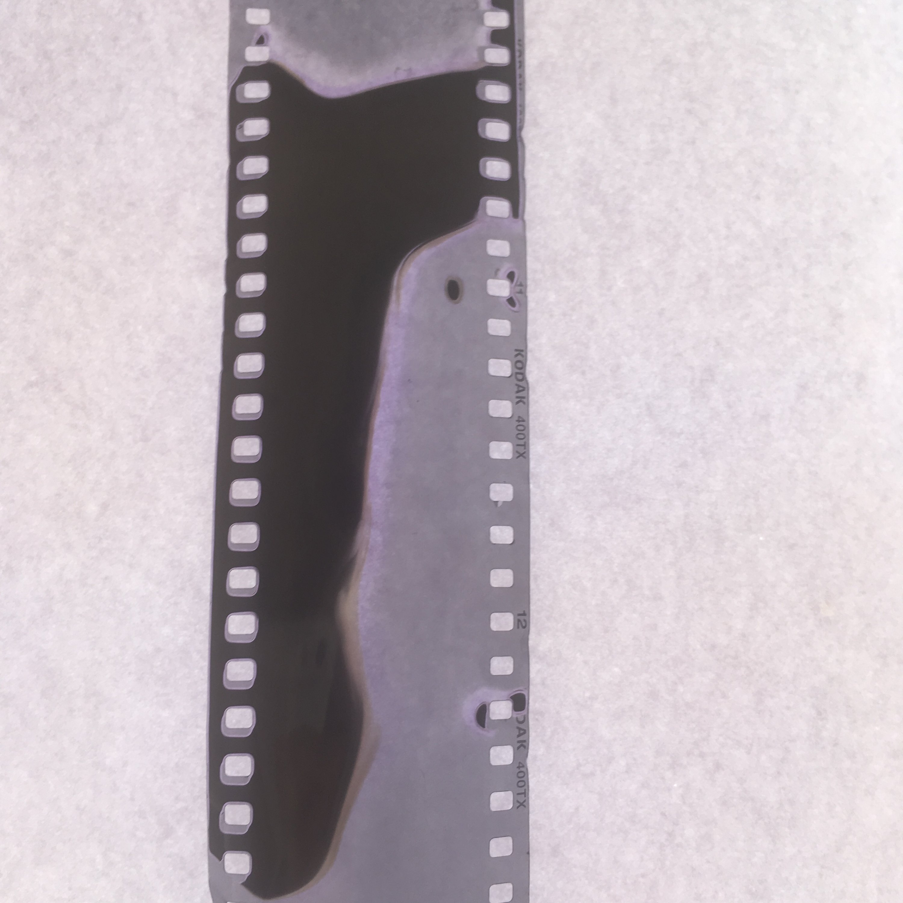

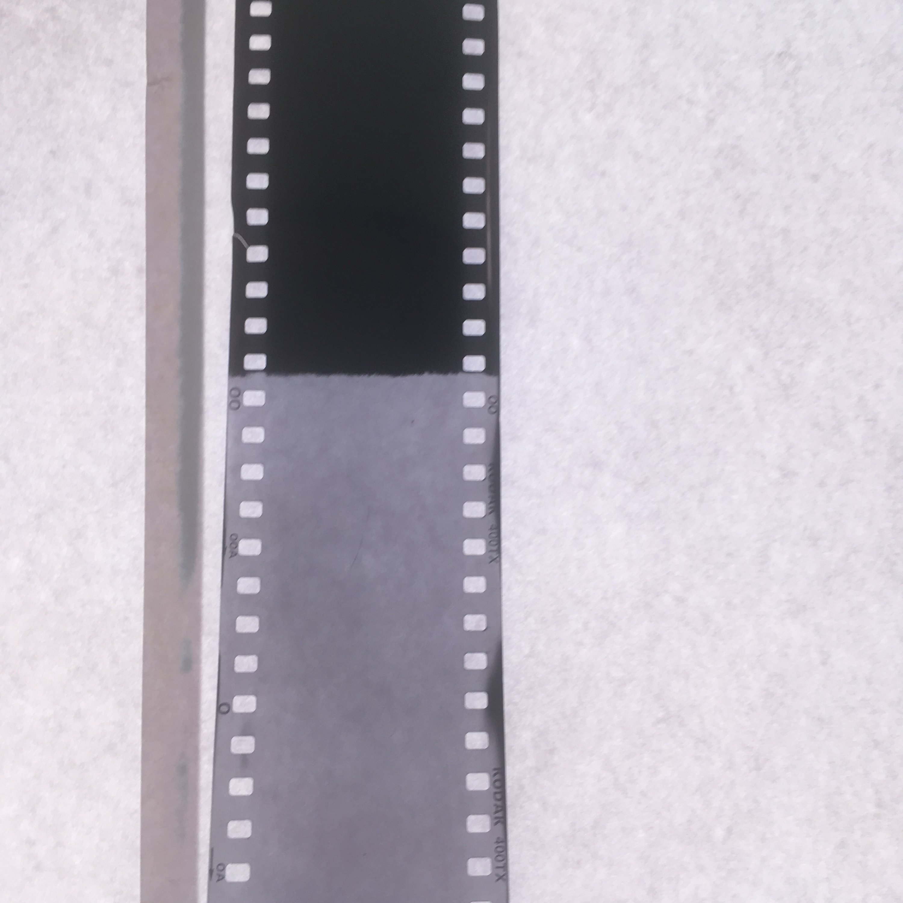

Sorry for the delay! I am posting photos of both rolls. This one here is from the first time around. The cause of the splotches are from improper feeding in the metal reel, and of which I should have practiced beforehand. Regardless, the negative is transparent for most other parts. Thanks for the help!

Sara valdez
Sara valdez
Sep 9, 2019
10
Cochabamba
Welcome to Photrio! That is a real puzzler!
The odds of that happening twice is pretty high, for sure. But let me get this straight; there is NO lettering or numbers on either of the clear rolls?
Thank you!
Yes I am a bit confused because, yes there is the Kodak 400TX label on the top as well as the numbers on the top and bottom.
