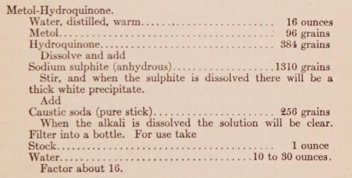

The formula listed here is an improved version posted by someone in this forum. He re-calculated the amount of developing agents and alkali. As a matter of fact, he found the original formula (the one listed on Digital Truth) had too much Hydroxide. IMHO, the benzotriazole in this formula was intended for paper dev in order to prevent it being too warm-toned and could be omitted for film.
Don_ih
Jan 24, 2021
8,135
Ontario
This was a rabbit hole.
Everywhere you look, there are variations of this formula. Some guy on Flickr cites references to numerous 125-year-old journals as the origin, but no direct links. When I search those journals, I find no such thing (fun looking, though). The oldest reference is Paul Anderson's Pictorial Photography in 1917, where it's unnamed.
No benzotriazole and the amounts convert to the amounts given at Digital Truth.
Anyway, my only concern was people trying to make a 1% solution of benzo in water. And in the other thread, it seems like benzo as a powder won't dissolve in the formula directly.
If benzo is to be used when this is diluted for paper use, it would be sensible to have a half-litre of 0.1% benzo in water to add at that time, rather than in the Kalogen stock. The reduced bromide is likely inconsequential with fresh film.
