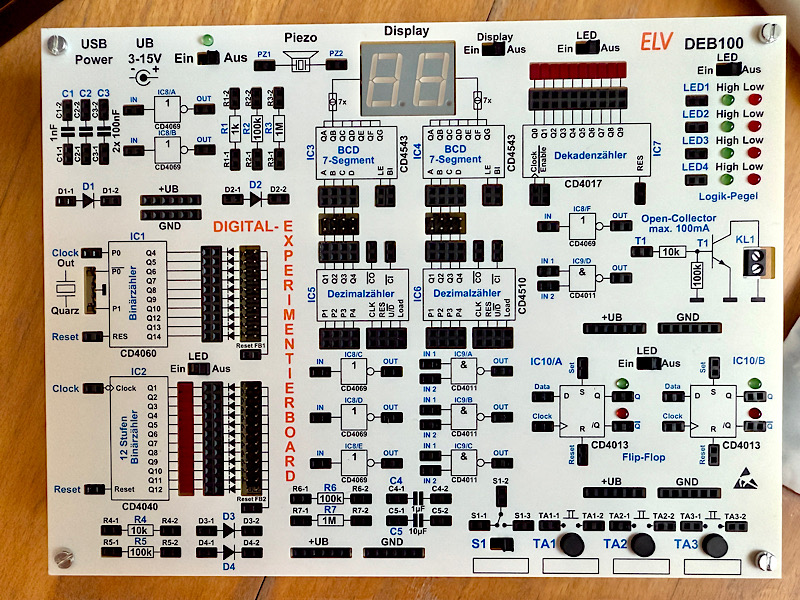

You don't need to understand the details of digital camera circuits, like those found in the Canon T90 or Minolta X-700. Neither as a user nor as a DIY repairer.
It's enough to say: "The electronics reside in the small black blocks on the circuit board. Conductor tracks and cables connect them to the camera components. The electronics either work or they don't. What happens in detail is irrelevant." It's the same with dishwashers and smartphones.
However, if you want to understand how digital circuits work
you have to familiarize yourself with the basics of digital electronics.
This seems technically and abstractly complicated, but it's surprisingly simple when you immerse yourself in the binary world, which consists only of 1 or 0, high or low, yes or no.
There are good books on the subject.
Practical exercises with digital components such as logic gates, flip-flops, or counters are somewhat confusing, as you have to make many connections on the breadboard.
This is where the ELV Digital Experiment Board DEB 100 where basic digital circuits are already pre-wired comes into play.
You only have to connect the individual components via connectors to build circuits. Numerous switches, display elements such as status LEDs and seven-segment displays are also available. A detailed accompanying manual introduces the topic.
This allows you to work through the fundamentals on which digital camera circuits also function.
The next step is to work with microcontrollers, which can be programmed and contain these basic circuits as virtual units in a single component. This also makes newer SLRS and DSLRs more understandable in their operation

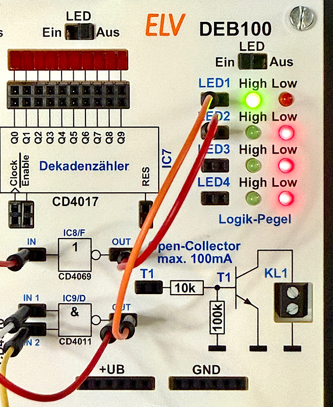

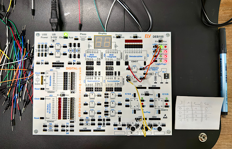

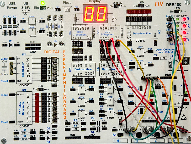

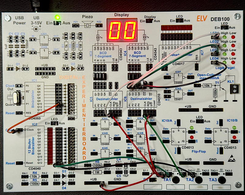

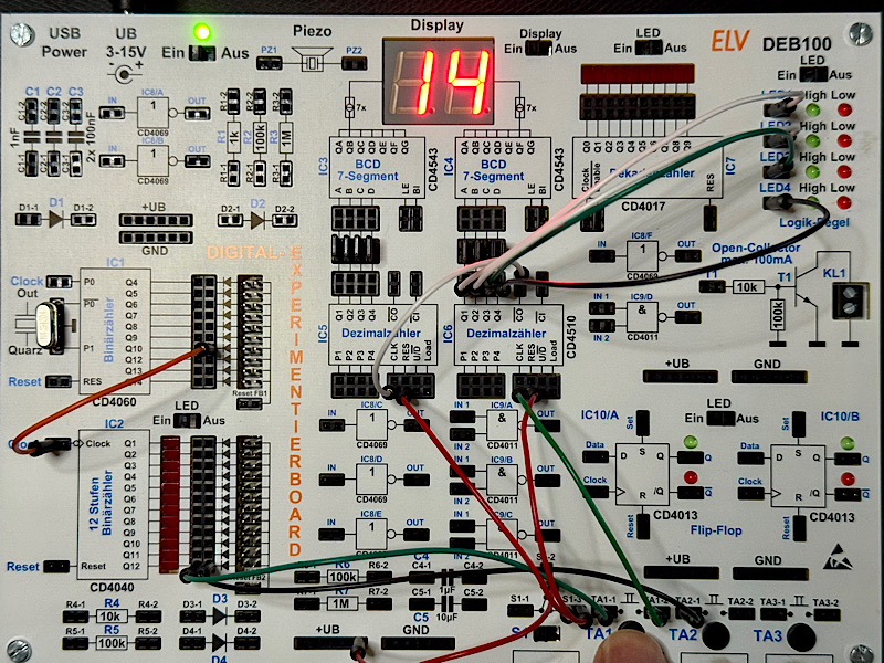

Today I put the digital experiment board into operation. I'm using it to review the content of the course I completed some time ago.
The supply voltage can be selected between 3 and 15 VDC, and a power supply can be connected via a socket plug. Alternatively, three AA batteries can be inserted into the holder on the bottom of the board for 4.5 VDC.
The individual digital components are connected to each other via cable bridges.
Here, I've connected the two inputs of a NAND gate (CD4011) to the operating voltage via two push buttons.
I've also connected the NAND gate's output to an inverter (NOT, CD4069), thus creating an AND gate.
Both outputs are connected to LEDs that indicate the respective levels HIGH or LOW.
With this arrangement, the function table for two inputs can be switched with a total of four possible combinations.
Here are the two combinations B = 0 (LOW), A = 0 and B = 1 (HIGH) and A = 1:
Both inputs (B, A) are LOW, the buttons are not pressed.
This results in the NAND output above being HIGH and the AND output being LOW.
Both inputs are HIGH (buttons pressed) so the NAND output is LOW and the AND output is HIGH.

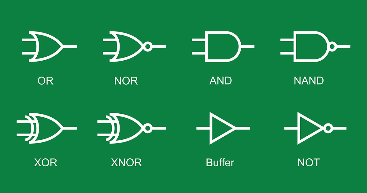

Logical circuits can be constructed using AND, OR, and NOT
This allows you to create the three logical gates AND, OR, and NOT using NAND gates and observe the individual switching combinations.
Since there are only four NAND gates on the board, additional inverters are provided for NOT. However, NOT can, of course, also be generated with NAND.

Digital display of numbers: BCD-to-Seven-Segment-Decoder
Displays for numbers can be found on many electronic devices, either as LCDs or LEDs.
How they work and how the numbers are formed is usually not something you ask yourself, as long as they display correctly.
The DEB100 experimental board has two such digital displays as LEDs, located at the top center.
If you look at a number more closely, you will see that it consists of seven individual bars that either light up or do not light up.
Here, the 0 is displayed twice, and for each six of the seven bars are lit. The seventh bar in the middle remains dark.
As a graphic it looks like this, with one more dot added.
Here you can see that each bar is assigned a letter (we ignore the dot).
In order for a number to be displayed, certain bars must light up together.
This way, all the numbers from 0 to 9 can be formed.

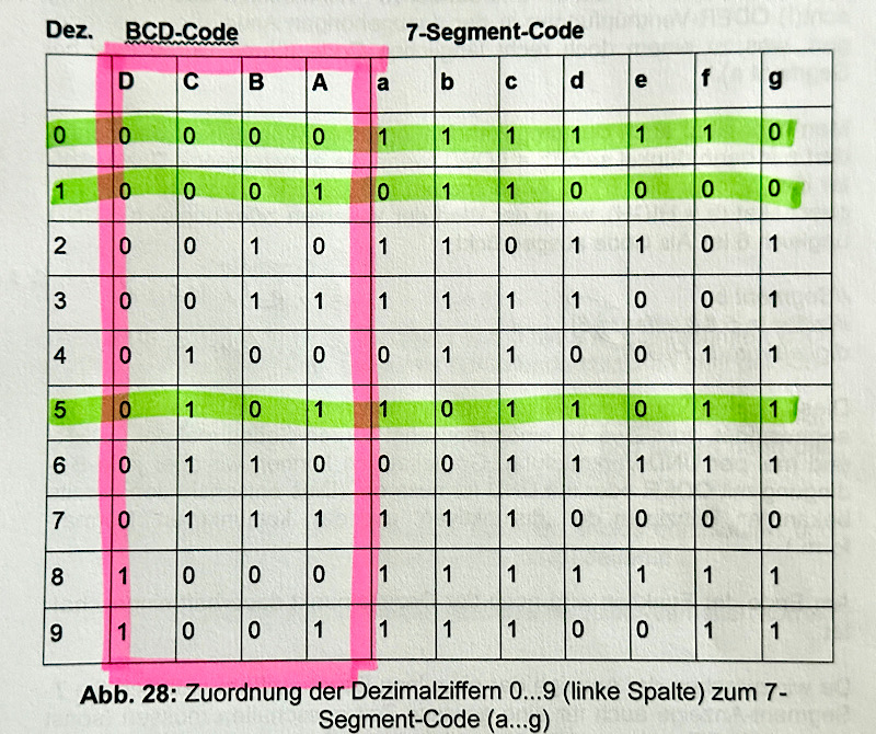

A digital circuit
is needed to generate these digits. This circuit works with binary numbers. This means that there are only 0 and 1.
Since we as humans mostly work with the decimal system, i.e. with ten digits instead of two, one system must be coded into the other.
see Jürgen Feldhoff, Digitaltechnik - Grundlagen der Digitalelektronik und Mikrocontrollertechnik, Lehrbrief 4.
This table shows the coding.
On the left, the decimal digits 0 to 9 are arranged vertically.
Next to each decimal digit, in the pink highlight frame, is a binary code consisting of 0 and 1, labeled with D, C, B and A.
For example
  • 0 decimal corresponds to 0000 in binary,
  • 1 decimal is written as 0001 in binary, or
  • 5 decimal is written as 0101 in binary.
We've now converted all the digits from decimal code to BCD (binary coded decimals).
A digital circuit can operate with these binary numbers.
Now the right-hand part of the table comes into play
You can see that for each decimal digit and its BCD code, there is another code: the 7-segment code from a to g.
To use our example from before, the 7-segment-code for decimal 0/BCD 0000 is 1111110. This means that for zero, bars a to f are lit, and g remains dark.
For decimal 1/BCD 0001 the 7-segment-code is 0110000.
And for decimal 5/BCD 0101 it is 1011011.
So the 7-segment code also works in binary with 0 and 1.
So all the information is available to control the digital LED display
In digital terms, this works via logic gates that use AND, OR, and NOT operations to assign the respective BCD codes to the 7-segment codes.
Fortunately, this complex digital circuit doesn't have to be assembled from individual parts; instead, it uses a BCD-to-seven-segment decoder, which simply needs to be connected.
The decoder as IC (integrated circuit) contains the complete digital circuit in miniature format and is included as a component in the DEB100 experimental board.

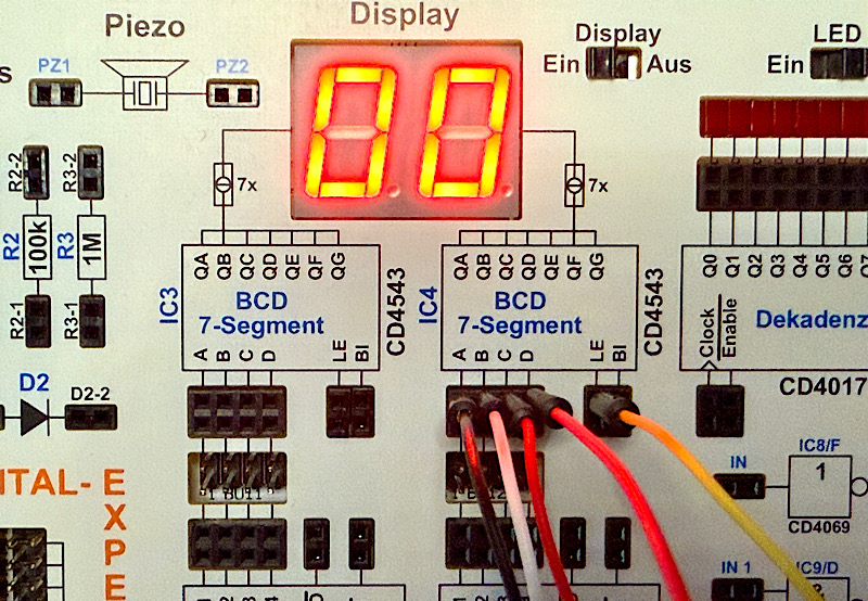

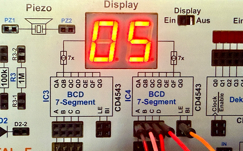

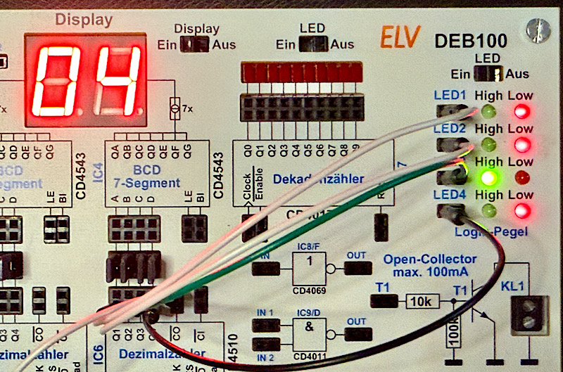

Display of the number 5 via the 7-segment decoder
The number 5 is displayed.
Below, on the right, you can see the decoder schematic.
Four cables are connected to the four BCD inputs A, B, C, and D.
Above, the seven outputs QA to QG for the LED bars are shown graphically, leading to the right-hand LED.

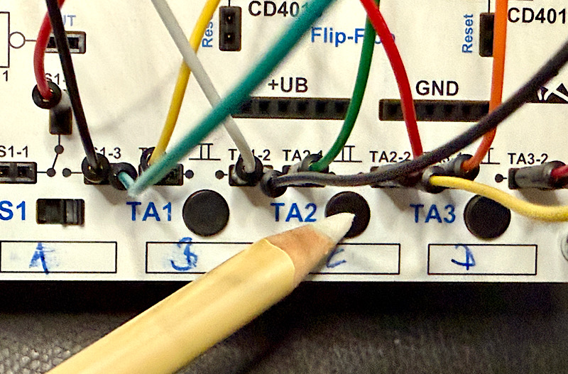

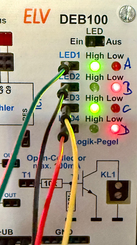

Using a slide switch and three buttons, the BCD code for decimal 5 is entered in binary form as 1010.
  • Switch closed/button pressed = 1,
  • switch open/button not pressed = 0.
For visual indication, switches and buttons are connected to four control LEDs that indicate the status of the input:
  • 1 = HIGH = GREEN
  • 0 = LOW = RED
The decoder now converts the four-digit BCD code into the 7-segment code and lights up the bars corresponding to the 5.

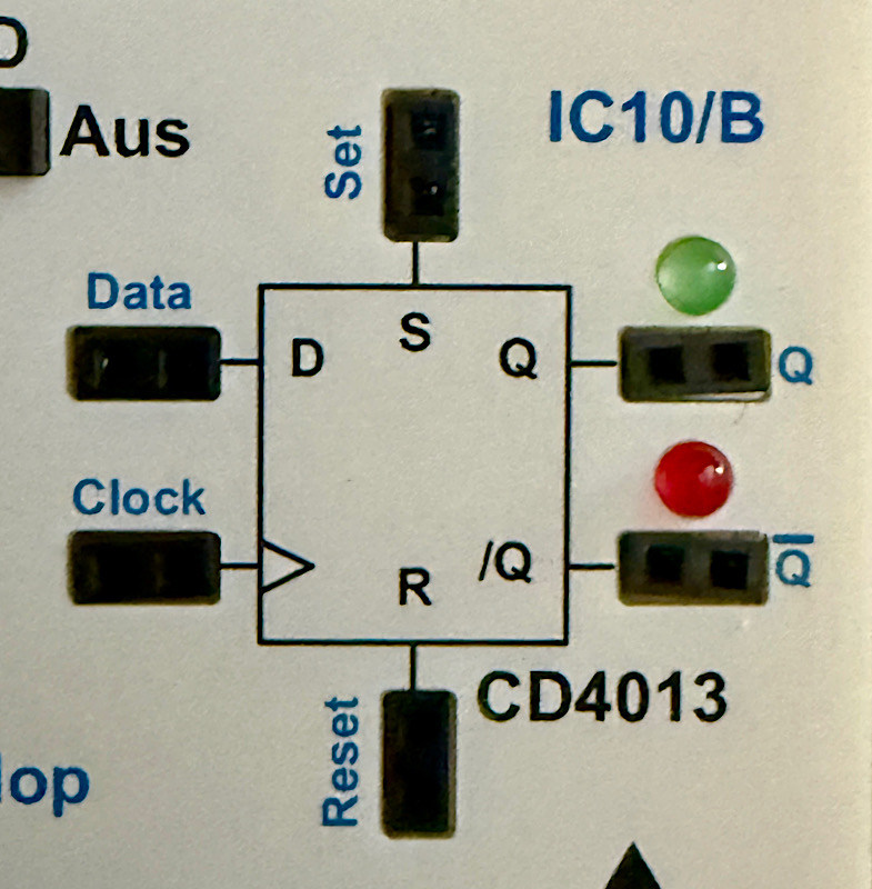

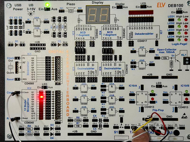

Flip-flop: a binary one bit memory
A flip-flop can assume two states: 0 or 1.
With one bit this makes it the smallest memory unit in a digital circuit.
One bit corresponds to 2^1 = 2 different states.
As long as the flip-flop is supplied with power, these states are retained until it is set back to 1 or reset to 0.
The DEB100 experimental board features a CD4013B CMOS dual D-type flip-flop. This provides two D-type flip-flops in one IC.
The schematic for one of them is shown here.
This flip-flop can be operated in two ways:
  1. statically, by setting the states 0 and 1 via RESET and SET, and
  2. dynamically via DATA and CLOCK; here the setting and resetting is done by a clock signal.

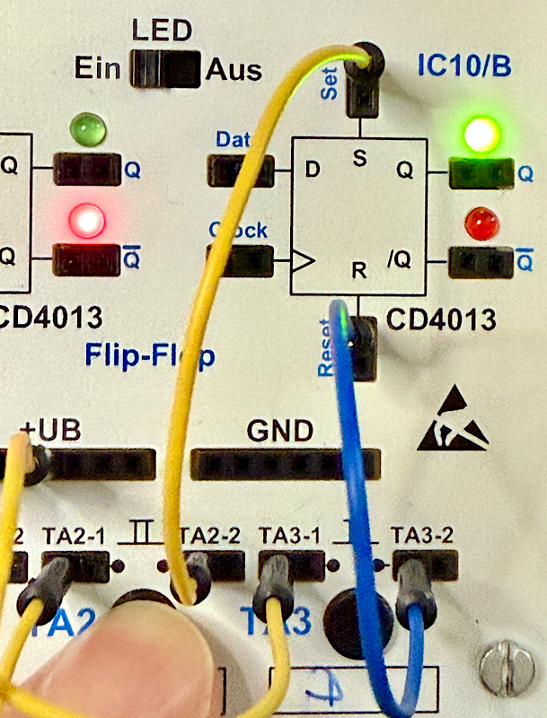

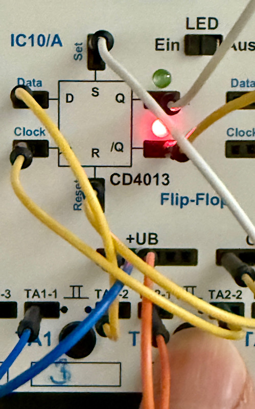

RESET/SET
The flip-flop is in state 0, it is reset.
This state is indicated by a red LED at the output /Q.

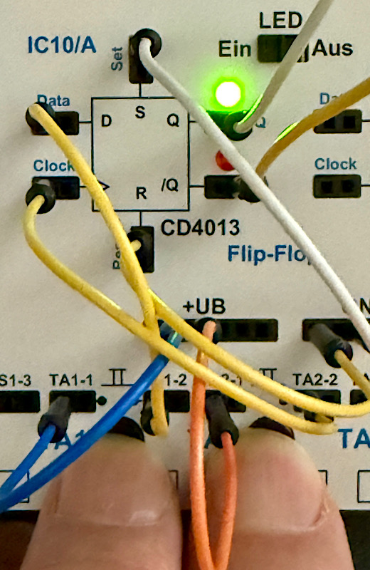

Using a button I set the state 1 via SET.
This state is indicated by a green LED at the output Q.
Via RESET I reset the flip-flop back to the state 0.
DATA/CLOCK
State 0
I set the flip-flop to state 1 via DATA and then activate CLOCK. Only then does the flip-flop switch to state 1.
For resetting to state 0 I activate CLOCK again. DATA is not activated.

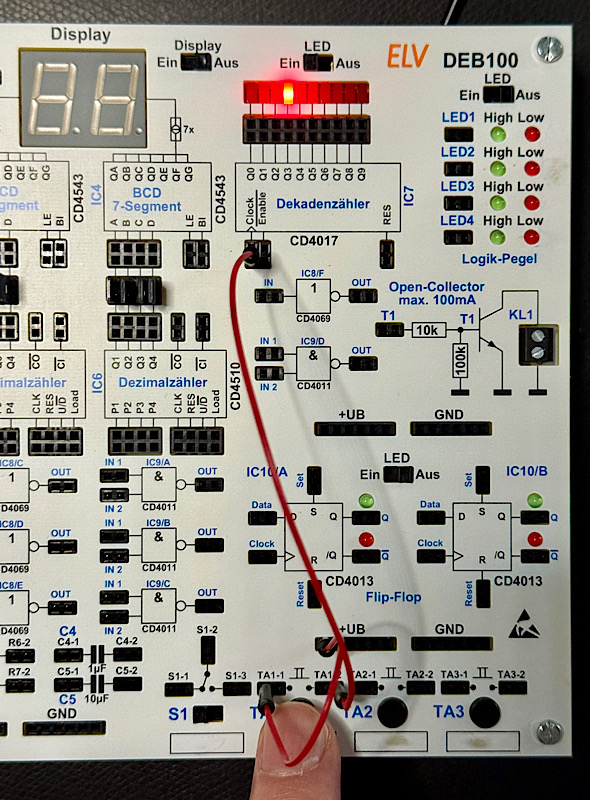

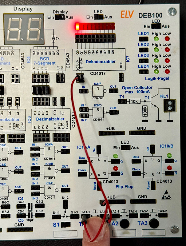

Using a clock signal as a regular square wave, the flip-flop can be switched at different frequencies.
This allows, among other things, the combination of individual flip-flops into counters and storage registers, which can then be controlled automatically.

Decade counter with 10 decoded outputs (CD4017)
The experimental board contains various digital counter ICs for performing counting operations.
As soon as a positive voltage pulse (HIGH) is received via the clock input, the counter advances to the next level. LEDs indicate the current counter reading.
The decade counter is the easiest to read; it outputs values in the familiar decimal system.
It starts at 1 and each press of a button moves it up one level.
Here the counter is at 4.
If you press the button when it is at 10, the counter starts again at 1.
Setting the RES (Reset) input to HIGH, the counter switches to 1 at any time.
The circuitry in the IC required for the function can be found in the datasheet.
12 stage binary counter (CD4040)
This binary counter also counts in increments. Unlike the decade counter, it displays its value in binary.
Here, after four key presses, the counter shows 000000001000, which corresponds to 4 in the decimal system.
  • Q1 stands for 2^0,
  • Q2 for 2^1,
  • Q3 for 2^2,
  • … and
  • Q12 for 2^11.
The red LEDs indicate whether the respective stage is active.
Here, it's only Q3 = 2^2, which corresponds to 4 in the decimal system.
Another key press sets the counter to 000000000101.
To convert to the decimal system, the powers of two are added accordingly in the place value:
2^2 + 2^0 => 4 + 1 = 5
Here the counter is set to 17 in the decimal system, so it shows 000000010001 in binary.
That is 2^4 + 2^0 = 17.

The BCD counter can be connected to a BCD-to-seven-segment decoder (see above in the thread) and a 7-segment display.
The current counter reading is then displayed as a digital number.
The counter could be set with a single button press.
To make things easier, I connected the two binary counters (we discussed the CD4040 earlier) to a quartz crystal and wired them to output a pulse with a frequency of 1 Hertz.
This increases the counter reading by 1 per second via the clock input as long as I hold the button down.
The respective BCD code can be additionally displayed via LEDs.
Here, 4 in the decimal system is correctly displayed as 0100 in the binary BCD code.
To display a two-digit digital number, the second 7-segment display on the DEB100 must be wired separately. The setup is the same as described.
However, the second display only advances when the first reaches 10.
The two 7-segment displays can show a counter reading of up to 99. At 100, the display starts again at 0.

Now you can experiment on the DEB100 and connect the individual components together.
For example, you could expand the 7-segment display with the decade counter and thus display numbers up to 1*10^9 + 99 = 1000000099 (I hope I calculated it correctly).
Or you can build logic circuits with the NAND and NOT gates that light up an LED when a certain counter value is reached. An electronic device could also be switched on via the open collector output, and so on.
