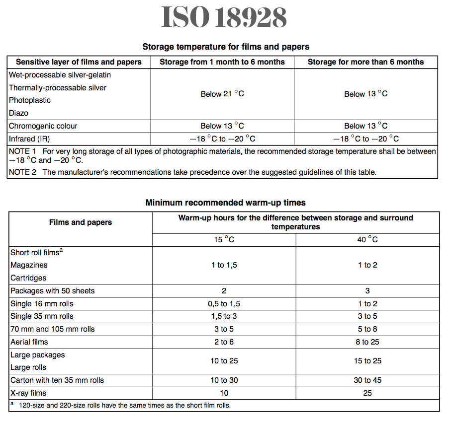

Zip lock freezer bags are good enough. The important part is that the RH when you put your films in the zip lock freezer bags should be between 40% to 60%.
Attached are some helpful tables from ISO 18928.

Let's say the temp difference between your freezer and room is 40°C (104 degrees Fahrenheit).
For such temp difference the ISO standard recommends a minimum of 3 to 5 hours for single 35mm roll and 30 to 45 hours for a box of 10 35mm rolls (check the table in my first post).
My experience is in agreement with the ISO standard.
While your films need only 20 minutes for optimal freezer to room temperature acclimatization.
