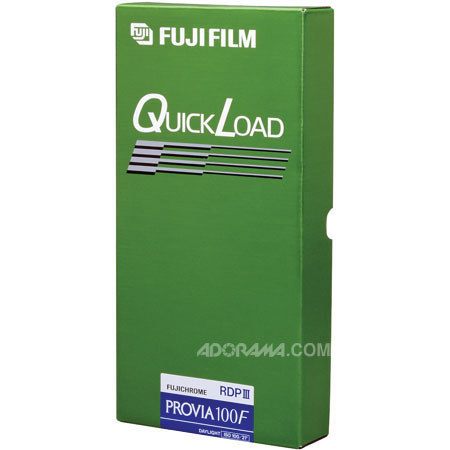

Re: the holders yes, the quick loads are in an opaque sheath and require a special holder. My understanding is that quickloads can also be used in a Polaroid 545 holder too, but I've never had occasion to test that.
DREW WILEY
Jul 14, 2011
13,879
8x10 Format
The 545 holder works better than the official ones, if you get a good one. They varied. They were just
a bit heavy due to the internal rollers, which could be removed. But ancient history by now, unless you're lucky enough to stumble on a cache of film sleeves.
