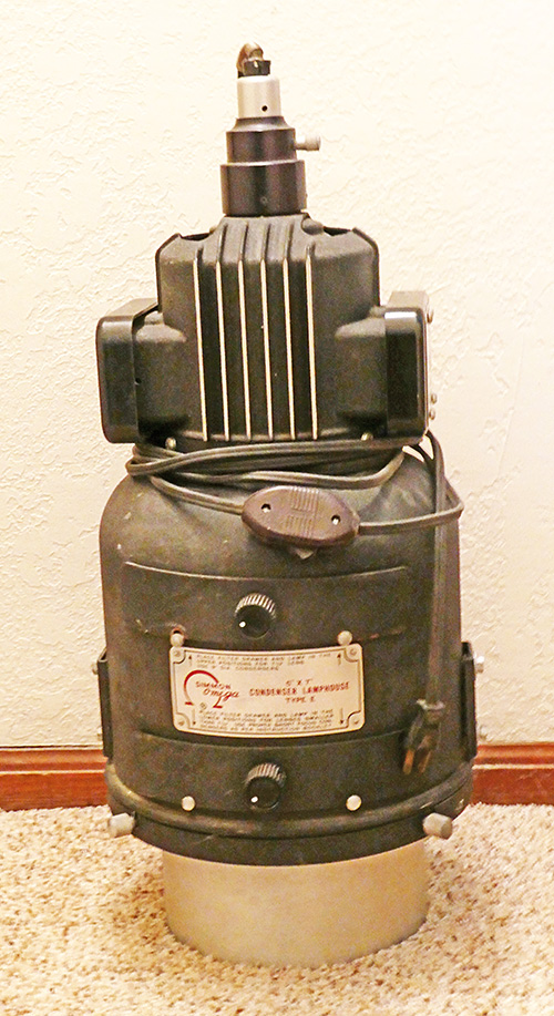

I picked up the majority of an Omega E3 enlarger from an estate sale a couple of weeks ago. It came with a pile of carriers (along with some that will fit my 45MX), etc., but no light source and no baseboard.
I know that here are at least a couple of folks on here that own them, could someone please tell me what the dimensions of the OEM baseboard are?

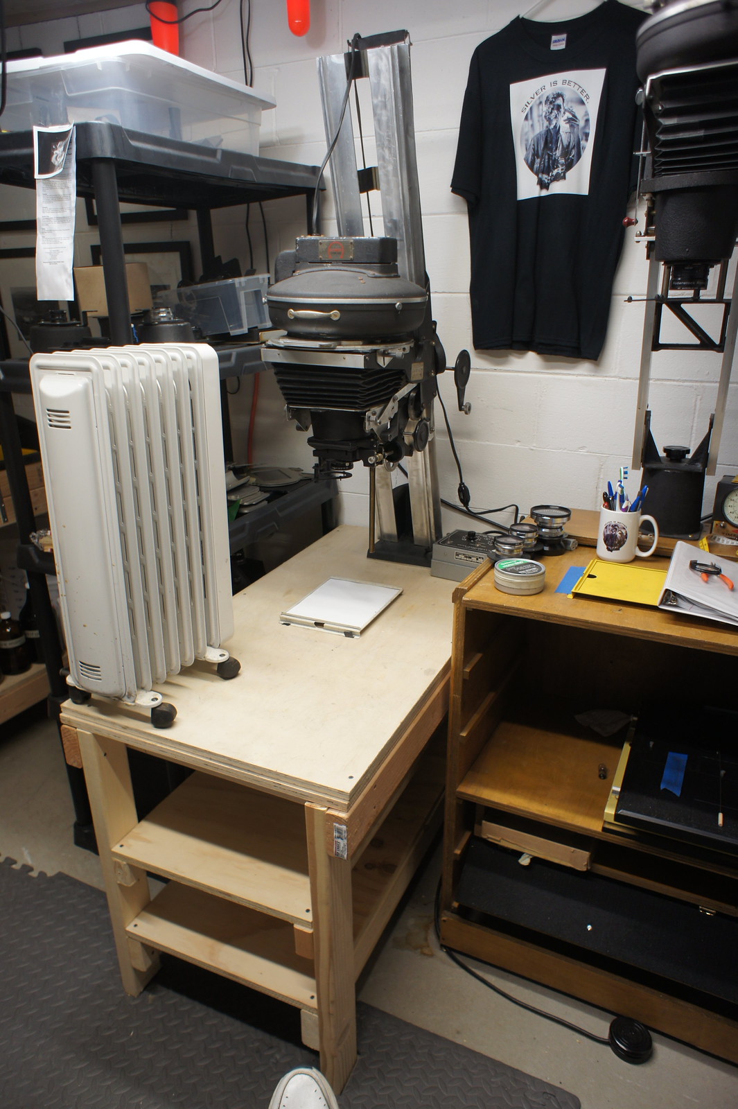

Thanks for all the information everyone. I was already considering just bolting the enlarger to the back edge of my workbench. I currently have it bolted to the front edge of one of my workbenches, for cleaning and painting some of the parts. I have a 30x72" maple-topped industrial workbench in the darkroom that it will sit on, so if I bolt it even with the back edge, that will give a clear space underneath it of 24x72" for printing. The original 5x7 lens on these was a 190mm, so I picked up a 190mm f4.5 Wollensak in good condition that fits into the threads of the enlarger cone for $32, I think. if it shows flaws, I can always pick up a 210mm Schneider at a later time.

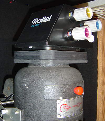

I have an E5 and its baseboard is 18x34. I modified the lamp source to take a Nikor 6x7 color head. Somehow I managed to end up with another 5x7 E lamphouse that is sitting on a 4x5 condenser can. Maybe I can attach a pic. There is a government tag on the condenser can and only the government would turn an E into a 4x5.
You may want to bolt the workbench to the wall and install a "wall brace" at the top of the column, that should help with any vibration issues.

Doremus, I can see why the old Chromega heads might prove a problem which is why I replaced just the tungsten light source on my 5x7 condenser head with the small Nikor/Rollei 6x7 dichroic head. Its diffusion plate is larger in surface area than the old tungsten bulb and works like a champ.
