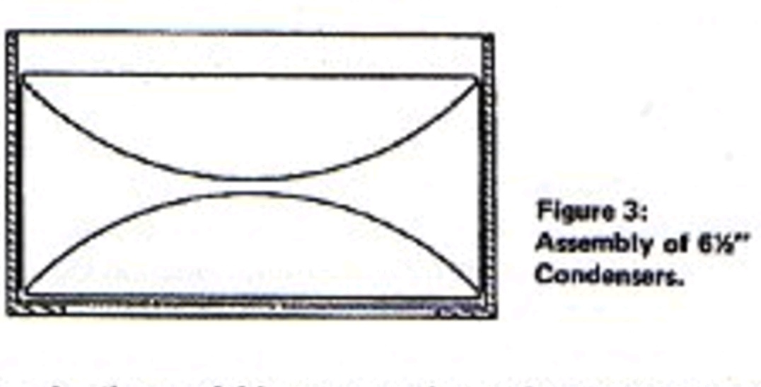

Of the two condenser lens present in the housing, one has more of a flatter, pancake shape compared to the other and has no edge roll when compared to the thicker lens which has an edge about 3/16ths thick. You know, one of these things ain't like the other and if I had a better way to measure the thicknesses of the two, I would... but alas, no. They are just different.
Anyway, and assuming the two lenses have been removed and replaced for cleaning about a gagillion times over the past eighty years, my question is, which one goes in first? I'm including the drawing from a service manual and maybe it's my eyes but the flatter lens looks to be on top, which is the exact opposite of the way it came out of the housing I own. The other thing that has me questioning this is the assembly instructions for the Dii refer to a lens 1 and a lens 2 in boxes.

I never heard they were anything but identical. I’d put the best one nearest the film (one of mine had a few bubbles and the other didn’t- so good side down.

Thanks, Bill. Personally, I'd not heard this either and the big concern being the overall collomated (sp?) position of the two lenses. That, I suppose, merely reducing what Newton rings might be forming and not much else. Mine, however, look to be different. I'm taking them into work today to measure the overall thickness and see if anyone else notices the spherical difference that my wife and I noticed. I came up with a plan for checking the light difference with the two lenses in different positions. Hopefully I won't see a difference.
