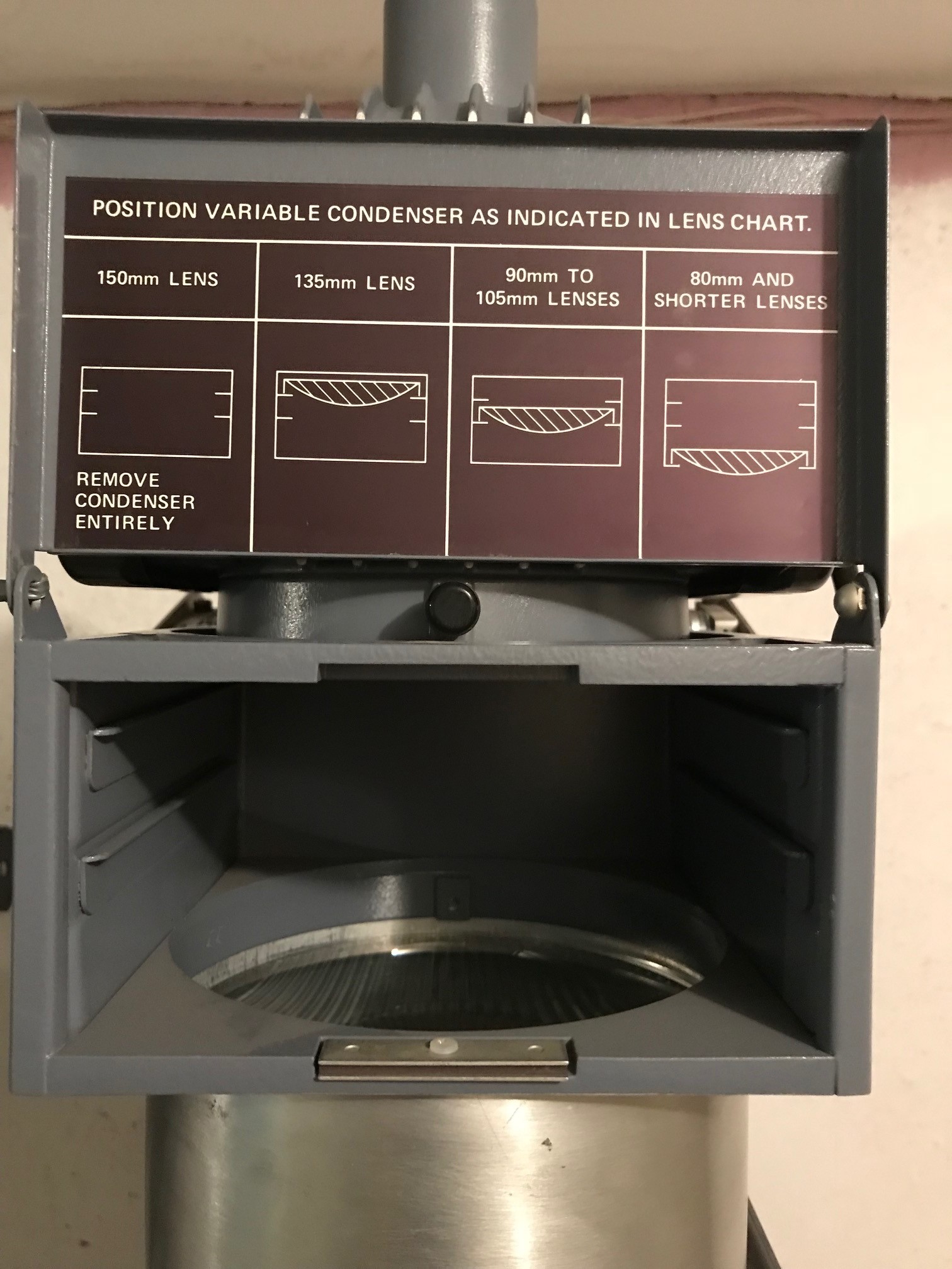

I just purchased an Omega D5 and would like some advice. I opened the door and saw this but I dont have any condenser lens on a tray. Am I supposed to have it? If I want to use a 135mm do I need it?

You can probably find one on e-bay, or check with the seller, see if he has it.
You probably need one with a 135mm enlarging lens (shortest lens normally appropriate for 4" x 5").
You almost certainly need one with a 105 mm, 90mm, 75-80mm or 50mm enlarging lenses (lenses appropriate for smaller formats).
If you can't locate one, let me know. I might possibly have one . If I can find it in my pile of treasures.
So I can’t get away with it with a 135mm. What would happen tho? I don’t have any lens so I’ll probably just get a 150.
I have one but I think it came from a D2 ? Looks good. Also have the 2 fixed condensers . You are welcome to it for shipping costs.
Your illumination will be less efficient but you will (probably) be fine. Much like using the old 6.5 inch condensers for all lenses. I, have one I picked up as a spare if you are interested but I would advise you try it out first.

I believe the condenser would only slightly decrease your exposure times by a few seconds. It's certainly not going to be a drastic change.
You would be likely to experience the difference with smaller formats but the advantage would be longer exposure times for
burning & dodging.

Unlike diffusion boxes in diffusion heads, the correlation between condenser position and lens focal length may actually matter when it comes to evenness of illumination.

Going bigger to smaller is usually less of a problem than going from smaller to bigger. Before the DV box both 135mm and 150mm lenses (and the occasional 165mm) all used the 6.5 inch condensers.

You need the variable condenser lens for 135 mm lens, not for a 150 mm. I have a spare set of condensers including the variable that goes in the slots. I'll sell them as a set, they are in perfect condition.
I do have a D2V, which has an indentical condensor setup, not sure if they are exchangeable, but they look pretty much the same. When printing 4x5 with a 135mm lens, I always remove the upper condensor with no ill effects. When you are only using the enlarger with the 135mm, you should give it a try first before investing in an extra condensor. At the other hand: it won't harm to contact the seller and ask him if he still has the thing lying around somewhere, as it should come withthe third condensor in the first place.
Pretty sure any Omega Variable Condenser head parts are interchangeable between older and newer model chassis.
