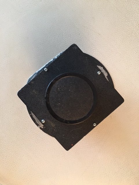

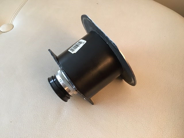

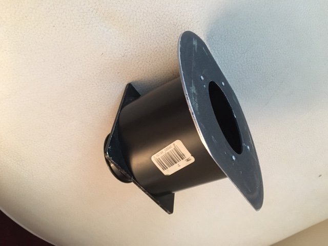

I extended the lens board of my D2 using a 4" piece of ABS sewer pipe. Actually it was a fitting used to join two pices together. I use it for my 162 mm lens. I use it for 4x5 and 6x7 work.
You have to spend some time filing the piece so both ends makes two parallel surfaces. It was actually easy to do.
I drilled small holes in the edges of the pipe to hold #2 high low screws. I think #2 sheet metal screws will work too.

Did you ever post a picture of the adapter you made with ABS?

I did not. I will take a photo and post it.
Finally found it.
