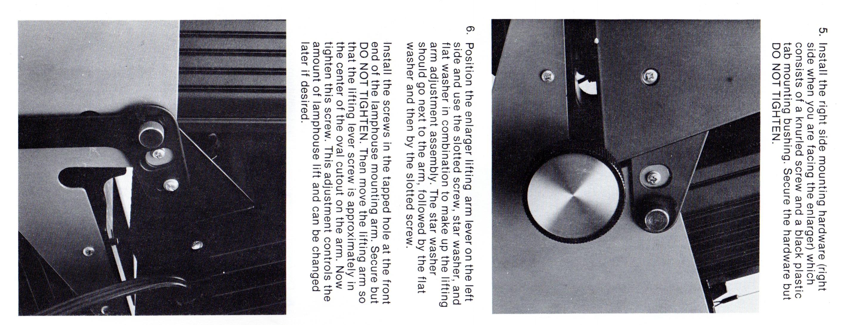

Using different brackets the C760 lamphouse can fit several Omega enlargers. Most have no other model number on them. The only thumb screw I can see in the manual looks like this:
That is for a B66 or B22 enlarger. Which is one I don't have, at least I don't think so. If that's the one let us know, maybe someone will have one.
Most likely many of the other screws are the same thread. The instructions also mention a black tab bushing.

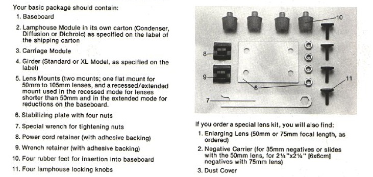

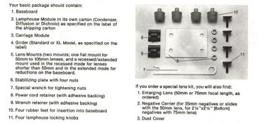

I have the manuals - the thumb screws are #11 -
I can't find any screw that will thread into the holes. Maybe they're metric. I have a lot of screws in my junk box, but none will fit.
Picture helped. They are 10-32 nylon thumb screws. The threaded portion is 3/4" long. The ones I have look a little different then the manual, the head is smaller in diameter and thicker but they came from the same place on the bracket.

Thanks. The 10-32 screws worked.
