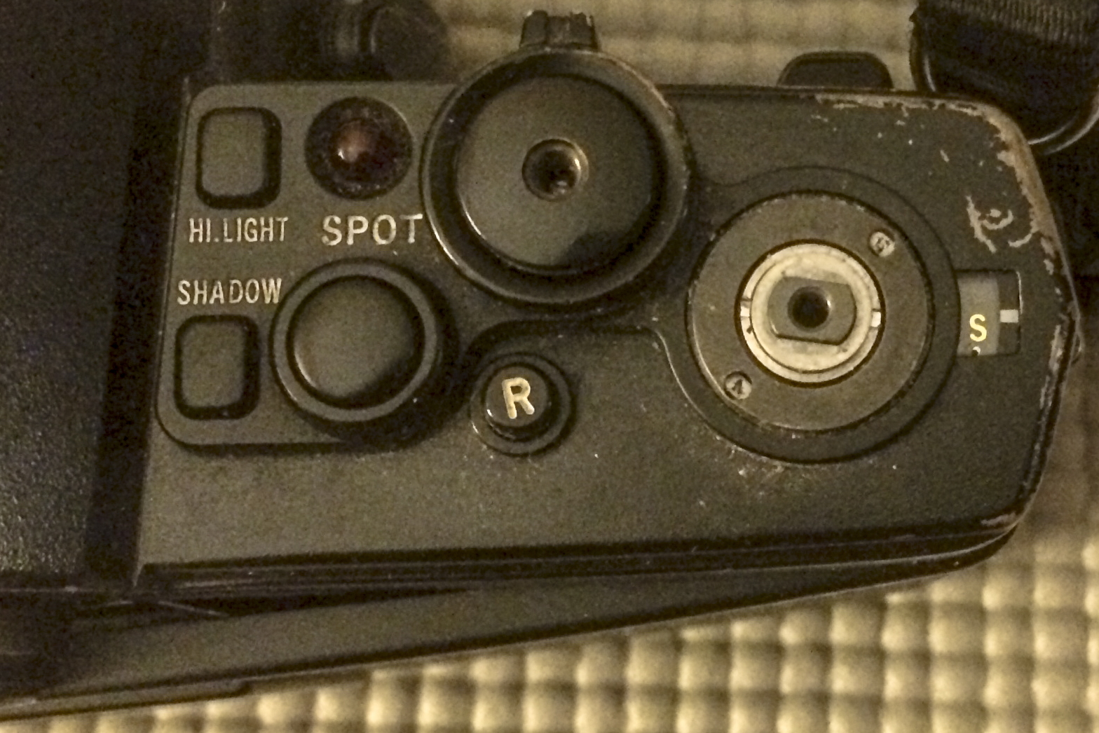

So I dropped my black om4t and it landed on the film rewind crank, and broke off the flip out handle, which is not a big deal and can be swapped out easily. But what is a bigger deal is that it broke the film door release mechanism. I popped the bottom plate off and the side leatherette and and saw that the release and spring still works, and the door still locks shut fine, but the linkage between pulling up on the film rewind lever and the door lock is broken. Now I am having a problem with the removal of the top plate to get under that section to see whats up.
I removed everything in the service manual, except a retaining ring under the wind lever. I am not sure what section to take off. The black outer ring has two larger holes that had a ball bearing in each. Within that larger ring, is a center ring, that also has two indentations for a spanner. Neither budge. In the exploded diagram both seem to come off, but I am totally baffled and I marred the larger black ring too trying to really crank it which sucks. Not sure what to do now.
Any help is appreciated.

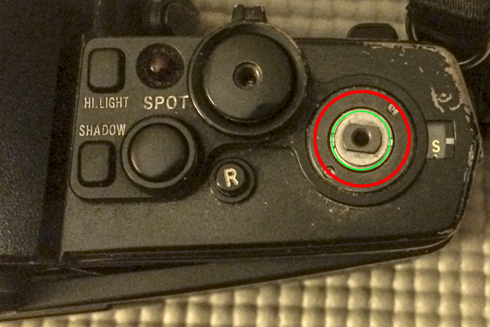

edit: ive attached an image of where im stuck, Ive tried removing both that are outlined in red in green, and both do not budge.

Yes I am actually working off of those exploded diagrams and the top plate removal order from section C of that manual. I have it printed out in front of me, but I am asking as I have hit a road block and was hoping someone has a solution. If I really can't get it off, I may just rig up something to pull on the latch lock from the left side under the leatherette as an ugly fix.
The OM4 pdf4 section H shows a special wrench for the wind lever nut CE564800 with a note that it does not work on the early production models.
The OM4Ti supplement pdf page 37 may be of help also.

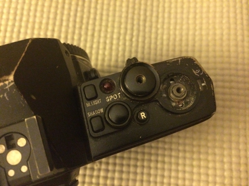

If it will not budge with a narrow tip spanner then put a small amount of acetone (standard nail polish remover) between CED564900, pdf 1 page 6, and shaft CE5222000 pdf 1 page 9 to loosen the thread locker/thread glue.
This spanner http://www.ebay.com/itm/Profession-...202?pt=LH_DefaultDomain_0&hash=item3ce4fad3b2 with the center pair of tips should be perfect for this nut.
Further down the OM repair manual site is a tutorial on removing top cover lever from a OM1/OM2. It shows the nut in question to simply unscrew with a spanner.
I recently used the nail polish remover on a Cambo Legend standard guide set screws that had some sort of glue/thread locker that prevented them from moving. The head would strip off without the screw turning and the screws turned easily a couple minutes after applying the acetone. Use Sparingly!

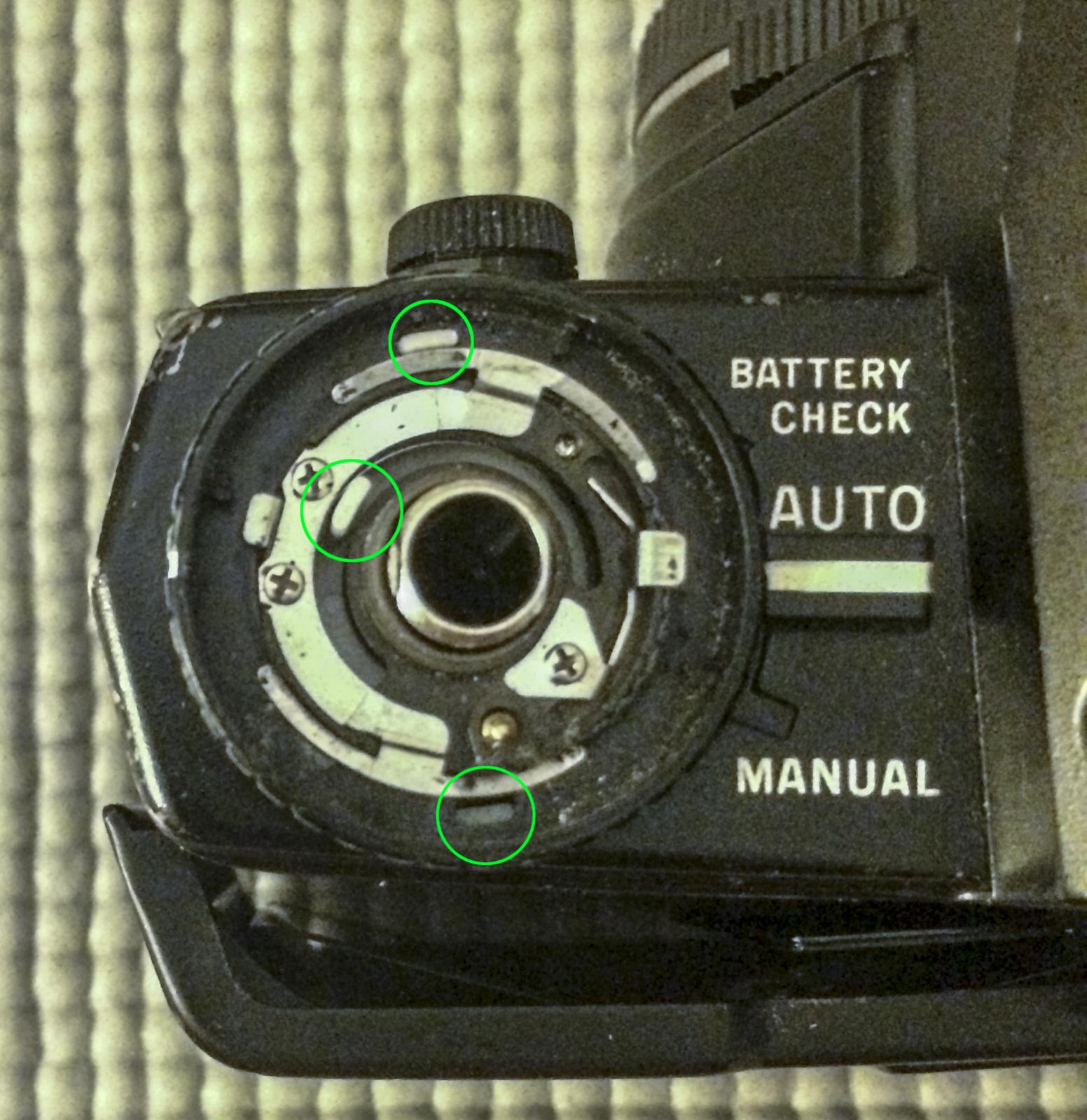

Ok finally its fixed, note, dont repair cameras late at night and when your wired only on caffeine... The write up follows below for whoever may need help with this in the future.
Part CE564800 was the retaining ring that needed to be removed, which I outlined before in green. I dont know why I was trying to remove part CE564500 with the spanner, it was a brain fart, as the holes for the bearings looked like it would fit a spanner. Doh...
I followed shutterfingers's advice and used a bit a solvent, I used naphtha instead as I was weary of acetone coming into contact with the circuits and plastic board under the cover. Just a squirt around the gap outside that lever nut and I let it sit a bit, and with a spanner it loosened up. Finally the top could be removed as I had everything else off.

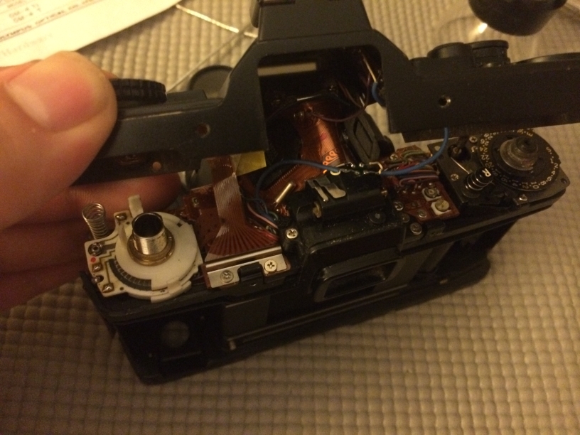

With the top off you have to be very gentle as its connected to a circuit ribbon and two other wires. But with it all turned slightly, it was enough space for me to diagnose what was up with the film door latch release.
The rewind column, part CE596700 has a small flange/collar at the base, when lifted that flange contacts part CE565400, a circular collar that is supposed to connect with part ZC452000 the locking door latch. What keeps it all locked down with pressure is spring part number CE557200.
So when the camera dropped, it jarred part ZC452000 out so that it was resting below part CE565400, so when you pulled up on the rewind column (part CS596700) there was nothing to catch to pull up the door lock (part ZC452000).
So the correct order is ZC452000, which rests on CE565400, which is ultimately pulled up by CS596700 which opens the door. I had to peel back the leatherette to get access to part CE558000 which actually keeps the door lock in place so I could take it out and rearrange it. note: there are two tiny washers (under CE558000) part CA871900, make sure you dont lose them.

Make note of your filmspeed, and zero out your exposure compensation before removing dials, as you have to align 3 white plastic prongs Part CE596100 through the top plate when closing it all up. This was a headache, just getting everything in line so the top could slide down and the dials function. the exacto knife helped with final positioning.

4.jpg Those green circles indicate the plastic prongs that you have to align and thread through the top place when reassembling the camera. My bottom prong seems to have broken off slightly but doesnt affect the camera, I never found the broken off part in the camera housing.

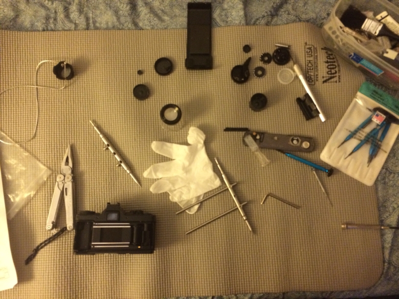

5.jpg you can see the rewind button and spring just sits in a wobbly state, when you depress it, it sits flatter and is easier to reassemble.
I was working on a soft padded mat, its designed for instrument and gun cleaning, and helps keep everything visible and stuff like bearings from bouncing around. each section of parts that was disassembled went into its own holding cup.
