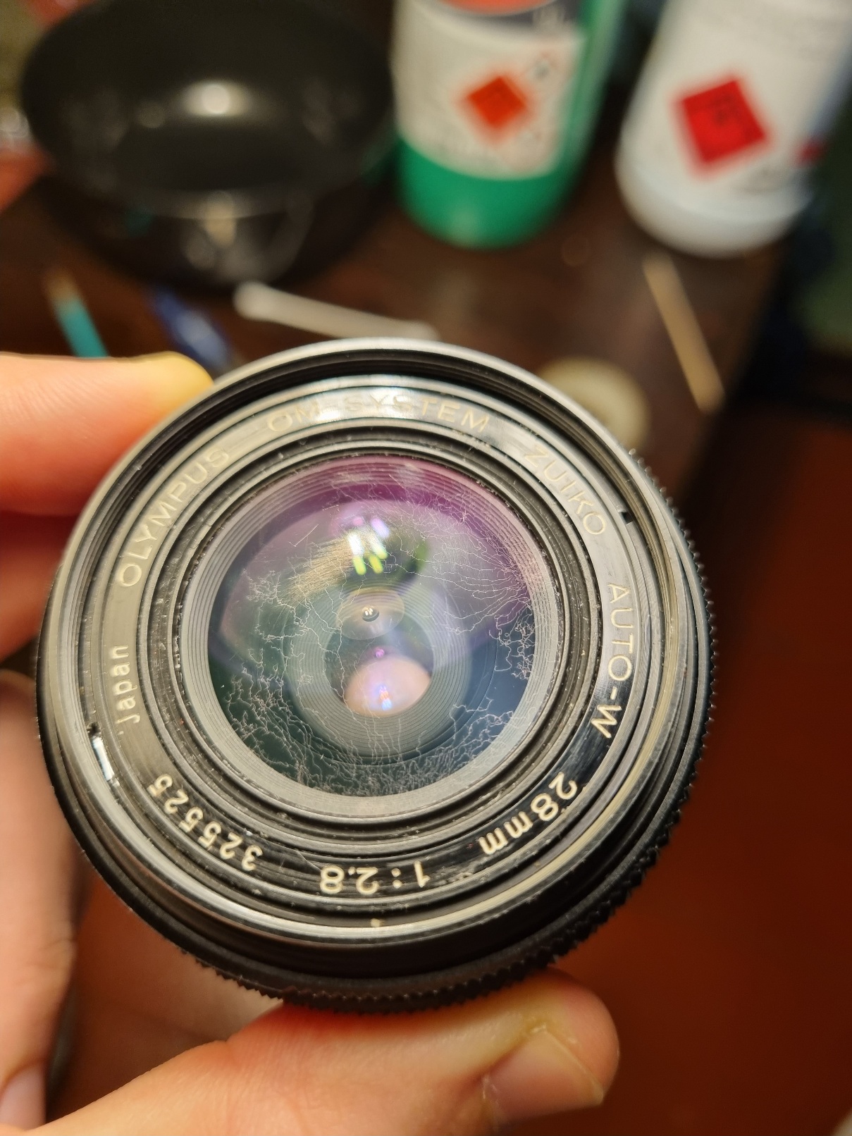

It feels like glued, also other screws from rear element were quite strong... The lens front element has some small fungus I want to clean, but it seems impossible to open. I have open an 50mm 1.8 zuiko with 0 problems.
I have tried letting isopropylic a few minutes, but no luck. Should I try acetone or there are plastic elements behind?
The lens has some fungus and the aperture mechanismus reopened very slowly, some oil from the helicoide got into the mount mecanismus, but thats already cleaned and working.

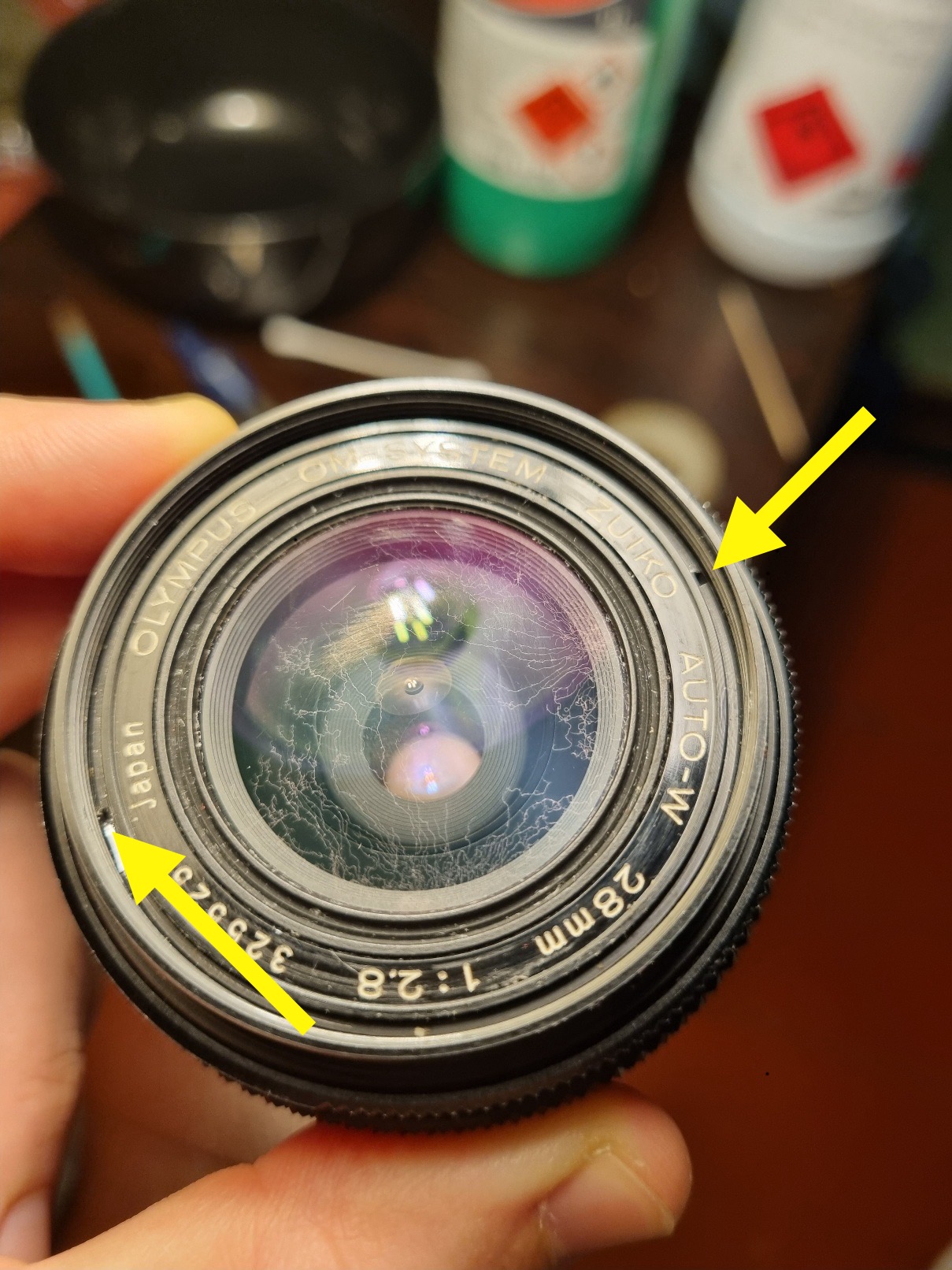

yes, here you have. I can't unscrew the name ring. The part with fungus is the very first optical element.

If the ring is stuck, you can try applying WD-40 to the threads. Let it take effect for a while and then try with the spanner wrench again. But be careful so that it doesn't slip. I don't think the ring is glued.

The fungus is fully developed. I'm afraid the glass will already be etched. But a cleaning will show it.
is actually very hard to see, there ive found the perfect angle to show it with the light reflecting. But is my first time cleaning some fungus so I can not tell by experience. I'll keep you updated. Thank you!

Oh, about the structure of the lens, there are the schematic of the lens on the internet and also other zuiko are build the same way. The name ring screw inside the filter screw, so I know fornsure how should unscrew, is just that it doesn't move at all, feels glued.

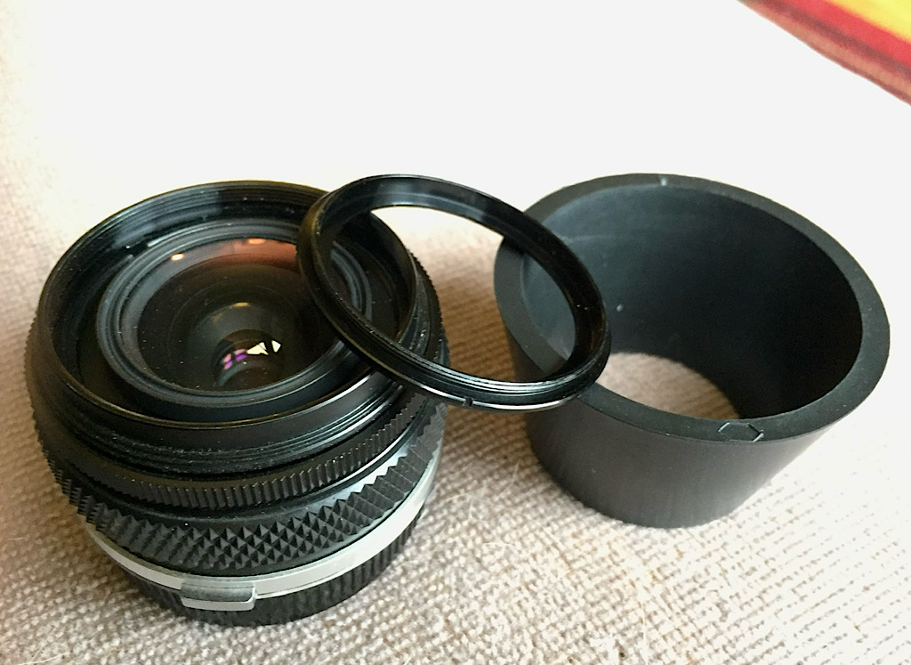

It "should" just unscrew with a rubber cone friction tool - at least mine did (pictures are of my Zuiko 28mm f2.8 s/n 308113)

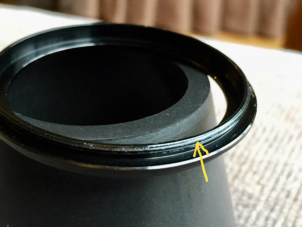

Whilst the beauty ring is metal, the shape makes it difficult to apply either WD40 or acetone in such a way that it can get to the threads (yellow arrows) between the lens body and the ring. The threads on the lens body indicated by the green arrow are the 49mm filter threads.
The picture above shows the back side of the beauty ring.
