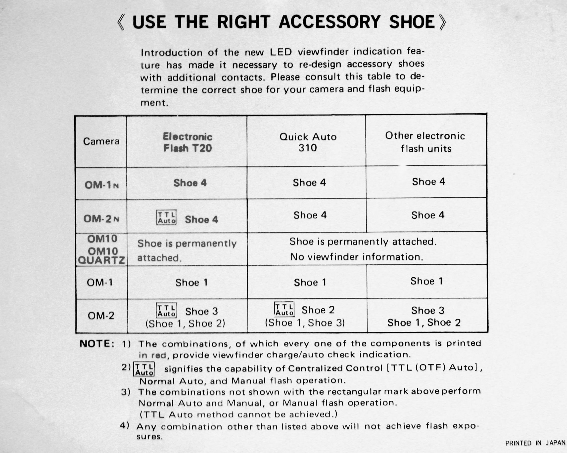

Here is a handy guide for which hot shoe goes where. Olympus was a bit confusing on this issue due the the changes in technology. Hope this informs. - David Lyga

Thank you David.
It isn't much of a confusion anyway:
OM-1, -1MD: Shoe 1
OM-2: Shoe 2
Now the confusion in some is when Olympus introduced the -1N and -2N improved versions and new T-series flashes, they came up with a new shoe with an added pin for the auto-check lamp in the viewfinder.
OM-2 with T flash: Shoe 3
OM-1N and OM-2N: Shoe 4
All the other cameras have the equivalent to a shoe 4 integrated in the body.
The OM-2SP, -4 and the OM40 have the same shoe 4.
The OM-3TI and -4TI have an improved shoe 4 with 2 extra pins for the FP flash function only available with the F280 flash.
The OM-10, -20, -30 and -3 don't have TTL flash, so they miss one pin on the shoe.
Unfortunately they are not so reliable and can break very easily. 'The weakest point in OM-1 series at-least'.
One other note - for generic flashes, the OM hotshoe linkage can vary. I have a semi-defective OM-1. If I use a flash with a high trigger voltage on it, it works fine, but if I try and use a Sunpak 383 Super, it won't fire at all. Same flash works fine on another Om-1 body.
Anyone needing appropriate OM hot shoes, PM me as I have some surplus. Not free but reasonable. As always donation to APUG. Bill Barber
