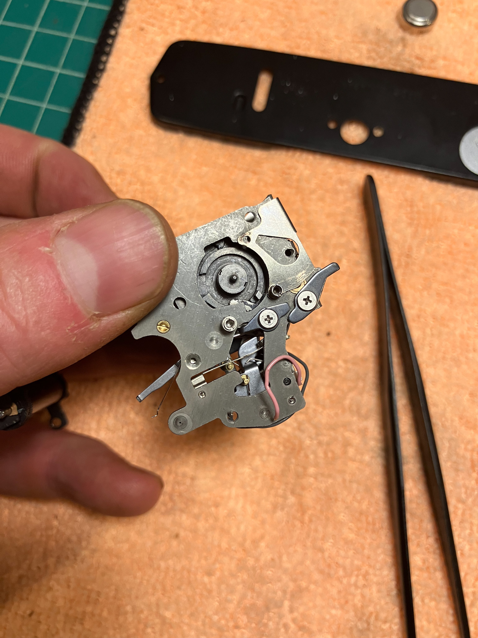

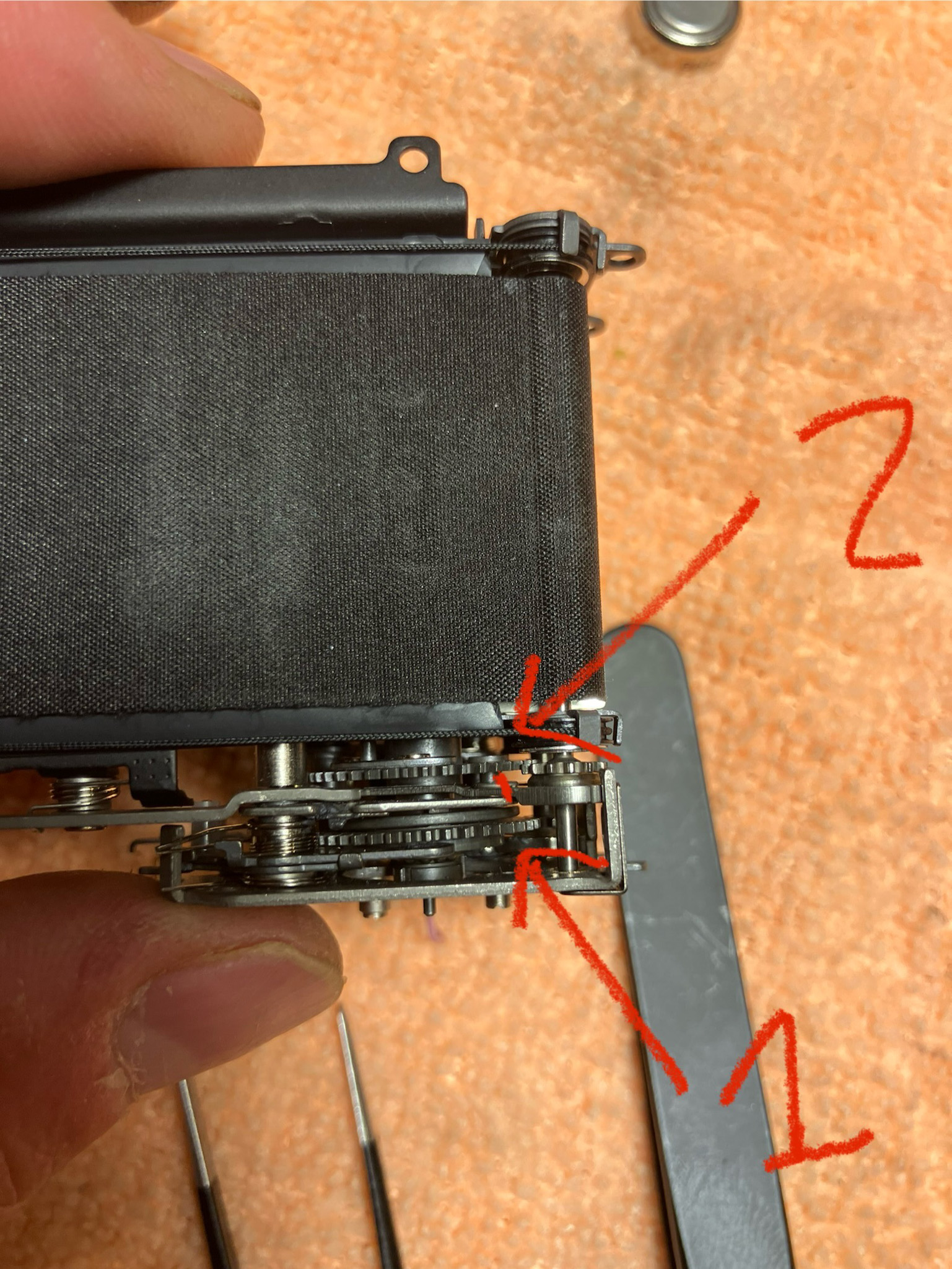

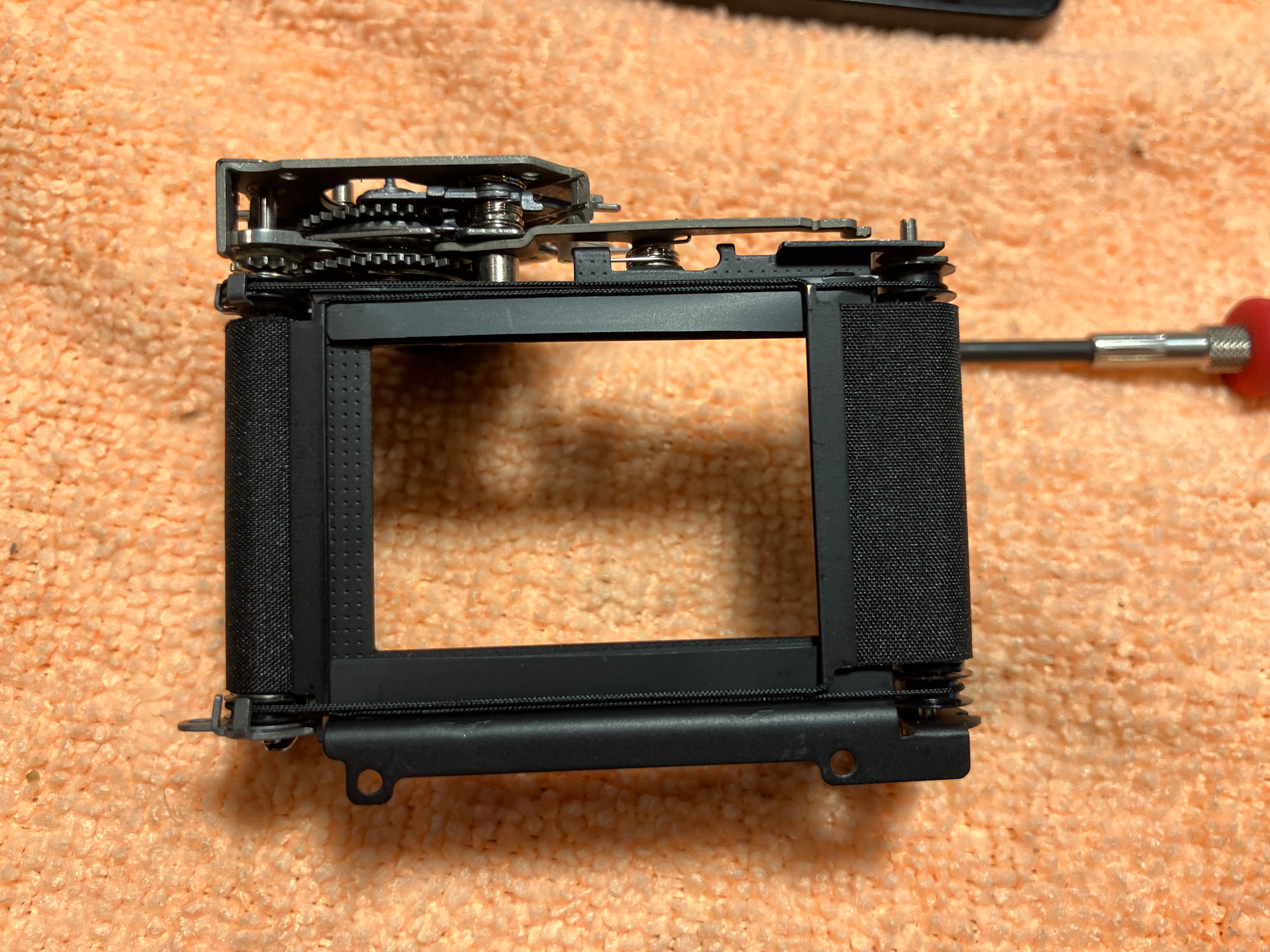

Great timing! I’ve gone… deeper.
With the shutter out I’m able to see that, something is out of whack! As far as I know with the OM shutters the way it should work is that there’s this cam at the bottom that charges the shutter.
When this is turned it’s connected to a gear that charges the 2nd curtain. It has a little point that pushes on a second gear that charges the 1st shutter.
With this shutter, the first curtain is never charged. It’s like the pin or gears are out of place.
I might actually know what to do (thanks OM-1 Service Manual).
I think that if I charge curtain 2, locking it in place, I can disengage the curtain rod from the gear. Then reset the gear back to alignment with curtain 1’s gear. Reengage curtain 2s curtain rod and done?
Hey thought I would update, I did exactly above, and while extremely fiddly and the curtains wanted to come out when replacing the shutter block and it took many tries, it worked!
